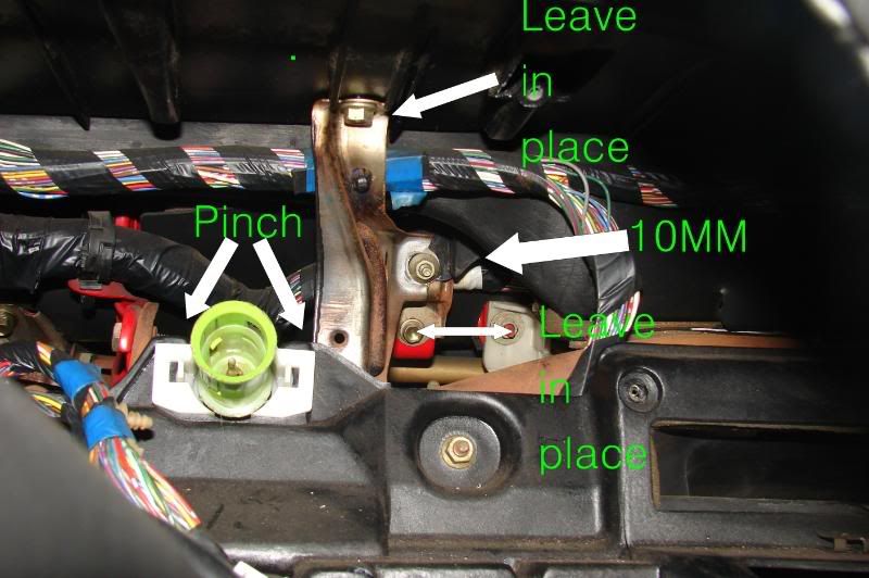

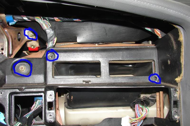

I took pictures last time I did it, and I have never taken the time to put together the article I planned to do. Once all of the parts 92 Teal mentioned are out of the way, it is pretty easy. There are plenty of bolts under there that you do not need to remove. You only need to take 6-8 bolts or nuts out to get it loose. Once they are out, you still have to sometimes break the dash loose from where it has been for years.
Here are some of the pics I took:
This is behind where the A/C controls are. The two circled holes on the right had phillips head screws in them to take out. The other two circled need to come out, and will also be seen in the next picture as well.

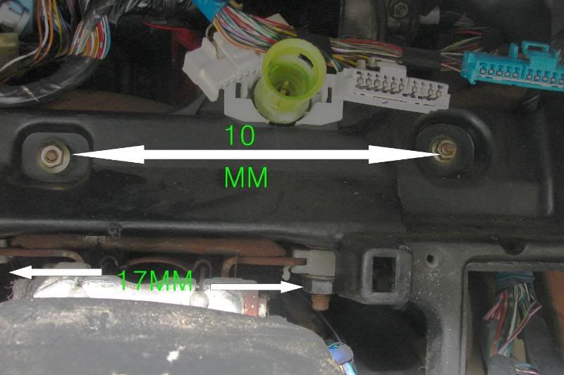

This is the place of most concentration. You will need to drop the steering column. I generally also remove the driver's seat, but you don't have to. It does make the job a whole lot easier.

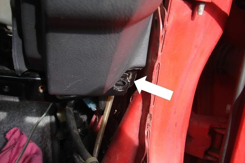

After that, I believe you have only the two in the bottom corners on each end of the dash. This picture shows where the passenger side bolt is. You have to pull the kick panels to get to them.
