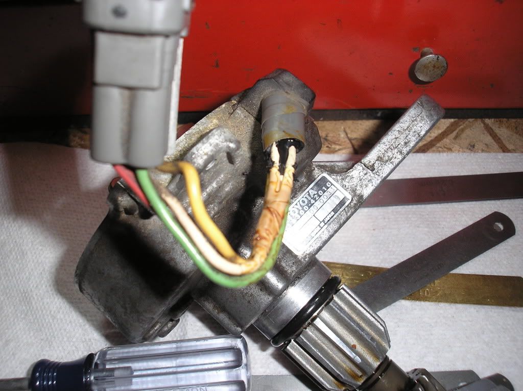

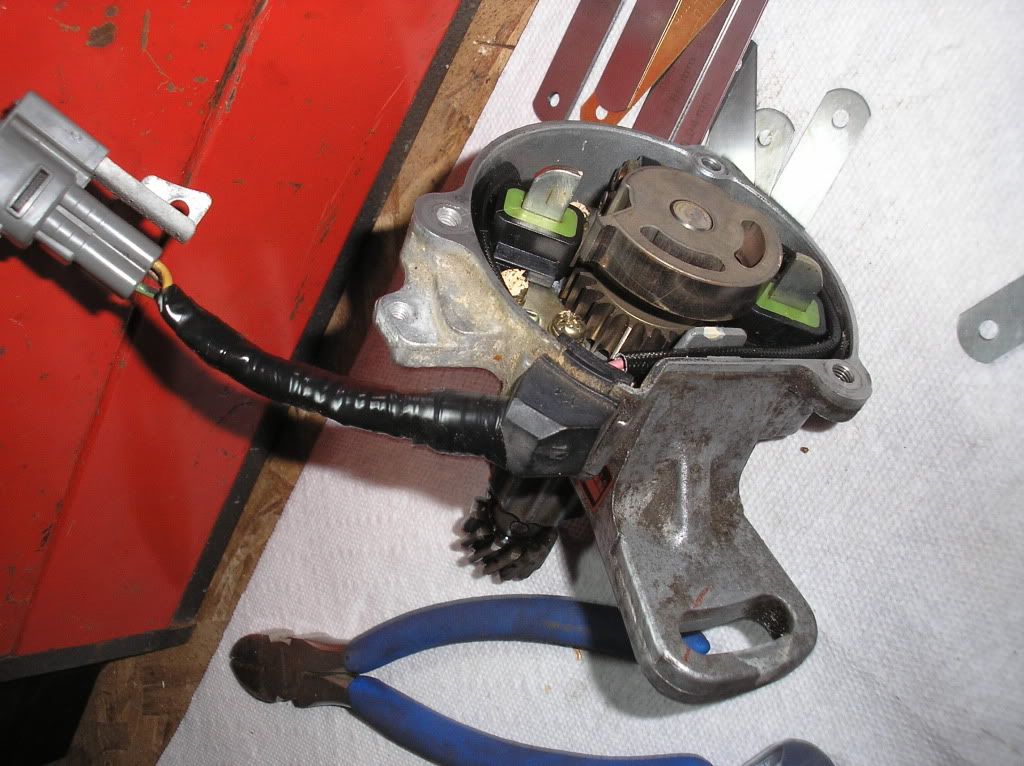

First - Is it normal for the factory wiring to the CPS to have splice in it? I took the old crappy electrical tape wrap off of the wiring and re-wrapped it with scotch Super 88
unwrapped
wrapped

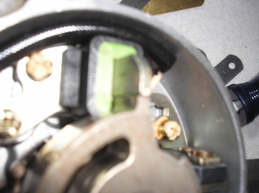

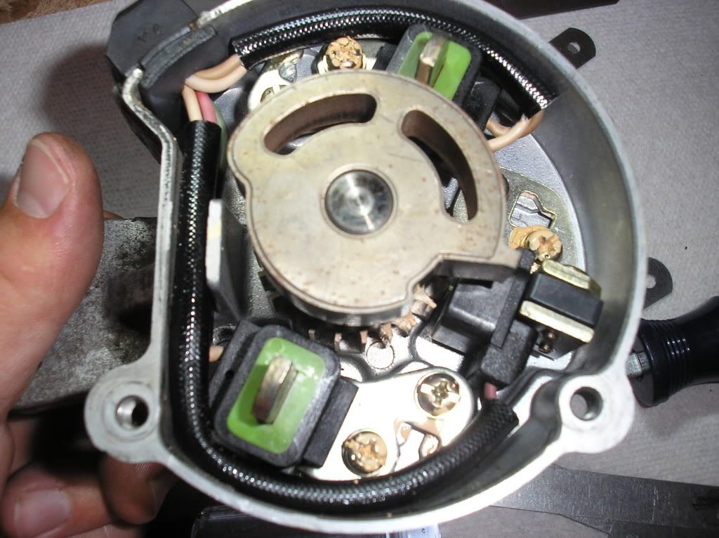

Now to the interior of the CPS (it has a recently replaced gasket and factory plastic cover)
Camera sucks even on micro... but its the only pic of the "gap"
overall pic
I was hoping this might fix it but once i measured the gaps with my feeler gauges I was doubtful it would do anything. Just waiting for it to warm up to time it it was starting to miss...damn car :)

The inside of your CPS looks CLEAN by the way!!! :)

Looks like the pickups were replaced and the CPS rebuilt, or its nearly brand new.
Did you get measurements for the gaps? Also, is the top reluctor flush with the top of the G1/G2 pickups?

I believe it is still the original CPS from the car. That said, the gaps for g1/g2 were pretty good as they were. One of them was just out of range (don't remember which). that said I adjusted all 3 of the gaps down to .008" and yes the reluctor is flush with the tops of the pickups.
