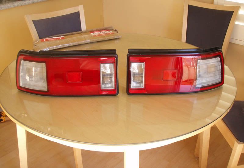

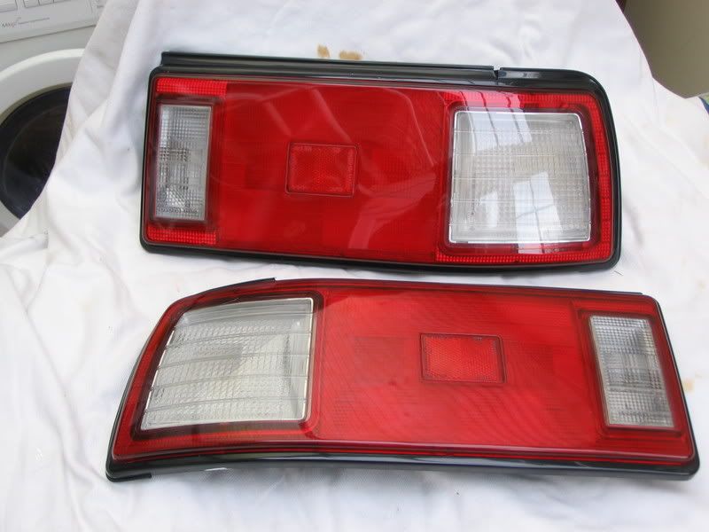

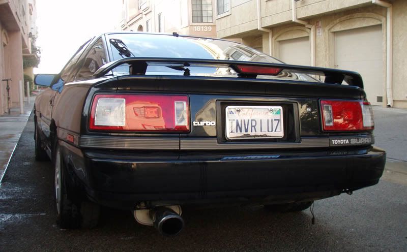

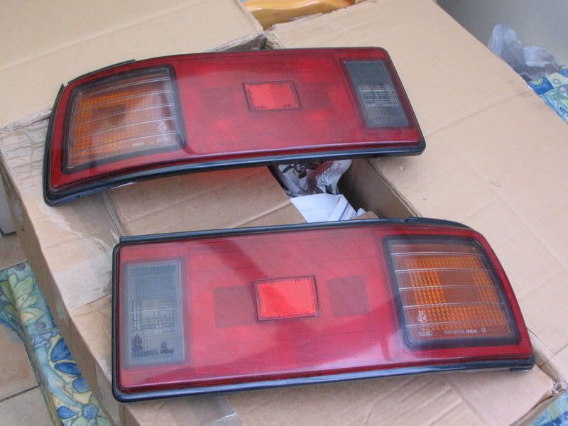

In the meantime, here's the rear conversion I did for an owner here - in fact the only ones in the U.S. Unfortunately I believe the car has since been broken....I wonder who's wearing these super rare items now?
and this is what they looked like before.......

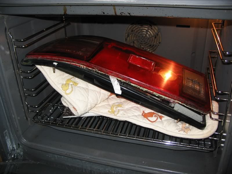

JDMMA70;1862082 said:
Details on taillights
What d'you want to know?:icon_bigg
Basically, I get some old units....
and bake them in the oven....

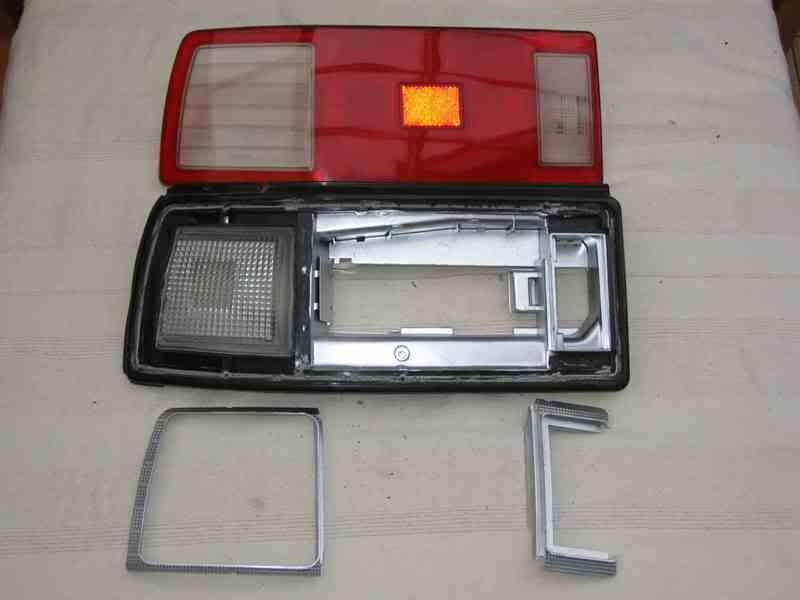

to separate the internal components.....

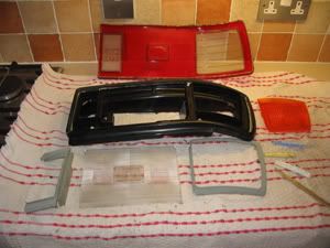

some of which I chrome spray after thorough wash 'n polish...

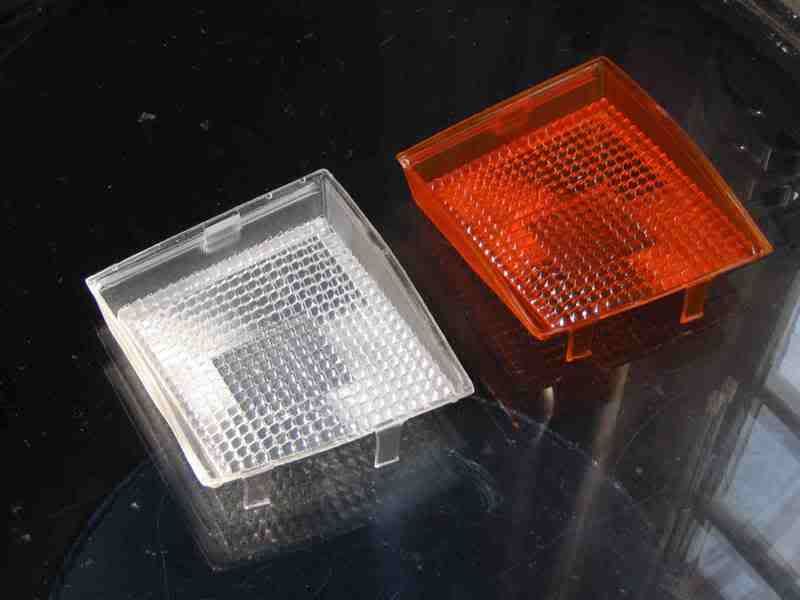

I then make an exact replicas of the amber insert lenses...
Then reassemble and polish the outer cover again..
Simples :biglaugh:

You need to know how how they're put together before you can take them apart
Before the oven stage, you need to remove the 6 blind headed screws through the back of the casing into the front cover(they're close to 6 bolts holding the unit onto the car.
I use a Dremel with a router bit to ream away enough plastic to just expose the head of the little screws. Then I apply the tip of a soldering iron for 20 secs or so then whip them out with a fine nose pliers.
With them all out you can proceed to oven. Electric with fan and element at rear, use oven mitts or similar to make sure unit doesn't touch oven shelves or walls.
100 deg C for about 5-10 minutes should allow the cover to be pryed off. Pressing through the reverse light apeture is a good place to start. May need to reheat a couple of times.
I generally find you can reuse the original sealant or you can scrape it all out while warm and use a bead of clear silicone
