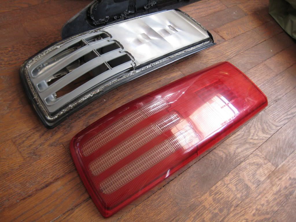

The center tail section was a bit of a problem. I really didn't want to cut up that whole center piece just to get the trim removed. Right now there are seams at edges that piece -- I think I will wait and see if that bugs me before I decide what to do about it.

I have also taken the tails apart in hopes of an LED retrofit. Now I have to learn how to build a PWM...

Yeah, I took the plunge and baked the lenses apart, so I'm committed now...

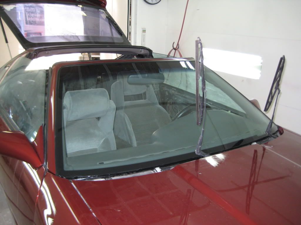

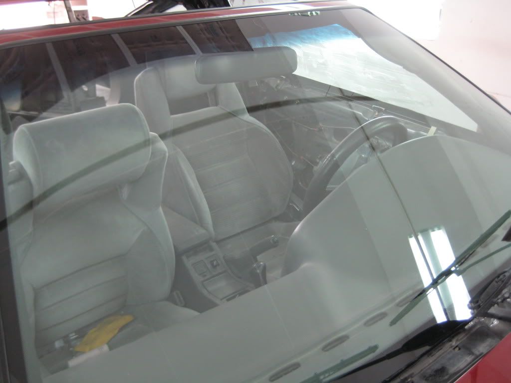

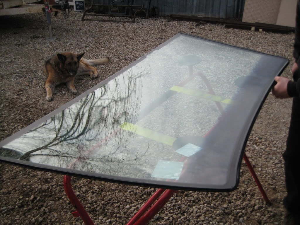

Today we got the windshield installed and a lot of the interior put back together. Windshield sucked! After prepping everything, laying out all the adhesive, we placed the windshield in place and found it was 2 inches too small. So frustrating! It seemed like none of the local glass shops had the right shield in stock, but finally we called Safelite. Not only did they have a shield in stock, the tech that came out was impressively competent. It was a very enjoyable experience. Here are some pics:

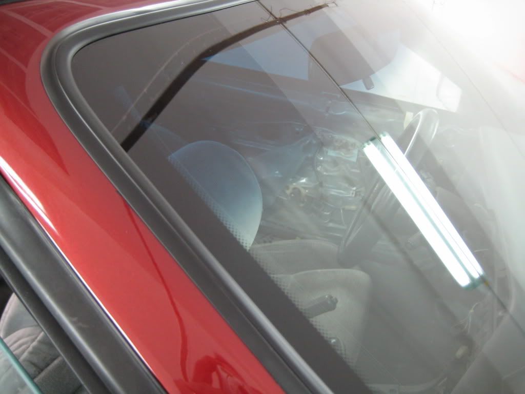

mecevans;1506373 said:
moar pics! what kind of weather stripping is that?
Enraged;1506617 said:
that new style window trim looks great. I wonder how much a shop would charge to replace the stock stuff without replacing the windows?
I am very happy with the aftermarket windshield trim. Much better looking than my faded metal trim pieces. You can buy this new trim by the foot at any glass place (I would know, I bought 10 feet of it and put it on the one we already had, before learning it was too small) and he mentioned that, though it is ideal to put it on with the shield out of the car, it is possible to apply it with the windshield in place. I don't know what it would cost to have someone put it in, but the trim itself is only $2/ft (about 20 bucks). Oh, and the lifetime warranty includes the trim, so I imagine its pretty durable.
