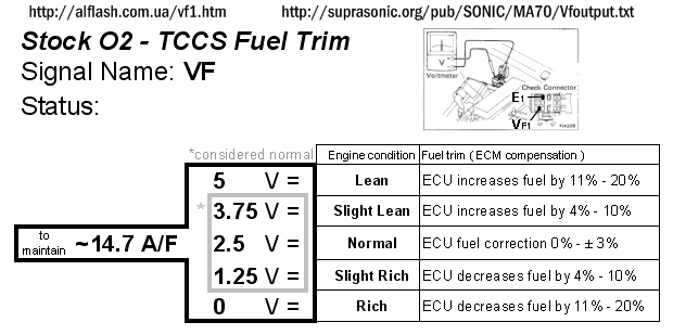

90T04;1623808 said:
I'd start by checking Vf
Thanks alot, I dont have reader like that but I have a couple of friends that do... I will show them the picture you posted on how to test it out....
This link as well
http://www.well.com/user/mosk/Vfsignal.htm
Did a little research now that I have a clue somewhat... I wonder if any of my wiring is messed up since alot of the engine components have been soldered.. The 02 sensor I just wired up a new one, my vsvs had to be soldered because it literally had none when I got the car... Knock Sensors rewire just went in... But the code is gone and I am sure that rewire went well... Ugh starting to stress out....
