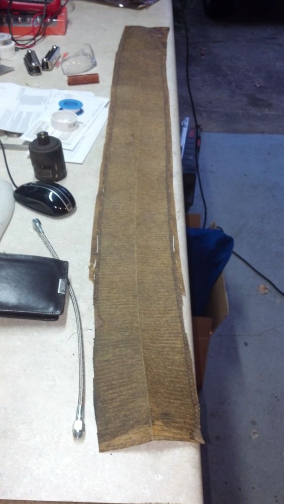

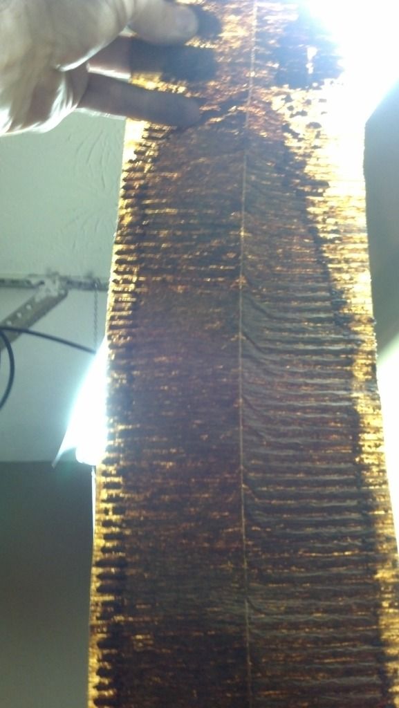

As for the lifetime filter...
The part at the edges that you can see through is more or less clean. The rest of it (most of it) is caked with dirt. Not saying that this is your issue.
Just saying that the "lifetime" thing is questionable.
64
"Lifetime" is a Misnomer.....
I always throw a new filter at any car I buy as you have NFI what's gone through it in the years prior to purchasing...
Not saying it's connected but it's good practice, a WBo2 or a Fuel pressure gauge would have shown if this were the cause.

QUOTE=supraguy@aol;2020859]As for the lifetime filter...
Just saying that the "lifetime" thing is questionable.[/QUOTE]
dude there is at least an entire lifetime on that filter why would waste that lol on a second note I have never seen u that before good pics

^^^. Totally agree. Once you know it's new in your lifetime you are good. Not saying it is your problem. But I would have a new one on today if I was you. Alot of guys are finding wire connector issues like 3P's said and brittle wiring around back side of head. IE: #5 and 6 runner area. Good luck.
