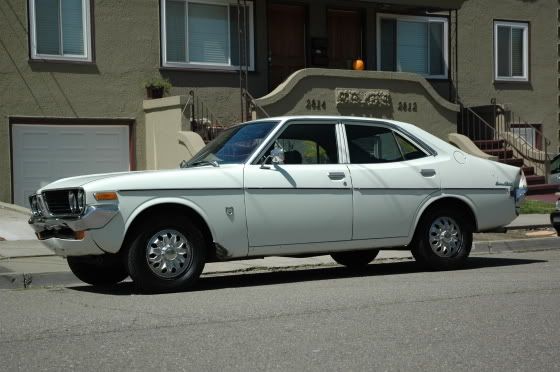

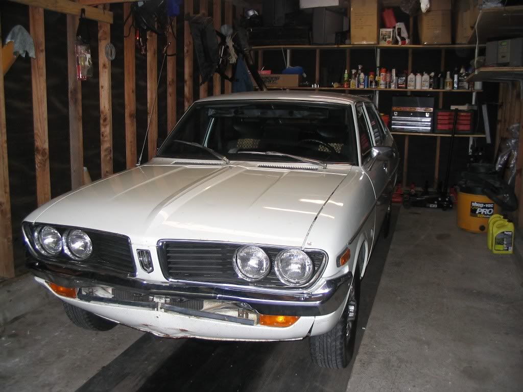

First, here is the car:

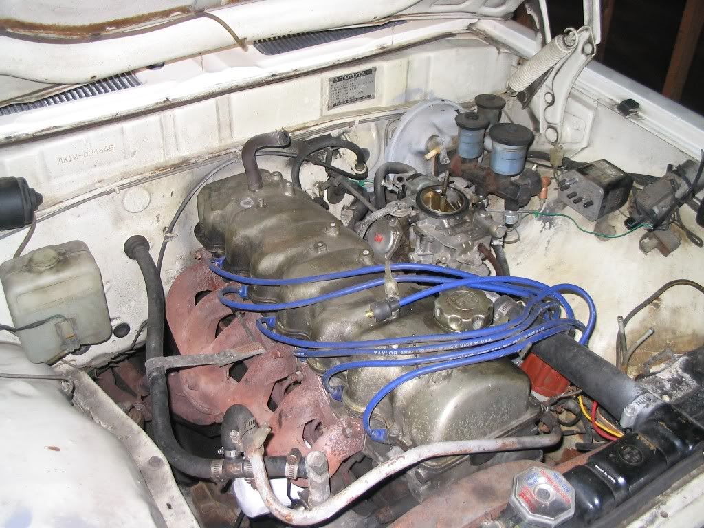

Its a 1972 Toyota Corona Mark II. MX12 chassis. Under the hood is a 2M straight six. 2.3L and carburated, it was rated at 120 something HP. It ran great and had ok power, reved nice and smooth. Horrible gas mileage though. That and the engine didn't seem to want it's oil in the crankcase, but prefered it on the pavement. Not only that but the engine was smoking like crazy. Bad valve seals I think. No matter. A replacement engine should fix all that. After some research I decided the 7M would be a viable swap. Meaning that I would be able to handle it myself. So a donor car was found:

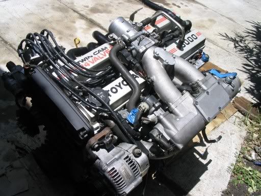

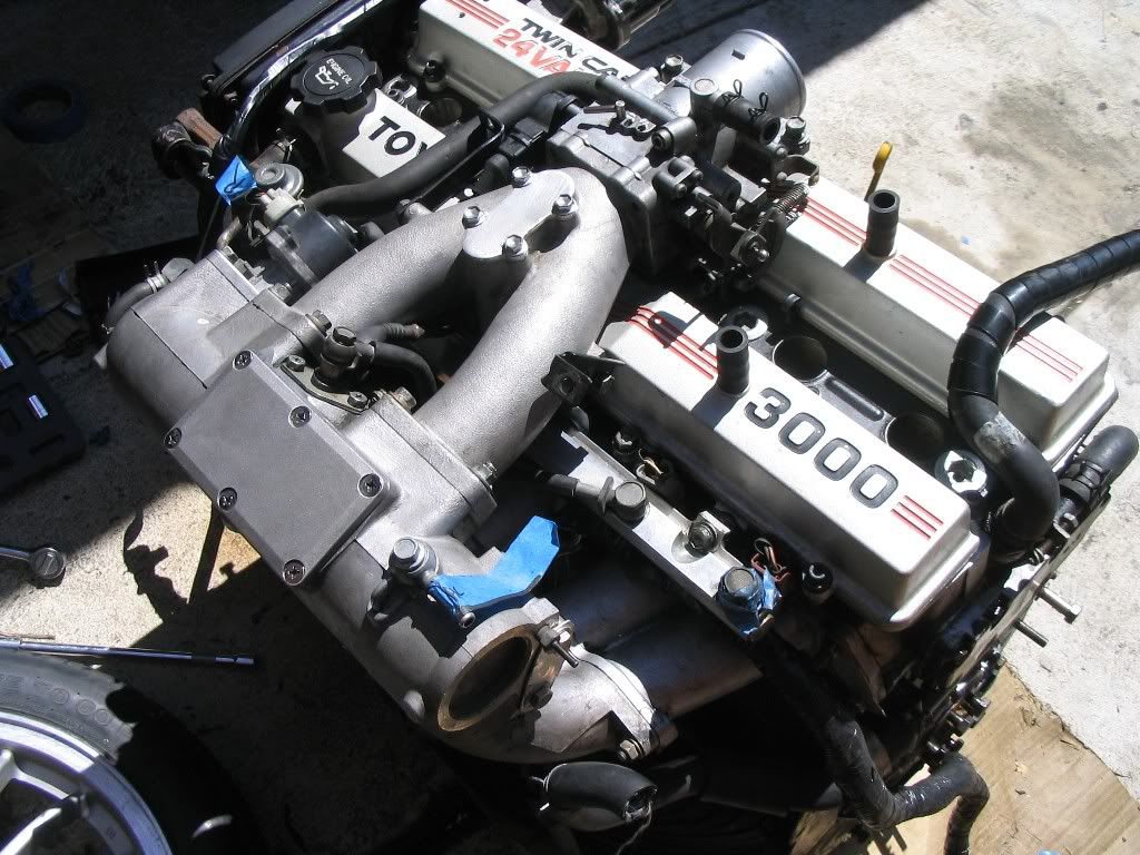

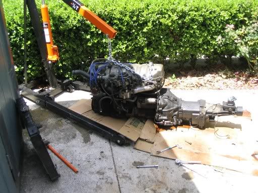

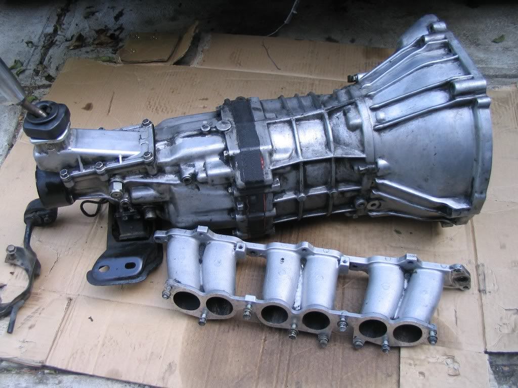

One 1989 Supra N/A auto delivered to my brother's driveway. Not in great shape, but the guy assured me it ran. Plus, there was a W58, manual driveshaft, flywheel and clutch slave thrown in the back as part of the deal.

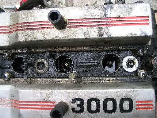

Dirty. Valve covers had been leaking. Power steering had been leaking. Oil everywhere.

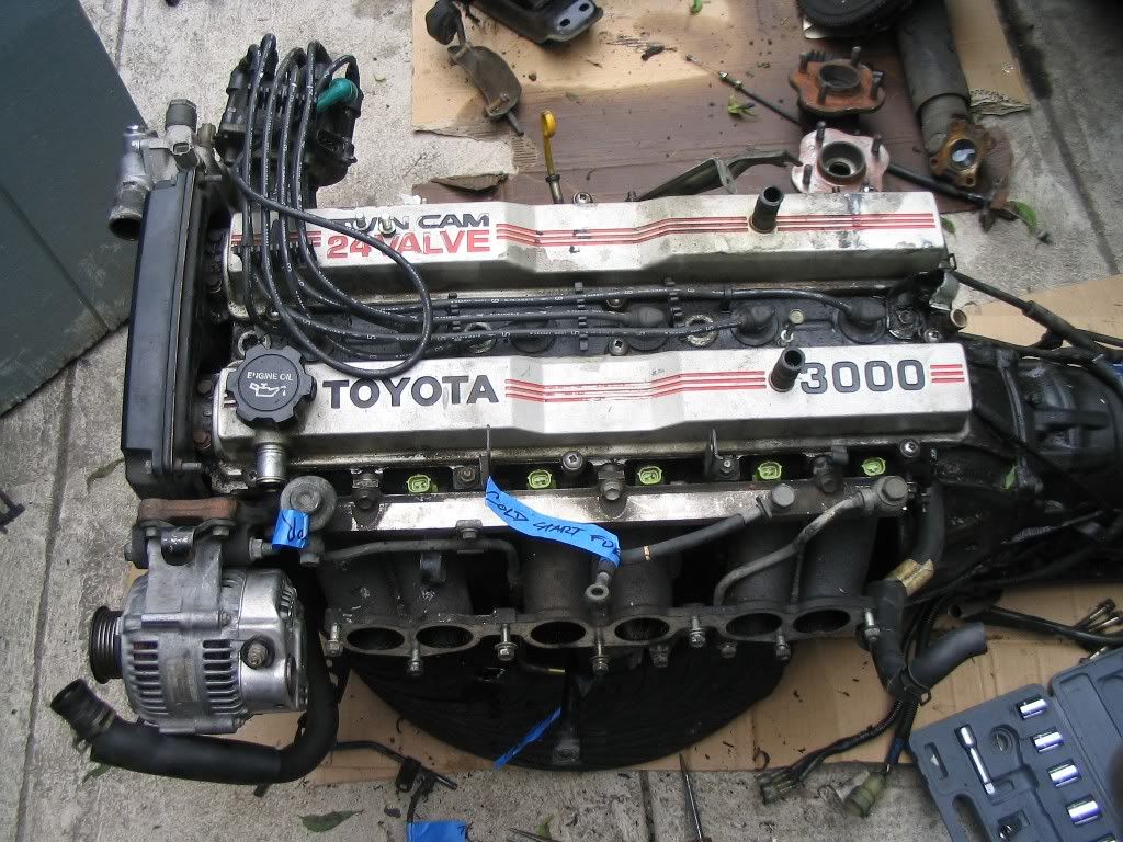

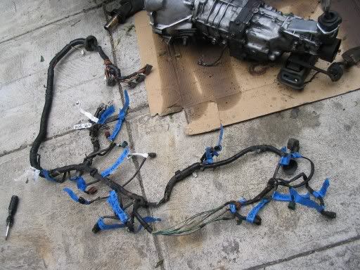

Harness tagged and removed. Blue for stuff I need, white for stuff I don't.
Cleaning parts. I went through so many shop towels, wire brushes, and degreaser it is amazing. But I like clean engines better than I like dirty engines so it was worth it.

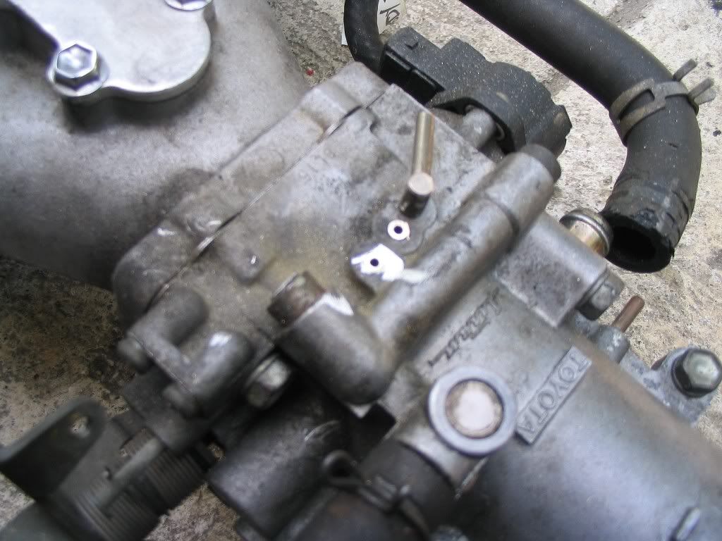

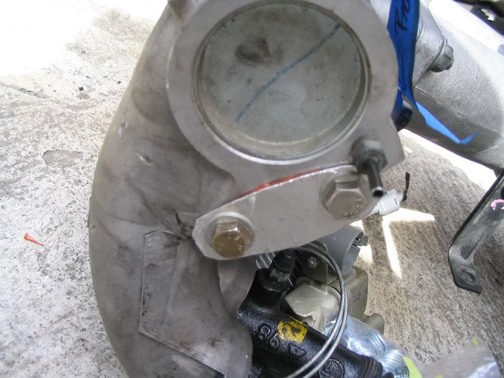

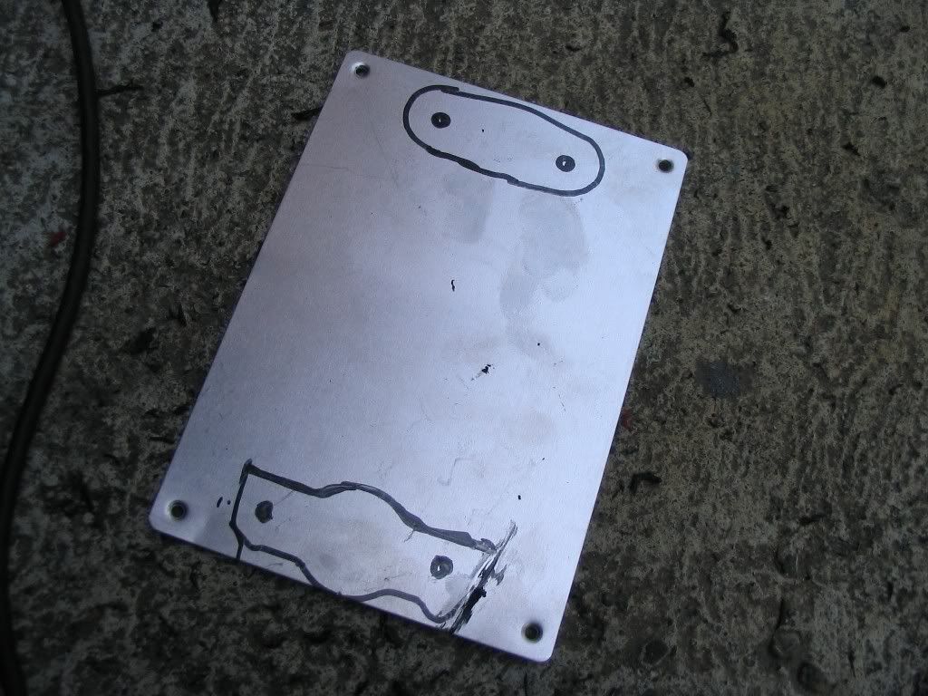

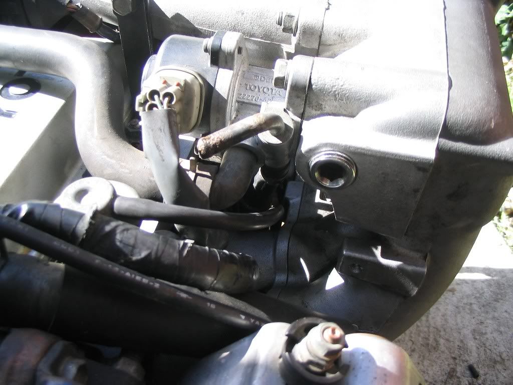

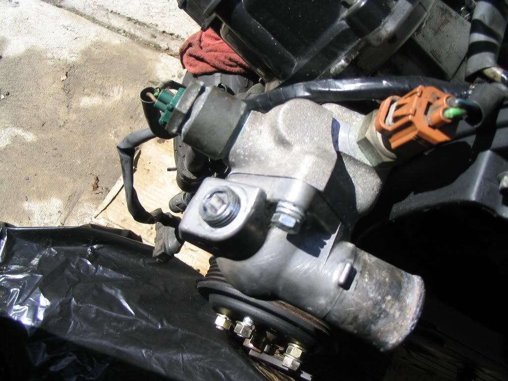

Because I don't have to smog this car, I am ditching all the smog stuff. Simpler, and it looks better. Trying to clean up the intake manifold I cut the vacume ports and throttle body coolant line fittings off. I also traced the outlines of the EGR gismo to make block off plates. The metal is the bottom from a Radio Shack project box I had laying around. Not very pretty, but it works. No one will really be able to see it anyway. Also, I used those allen bolt plugs you can get at auto parts stores to plug the hole in the water neck where a VSV was and a now-unused port on the intake mani.

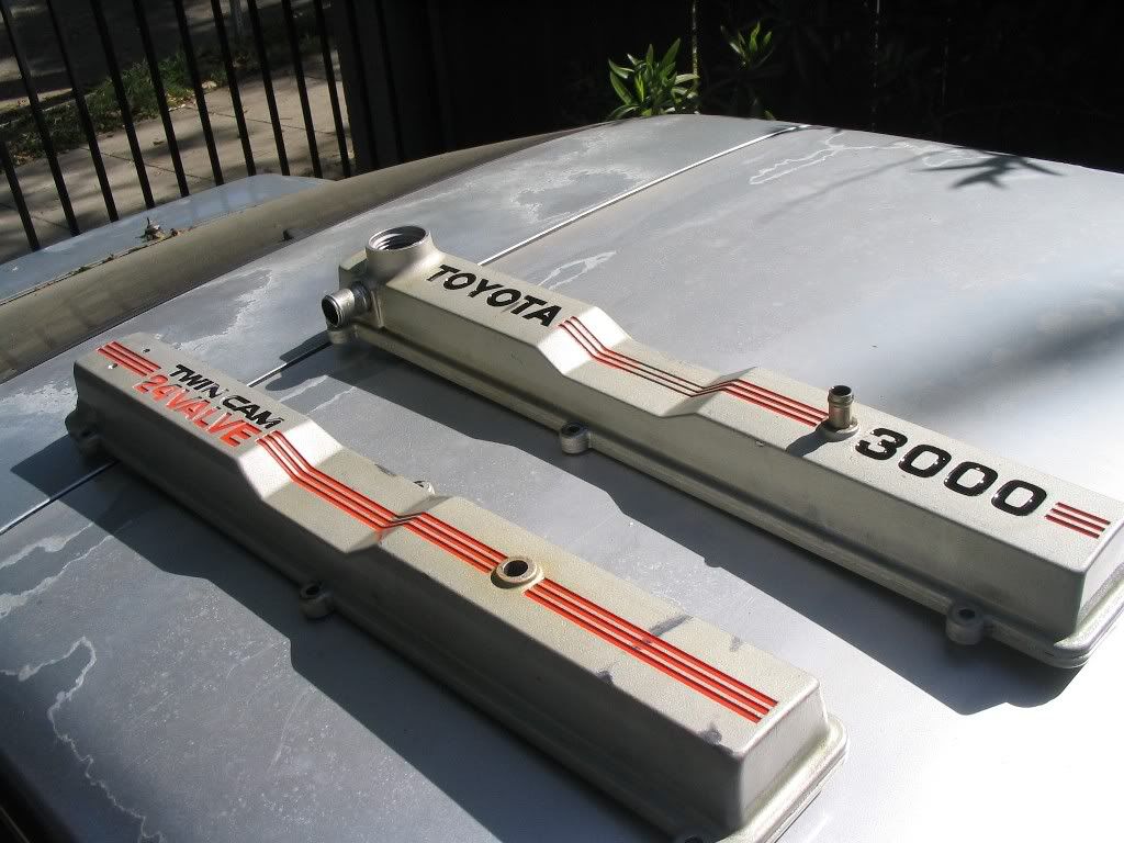

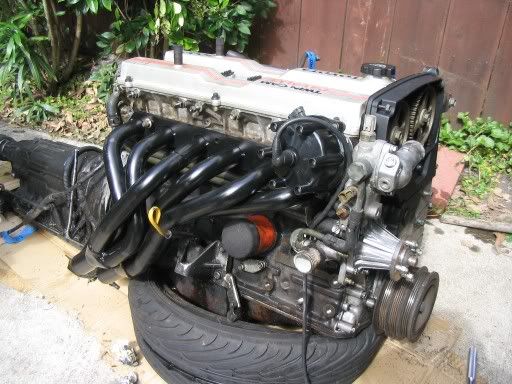

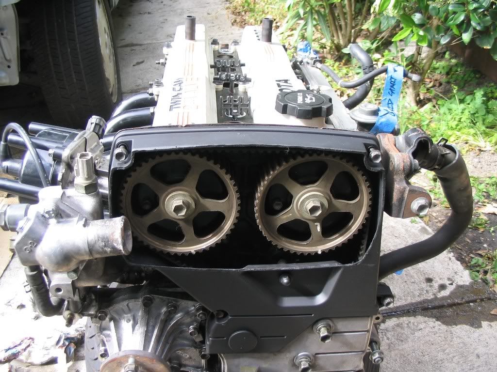

Some Pacepooper headers came in, and I had to hacksaw the flange to get them to fit. I think the flange was drilled wrong, otherwise it would have been fine. Also, the rice boy in me loves the look of exposed cam gears. I think that the headers and visable gears combined will help give it a hot rod look that I am going for.

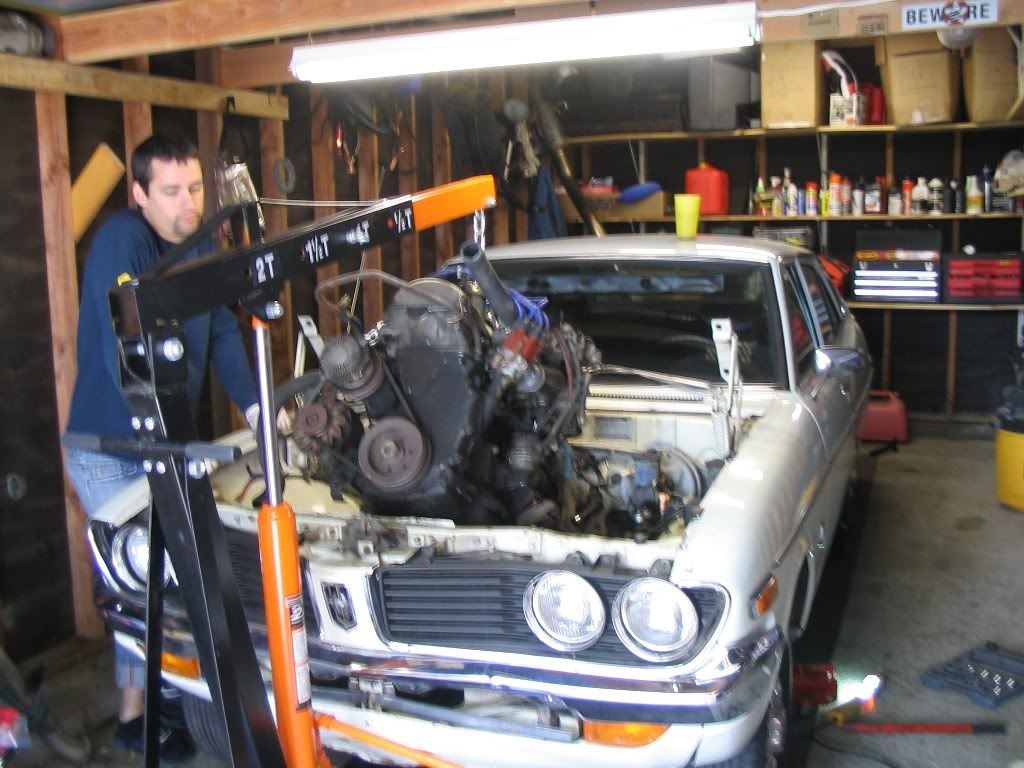

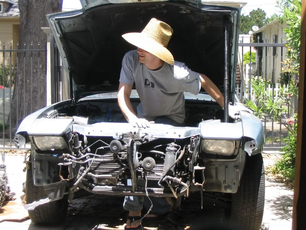

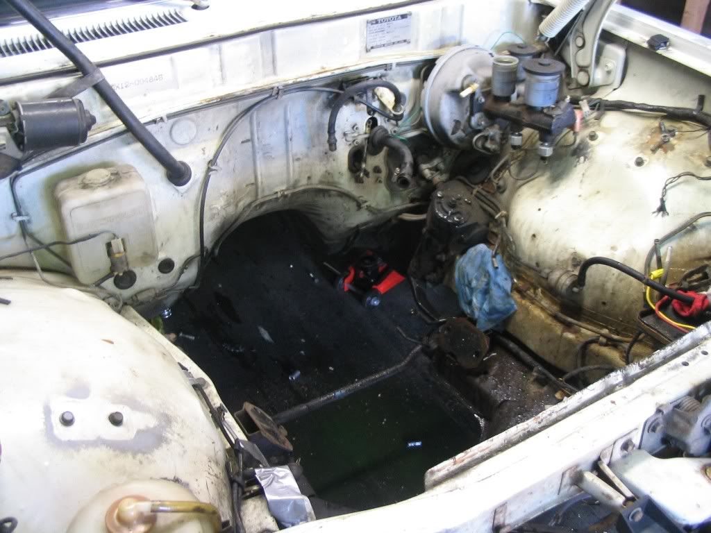

MKII in the garage and we are about to start!

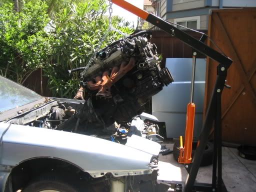

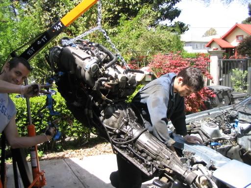

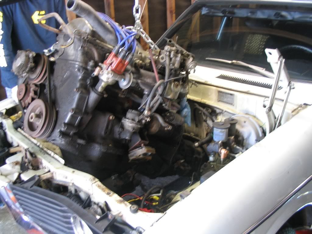

What a mess. The engine kept barfing coolant. A fuel line kept siphioning gas. And oil oil oil everywhere as usual. Some minor frustrations getting the engine out was showing on my brother and I's faces.
Thats the progress so far. Its been fun, but it hasn't even gotten difficult yet. Figuring out the oil pan that needs to clear the crossmember in the front, and the steering rack in the rear will be interesting. With any luck the 2M pan will bolt up to the 7M crankcase. 2M motor mounts should work, if not some combination of 2M and 7M will. After all that.....I still need to get it to run :1zhelp: hahahah

I don't doubt that the 2M oil pan will fit the 7M block.
However, you may want to look into getting a 7M pan from a Cressida and oil pump to go with it. Cressy's are rear sump, let's just hope the sump is small enough to fit in the space provided by the Corona's bay.

Thats interesting...I thought the cressys where front sump? But yeah, thanks for the advice. If the 2M pan didn't fit, I was going to use a 7M pan, oil pump, and pickup from a Cressida. Dunno yet really. Just going to have to take stuff apart and see what works.

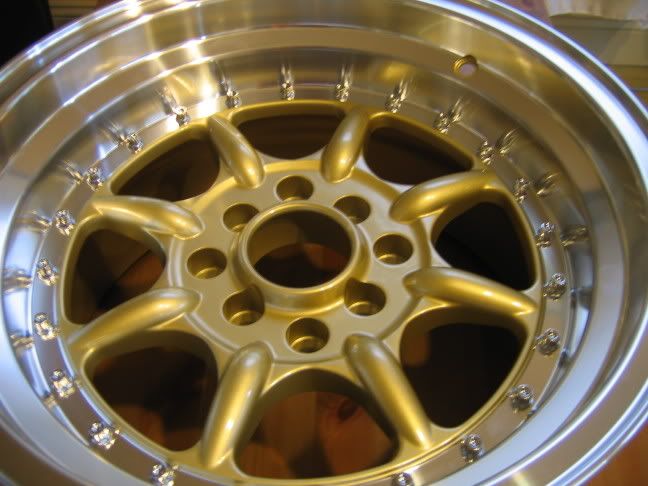

And this just in!! My wheels arrived today!! My brother just sent photos ( I am at work )
The specs are 15x8 zero offset. As soon as I do a test fit with tires I will know how much I can lower it. Going to go for a "nice" drop. Not too slammed, but defininatly low.

D'OH!!! I'm dumb. I was mixing up my 7M junks... You're correct, Cressy's are front sump. The 7M pan won't fit then?
Sorry. Don't know what I was thinking... :nono:
are those sportmax wheels?

Yeah those are sportmax....I am a little embarassed to be rocking the ebay wheels. But I do like the style. Plus these gold ones where a limited run of only 10 sets.

I wouldn't be ashamed at all of those wheels. Sometimes it's just not feasible to buy the true JDM old school wheel due to lack of circulation, discontinued, and they wouldn't look half as good as these do, since they're new!
That said, I'd run sportmax wheels on my supra no problems.... because, chances are the only person who will say anything is the guy driving the Hyundai Elantra, and he can fuck off. ;)

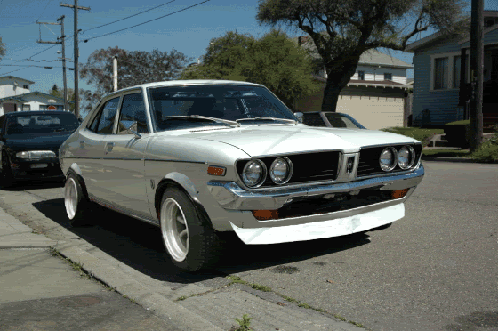

Just to keep you guys entertained, here is the photochop that is my avatar:
I asked the guy who made the front lip on my Nissan 240sx if he would be willing to make some custom one-off stuff for my Corona. He really liked the idea and offered to "sponsor" me. I didn't ask what he ment by that, I am guessing me only paying for materials and then sporting stickers on my car ( No, sorry. No stickers on the Corona ) He asked me to send him some photos of what I was looking for and then he photochopped some stuff onto a photo of my car. I still don't know if I will do fender flares. I don't think I will have to. So the front air dam will be the main deal.
