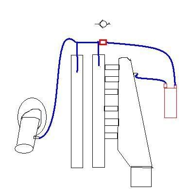

even with a check valve on the intake manifold outlet, you'd still be sucking dirty crankcase air through the turbo under boost.

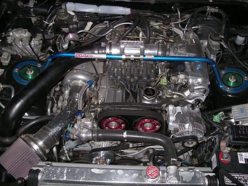

90T04;959616 said:
I think im going to do it that way too since I have a ffi. So what size is your port in the intake manifold providing the vacuum? The stock system does not incorporate a pcv valve, instead it has a metered hole in the TB for a vacuum source, correct? And if I understand correctly, your PCV valve is also whats protecting the crankcase from boost pressure, and thats where your hose to the turbo inlet takes over?
edit: like this:
This is quite accurate and you are the prize winner. I also have a PCV can in between the turbo intake as well:naughty: The vaccum line is a 1/4 vacuum feed. The line you have going to the turbo intake I have feeding to another catch can, and continuing from the catch can going to the turbo intake. Dean Marcum shared with me that his is set up simularly.

adampecush;959872 said:
I think you're defeating the purpose of the catch can like that. Under boost, the catch can will be inoperable, no? Someone correct me if I'm wrong.
This is why I am using 2 catch cans, and the PCV valve has a check valve in it that keeps the boost from coming out of the intake under boost conditions. The second catch in between the turbo and the valve cover which is on the turbo side takes over when the first catch can is blocked by the check valve in the PCV valve. This works perfectly, and I dare any genius to prove it won't.;):biglaugh::naughty: I have a clean intake and a clean turbo intake pipe as well. I don't lose boost pressure when boosting because the pcv valve keeps the intake pressurized under boost. This designed is tested and also approved by the great chevyeater who is the best emissions specialist on these forums that I pesronally know of. Emissions testing, and diagnosis was one of his specialties when working for chevy.:biglaugh:

QWIKSTRIKE;953168 said:
I functionally have 2 catch cans. One vacuum line off the back of the FFI going to the left side of the catch can, and the other port going to a PCV valve thats in between the hose, and the metal tube coming from the valve covers. The end of the pcv pipe that went to the turbo intake is going to one side of a catch can, and the other to the in port of the turbo completing the total catch can solution.
You guys forgot to read the full statement about my 2 catch can design. My second can is installed where the stock intake box was on the front radiator support, and feeds in between the turbo and Valve covers before feeding the pcv valve with the check valve in it, which continues to the catch can which then feeds into the intake which is the main vauum source under normal driving. Under boost the first catch can off of the intake has a pcv check valve in it which closes, and the catch can before the turbo thats plumbe to the other end of the check valve now takes over when boosting under presure
I was referring to the diagram, not your setup.
