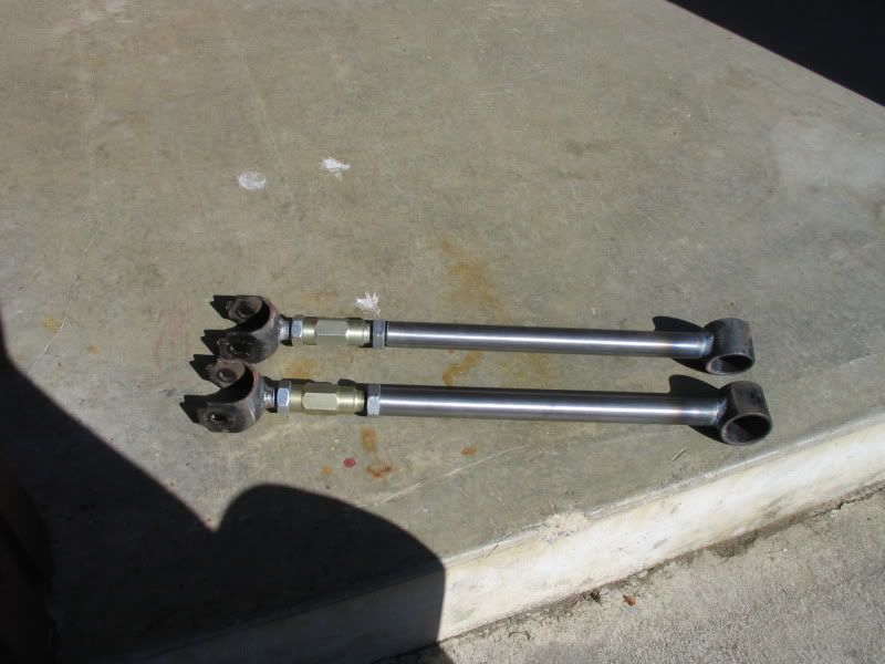

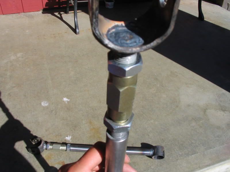

i saw a1 arms ones and i laugh at them there junk well at lest the set i saw so i made my own
i i have more to make like lower arm and other s
