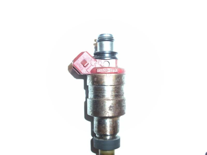

so i just bought a set of used Denso 550cc Injectors from 935 Motorsports on eBay.
http://cgi.ebay.com/ebaymotors/ws/e...7053&viewitem=&sspagename=STRK%3AMEWNX:IT
It says they are high impedence injectors, ok.
They came in.
So today i'm looking for clips for it online and i get some more info about denzo injectors.
I came across this:
ND made some low impedance 550s which are direct fit for the MKIII's fuel rail. Their part number is: 195500-1370. BE CAREFUL! for some reason ND used this same part number for their high impedance 450cc injector too. How do you distingush between the two? Look at the notch on the top of the injector connector-if it is in the center its low impedance, if its offset to the side, its high impedance. -grimreaper
http://www.supramania.com/forums/showthread.php?t=88151&highlight=denso+injectors
So i check out mine
was gonna get them cleaned and rebuilt.
Perhaps a mistake was made and i recieved smaller 450cc injectors? . ;)

Measure the impedance of the injectors and have them flow tested. This is the best way of knowing what you have.
Also, contact him, and see if he had them flow tested or what his source is for knowing these are 550cc injectors.
For all you know, someone pulled a fast one on HIM.

Measured the resistances and confirmed high impedence injectors.
Reading is 13-14 ohms on the injectors.
He did say they were high impedence, and also gave the resistor pack plug as you can see in the picture.
Get them flow tested to determine flow rate? No thanks, I'm not paying that much money to determine i got a wrong part.
I'm waiting on an email reply.

Those look like 1988 RX-7 Turbo II, 195500-1370, 550 high impedance injectors
wardog
R.G.V WARDOG
Jan 19, 2006
564
ALTON, TX
Yeah they are the Red High Imp 550s cause i have the Tan Low Imp 550 Injectors form the 87-88 Turbo II rx7....:icon_bigg
