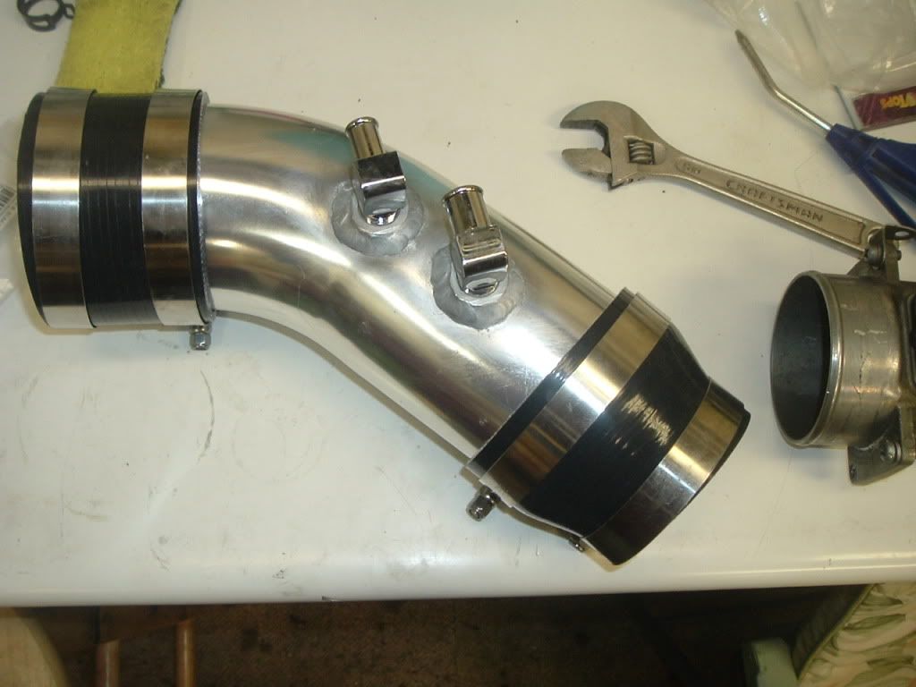

Well as for today, whooo!!! I got a day off from the shit hole job I have so I took advantage of it, took the vette for a drive, drank lots of beer but also had the turbo intake made up / welded up. Tomorrow I will get it installed along with Hundo's PCV system. Also I bought a 05' Ski doo snowmobile today. It was a steel of a deal :). Well on to some fing pics!!!! Sorry only cell pic right now.
Just after cutting the 4" pipe to length. LOTS of burrs.
After cleaning up and welding in the bungs
Top side
Bottom side (need to keep the power steering idle thing now don't we :) )

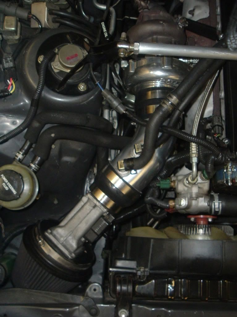

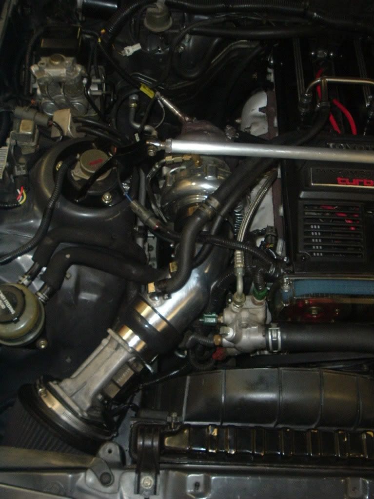

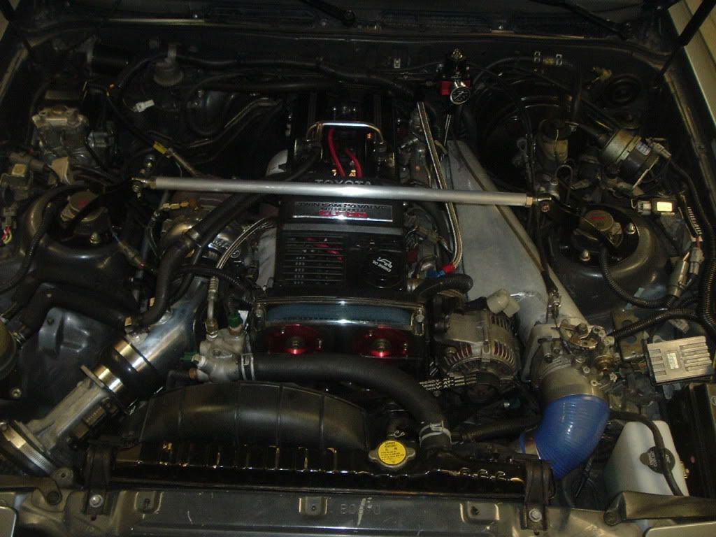

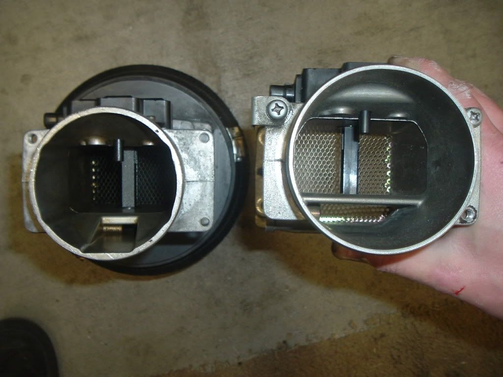

Well we were up and at it early this morning. The intake fit "ok". I need to replace my K&N with a smaller air filter. This one is just to large to allow the intake to fit perfect. Just another thing to put on the list. Also when I had the OEM AFM out I took a pic of it next to the lex. I will stay with the OEM AFM until the 550's get here.
:rofl: I just noticed I need to reinstall my CF "tool holder".
Well on to some pics.

emiliorescigno;1565232 said:
Looks waaaay better than before - driven it with the new pipe yet?
Yep it looks 1 million time better then the "afro engineering" one I had in there before. Now get a air filter like yours and it will look and fit perfect.
As for driving or even staring the 7m with the new intake on,.............LOL nope. I haven't even started to car with it on!!!! Just now enough time in the day any more. I had a ton of errands to get done this afternoon, plus I'm coming down with head cold now and feel like shit :cry: .
Yes, I took the Vette today. I have to ware the "newness" out of it and me. Maybe tomorrow night I will start it and take it for a test drive. But Im guessing that wont happen due to time, so it will have to wait till sat morning when all you guys show up.

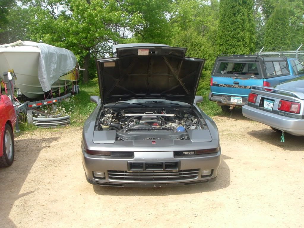

Well the meet this past weekend was fun.
Also the garage is FULL once again. :cry: :cry: going to have to find a larger storage shed soon.

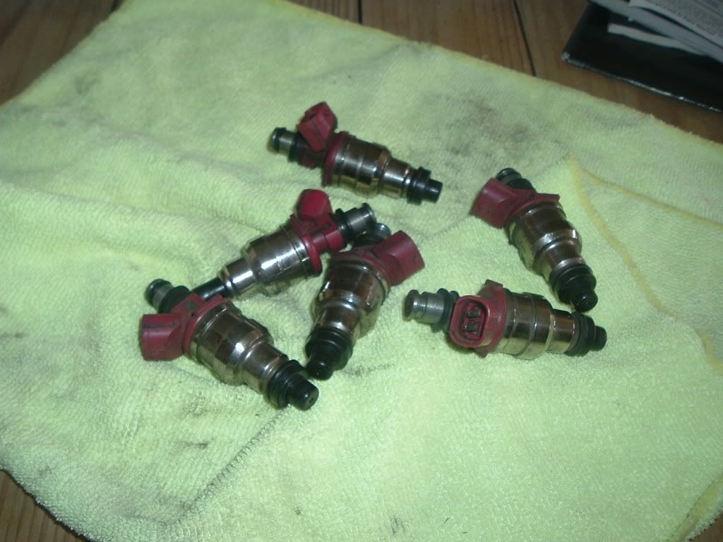

As for the sup, I haven't even started the car since the meet :( I was going to drive it today but was to lazy to move cars. How ever the 550's showed up, so time to get some new o rings and clean them up. Then see where that mappro is at, i figured it would have been in a care package at my door by now ;)
