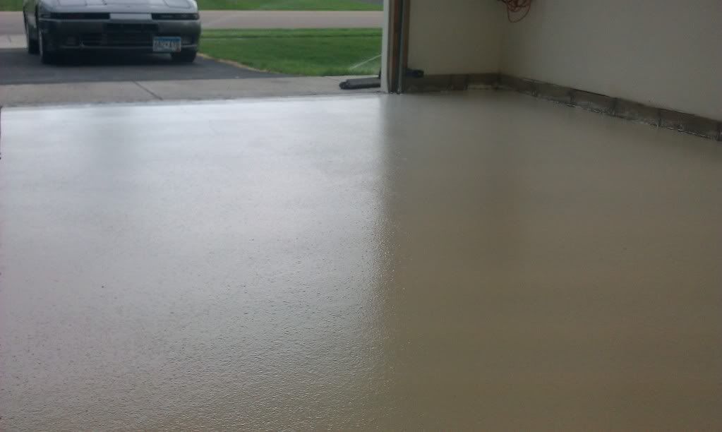

Once again not much done to the sup, rather more garage work.
This week was sad to hear a long time supra owner is finally getting out of the game. Pretty much all electronics including the M800 is already sold. Sean is probably happy to hear :(

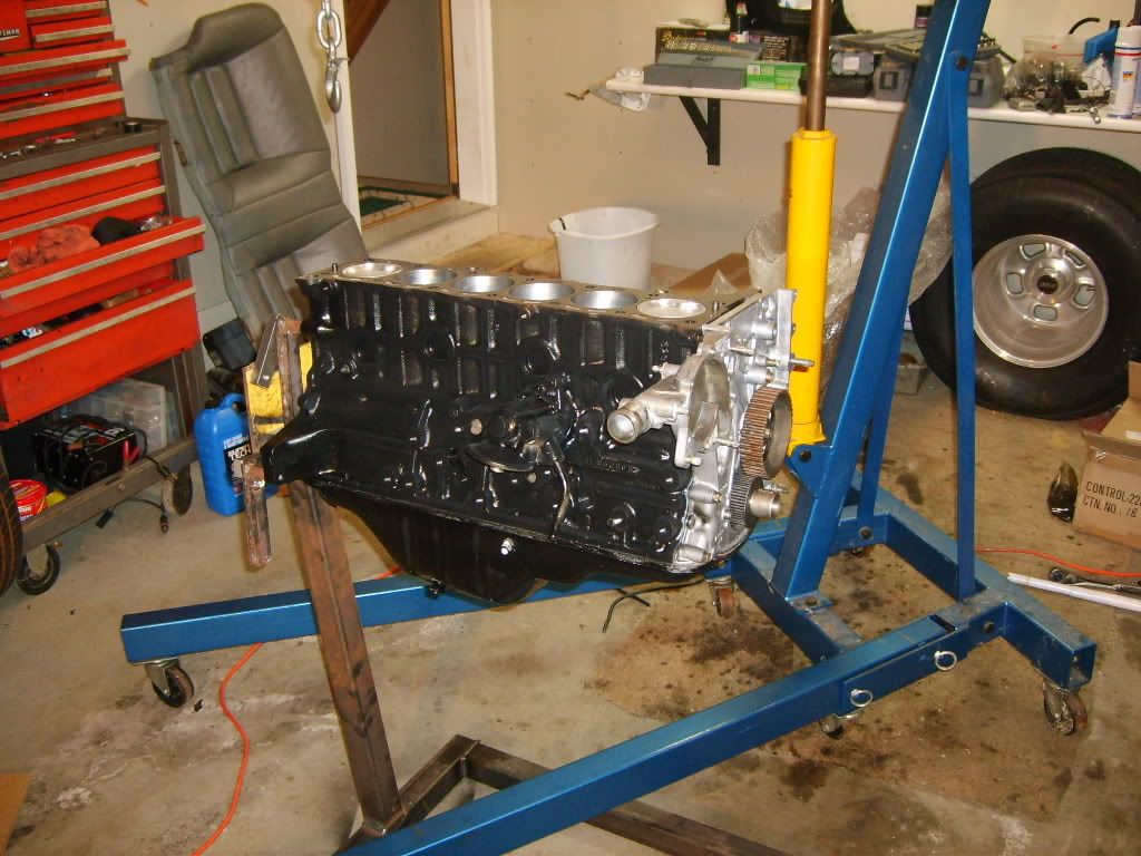

Floor half done. Now to let it cure and move shit around and do the other side, and paint the block

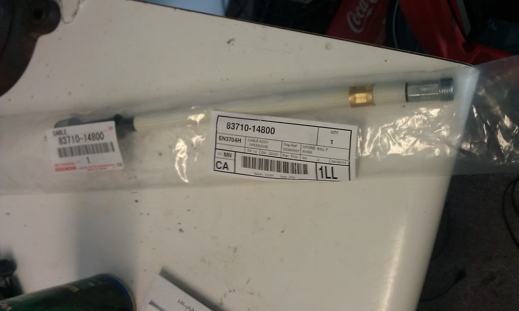

Yep, but had to use loctite to keep the 2 cables from un-screwing. That is about all I have done this summer besides drive it. Guessing I put on at least 4,000 or so miles. I don't remember where the odo was this spring,

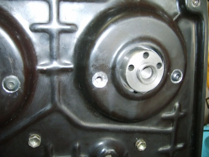

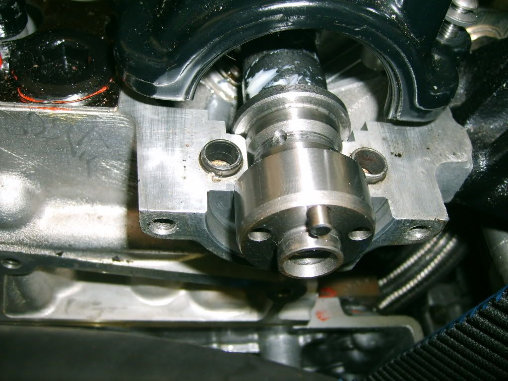

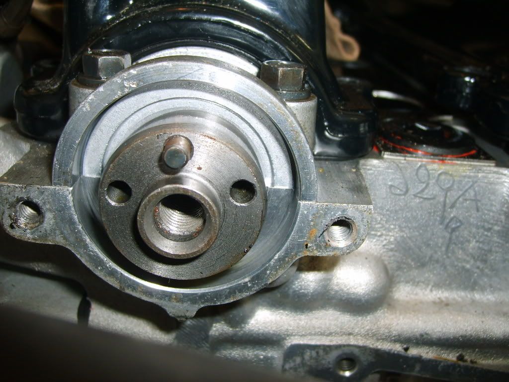

Well guys here is a long over due update...

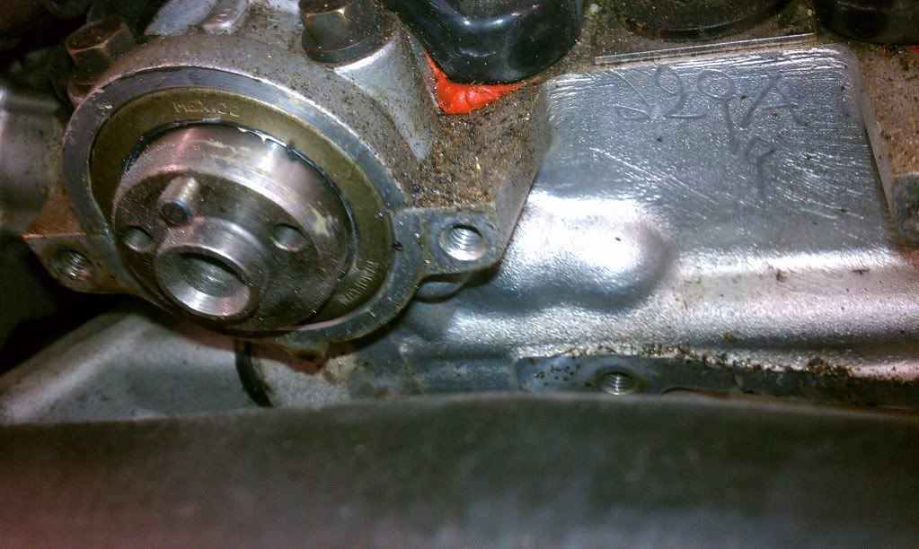

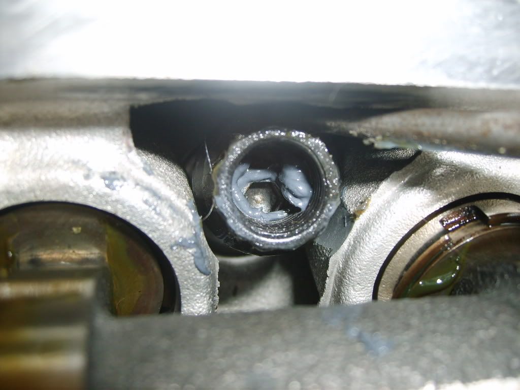

About 3 weeks ago I got the supra out for the summer. The oil leak on the front of the engine I finally found. If you remember I already replace the main and oil pump drive shaft seal last summer with OEM Toyota seals, and the leak was still there :(. I figured since I just put in the cam seals I didn't replace them, but bought them just in case. Well last weekend I decided to replace the cam seals since it is the only ones I haven't re-done yet.
Bingo! it was the exhaust cam seal that was leaking a little.
New seals in and not leaking :)

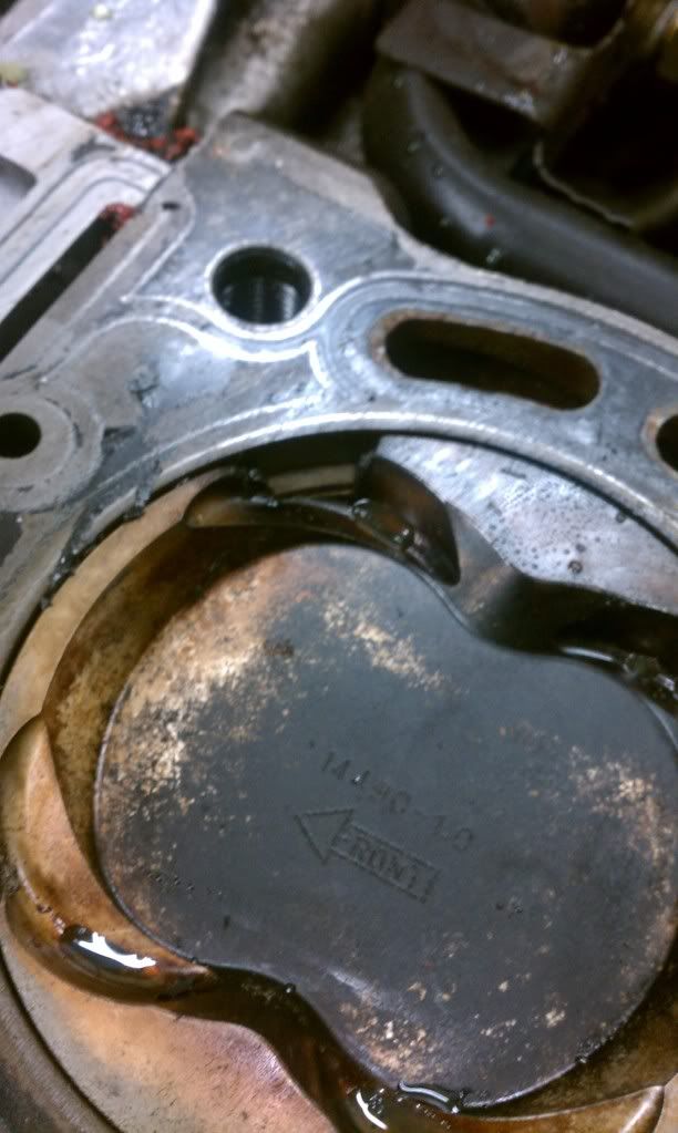

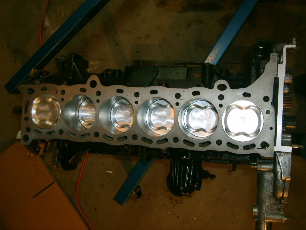

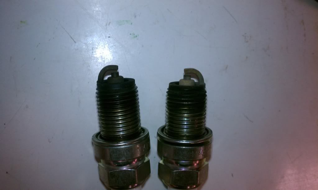

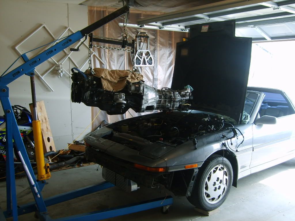

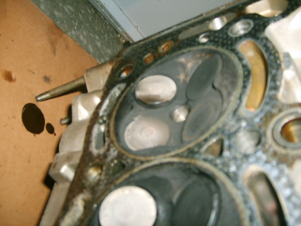

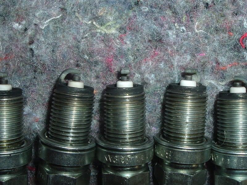

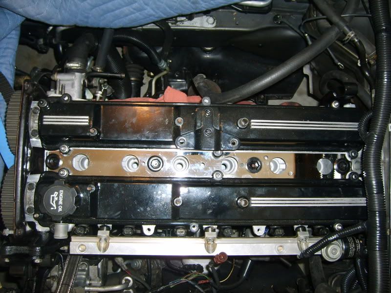

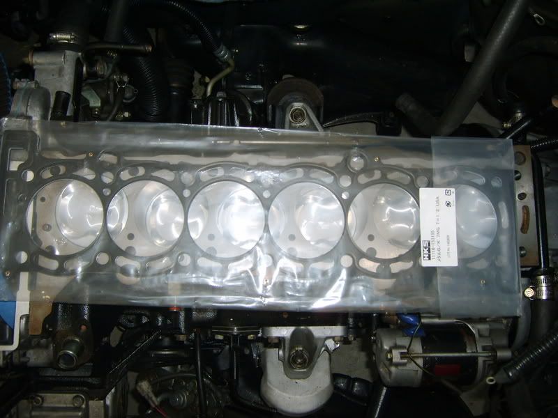

Well after getting about 75 miles on the sup after the cam seals, the 7m just wasn't running strong. It felt like I had a miss from idel to about 2000-2200 rpms. I figured I fouled out another spark plug so early last week picked a new set up and proceeded to remove the old to find this...
The left one (dark) is out of #6 and the right one (white) is out of #1 !!!.... Something is not going on just right.
Took a compression check and it confirmed the bad news. (recap for any one who dont know, on the 272 cams Im running I was 120-125 psi on all cylinders on the new engine.)
Readings were this front to back, 1-6. 135, 120, 100, 80, 60, 50....

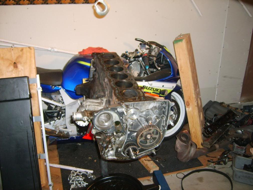

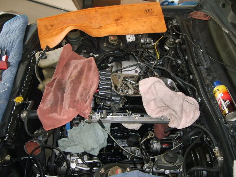

Once I saw those readings I knew the head to come off for inspection (was hopping for the metal head gasket to be blown between cylinders since there is no oil/coolant getting mixed or lost... That was last night.
Hundo stopped by not knowing what was going on. I told him what was going on and he wanted to lend a helping had in removing the head. We got the head off and confirmed the head gasket was blown.... between EVERY CYLINDER!!!!

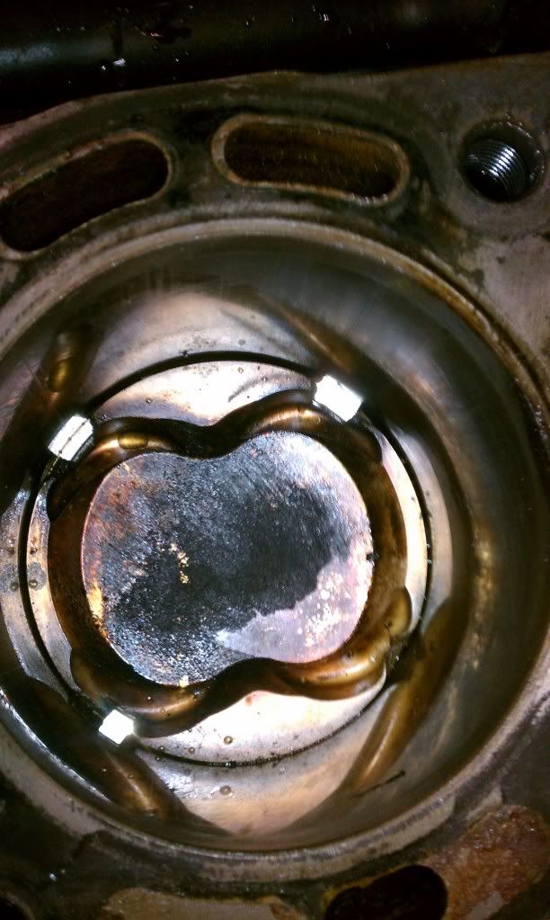

Started to look at the pistons and bad news. 23 of 24 of relief cuts in the pistons for the valves are burnt out. :cry: Also Im surprised there wasn't piston slap. Now I didnt check the piston to wall clearance when I got my engine back from my builder (recap, I went .040" over) , but right now I can "wiggle" every piston. There is over .025" clearance between them!!!! WTF :( There is no scoring on the boars of the block so it might be reusable at least. Further inspection is needed. Note to all: It dont matter how good your builder is, or what credentials he has, CHECK ALL OF THERE WORK!.

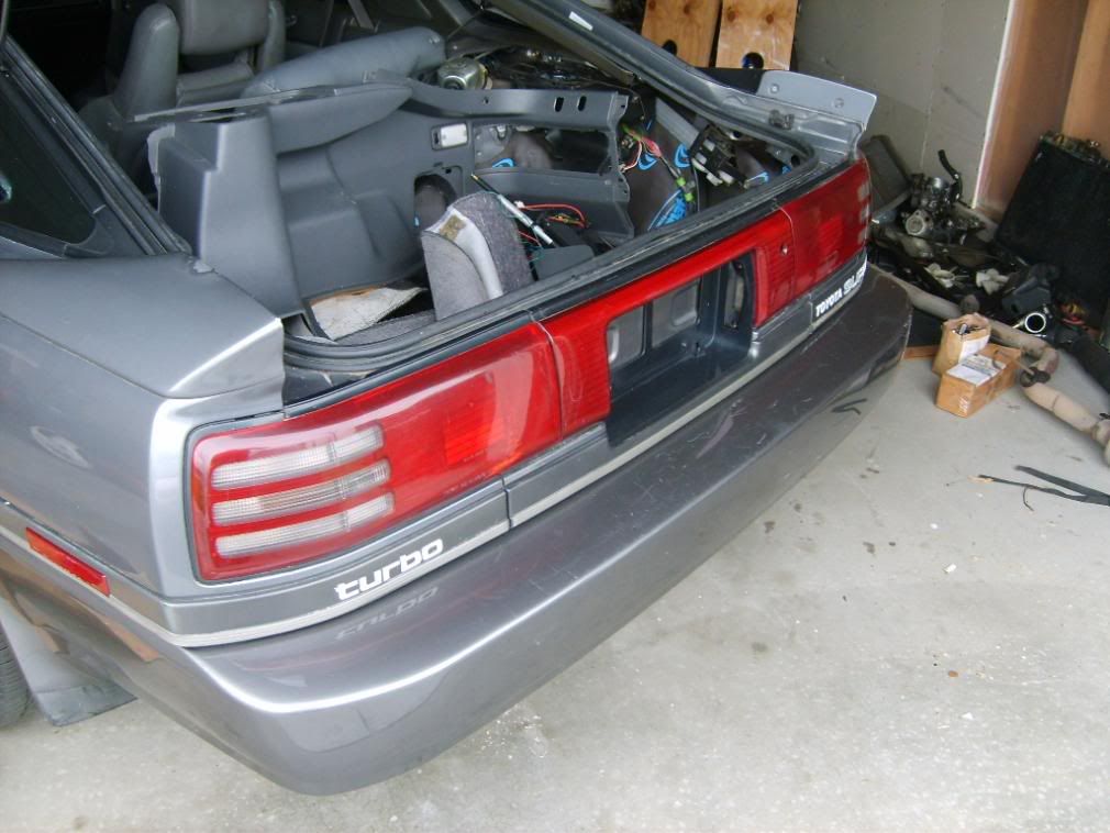

Well since I was in high school I have been wrenching on 7m's and supras. After spending 13 years of time and several 7m's this was my last hurrah on 7m's. Had a no limit budget on the engine build and still failed so Im calling it quits. Don't really want to but time to move on. If anyone is interested in some parts or the shell let me know. This shell is very clean, several people

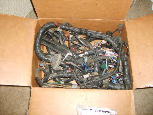

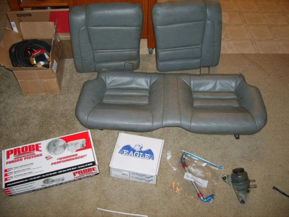

I will be starting off by selling some of the parts I never got around to installing or extra parts I added to my supra like; Fields harness, 6" front door speaker pods, AFX wide band, mk4 TT fuel pump, euro folding mirrors, turbo R brake ducts, hatch shade, ect.
I still have my 04 CTS-V and 07 Escalade ext. So maybe its time to make the V, the new summer toy and further pursue the next toy I have been looking for. 1994-1997 Scarab 26 boat with a 502 mag... I few pics since I never posted about the esky

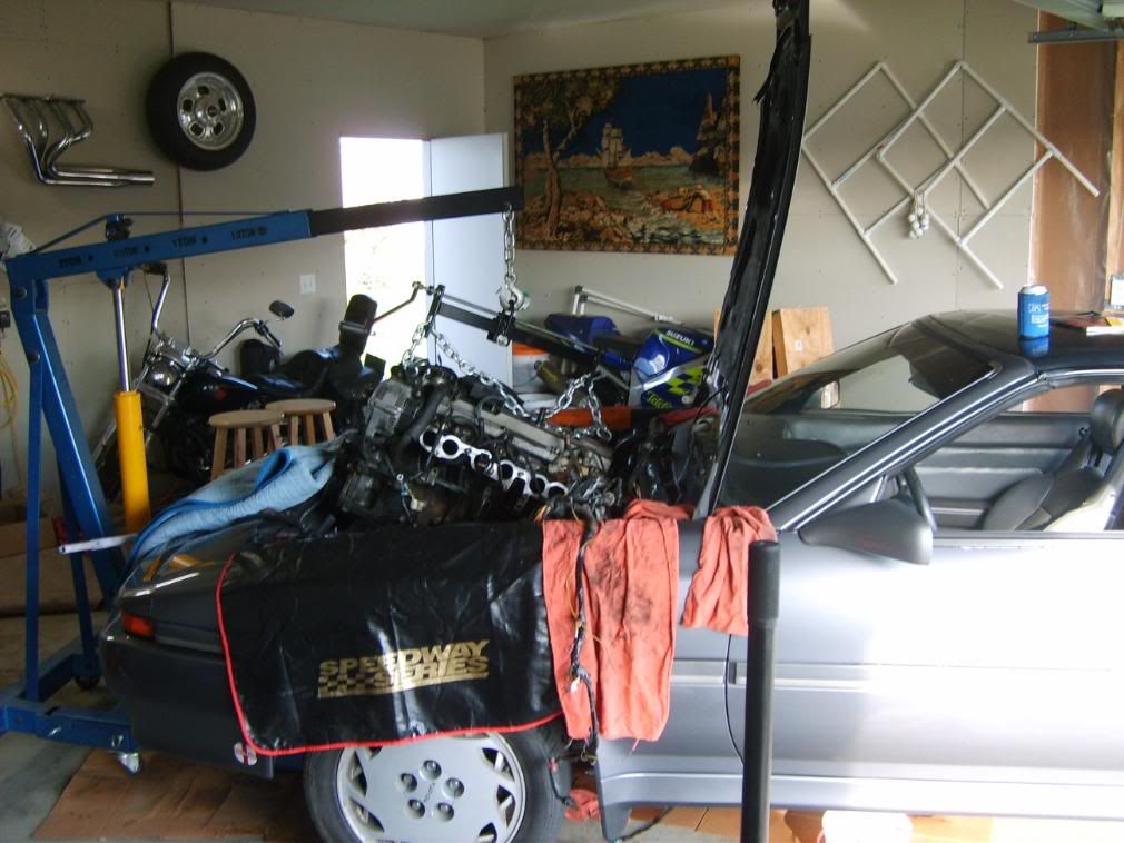

Well I don't want to end the post on a sad note so here is a pic of Mr. Blue in the sup as hundo and I were removing the head last night. He wants to go for a ride :)

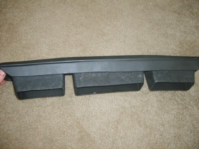

Emilio, Sean and I were just wondering about you last night. Sorry to hear the news. Damn engine builders. I am interested in a few parts. For anyone who is interested, this car is immaculate. I would like the to buy the front under bumper piece, not exactly sure what it's called.(If it's for sale) I know you got one of the last ones. BTW, the guys are working on Dan G's Supra today and Sean is working on mine. I hope we can attempt to start her this weekend.

^ Dan, You mean the front lip spoiler?

Victoria BC
prob pistons there all mighty weak spot showed
ps you leaned out nothing to do with fitment
this is one big huge reason I do not like prob pistons they have massive vavle releafes that are just not needed since the biggest vavle they make is like 1 mill over
Yep
Yes it might have leaned out, yet never was over 11.5-11.7 A/R under boost. See dyno sheet early in thread. If you see them personally, you can see they "burned"(not sure if that is the right word) form the out side in.. If you want to tell me that having over .025" piston to wall clearance was NOT a contributing factor when it should be .0015-.0045 MAX according to Probe Ind. , umm...... ok..., have your engine built with over .025" and see how it goes :)
In all reality it don't matter how they failed, rather that they did fail and now I'm moving on. Jim Hall can not build a bottom end to save his ass, (well documented now) but on the flip side he can build a head at least. :)
