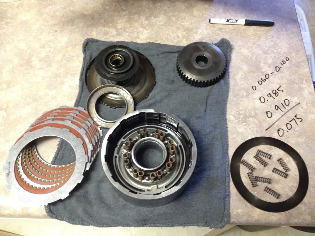

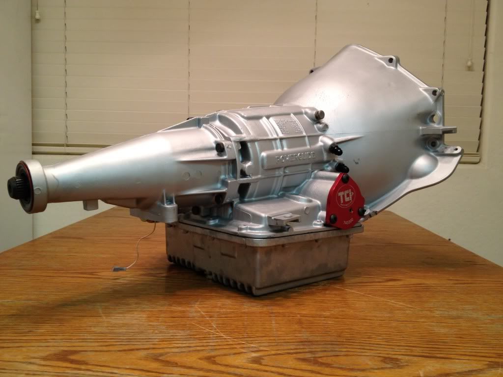

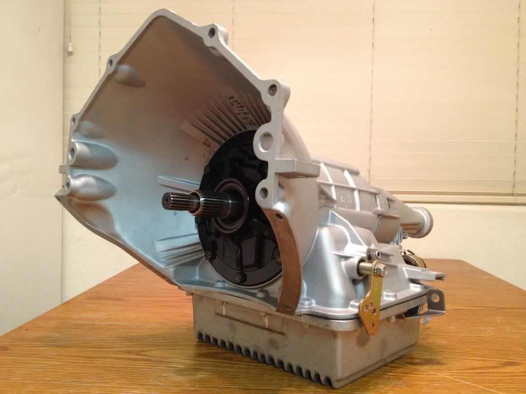

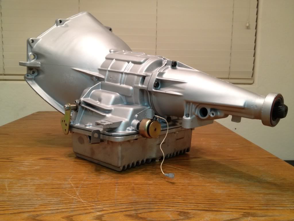

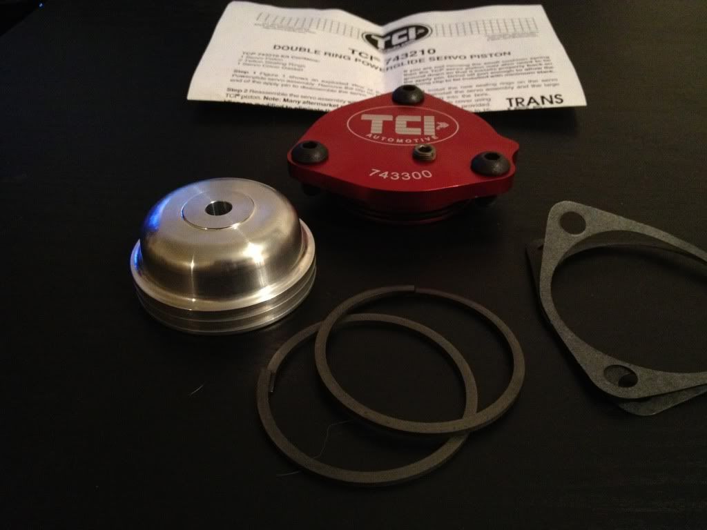

Finally have time to update.
That tranny I just built I cant end up using cause all of ATI's are based off the 9" tailshaft and 31 spline output shaft.
Luckily my other one is the right now, and actually did some decent mods to it. Only kind of down side is this one is a 1.76 vs the old one was a 1.82 gear ratio.

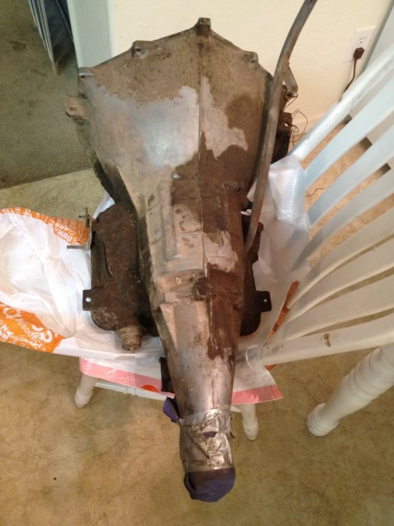

Before
All clean

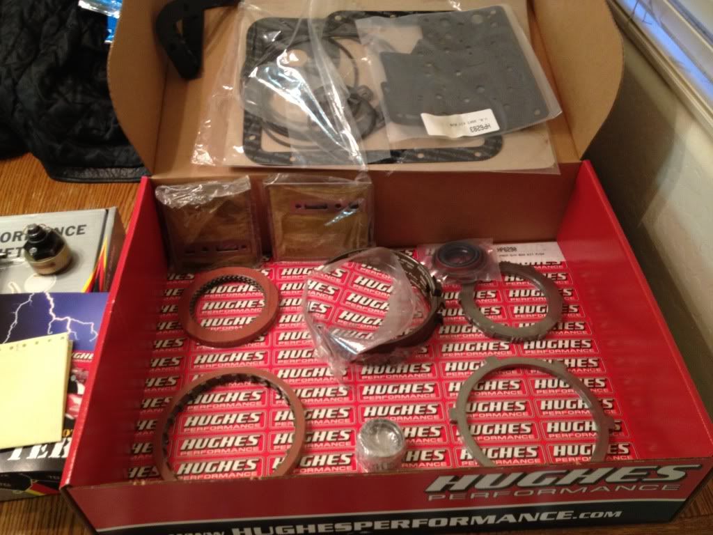

Hughes Performance rebuild kit, kevlar goodies
Reverse piston air bubble mod
ATI HD Reverse springs (helps with harder release on transbrake)

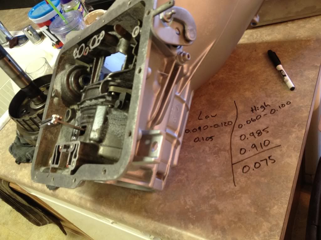

Clearance reverse clutches, wave spring delete, added 1 steel to make up. 6 clutch and 0.105" clearance

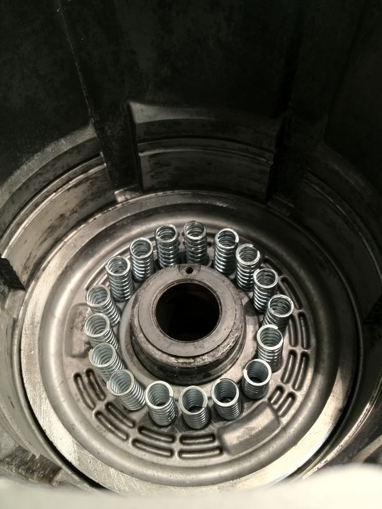

High drum clearence, added 1 clutch set, wave spring delete, took out 8 springs, 0.075" clearence

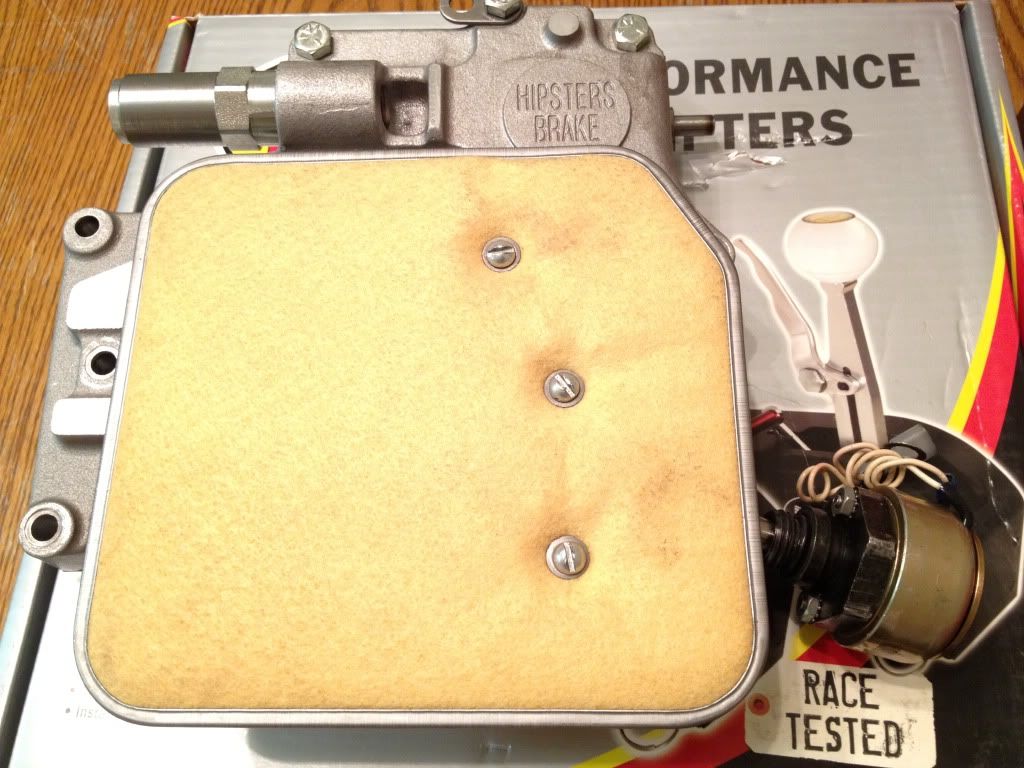

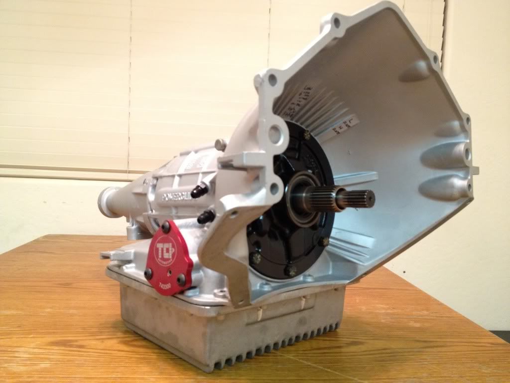

TCI Aluminum Transbrake 48% lighter then stock, high flow 360 filter
TCI Deep aluminum pan
TCI Billet servo cover & double ring piston, dampener spring delete
All done

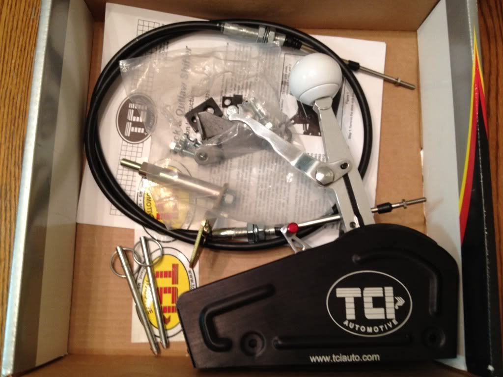

TCI Shifter with reverse and neutral start switch, as well as trans brake button
