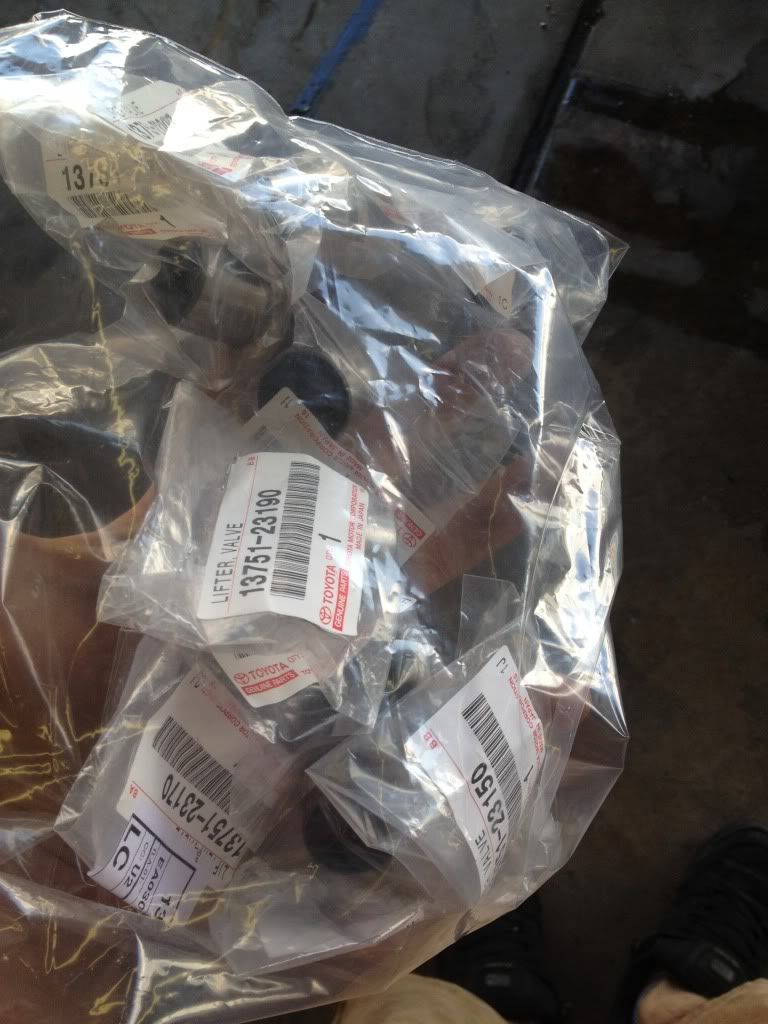

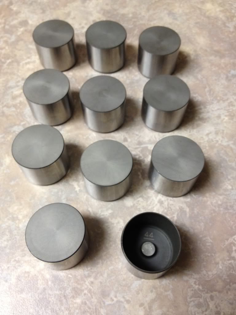

Have time to post updates. Have gotten a lot of motivation then just failed again. Finally got my shimless buckets to wrap up my head. Stil waiting for my spacers from rich as well as my replacement cam gear from Titan.
After install decided to do a leak down before I put everything together, come to find out all my intake valves are leaking as well as 3 sets of exhaust. FML so bad, right when I finally have everything to wrap up my never ending head/money pit. Someone's getting a nice call tomorrow.

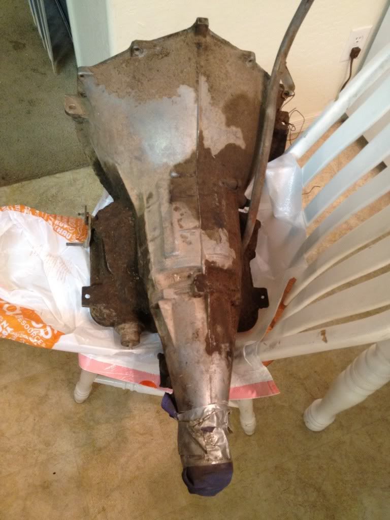

On to actual productivity. Picked up 2 powerglides for $140
#1
#2
Little bit of work and they will be back to new again. These arent going to be the trannys I'm using, more of being able to buy the adapter plate, make tranny mount, driveshaft, shift linkage, cooler routing, and what ever random things come up. Will wrap up a alot before I shell out the $3500 for tranny and converter I need.

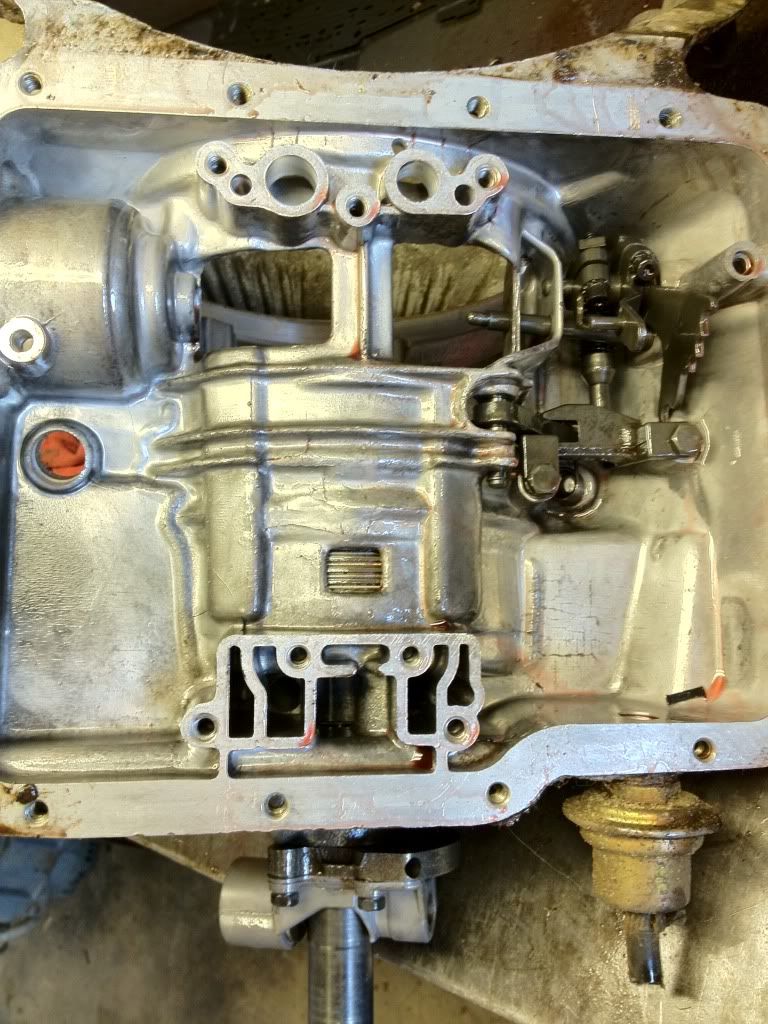

Some presents from Transtar came, full rebuild kit with bushings $80
All ripped apart and ready for cleaning/rebuild
More to come with that once my special goodies come in as well as washing the case tomorrow.

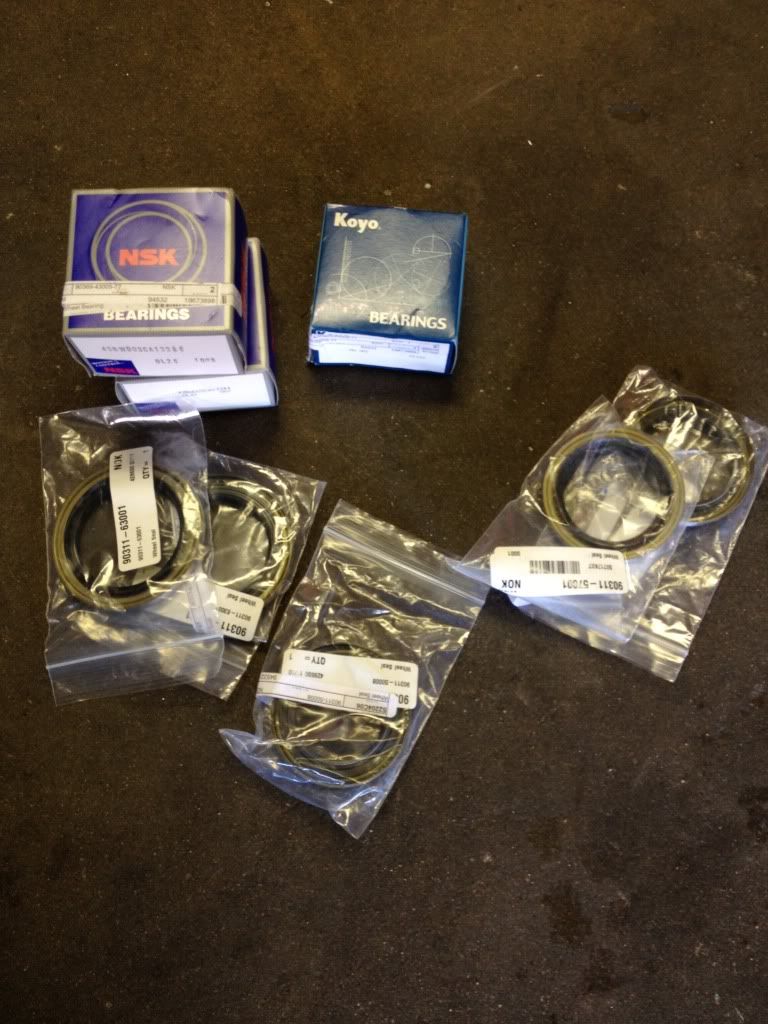

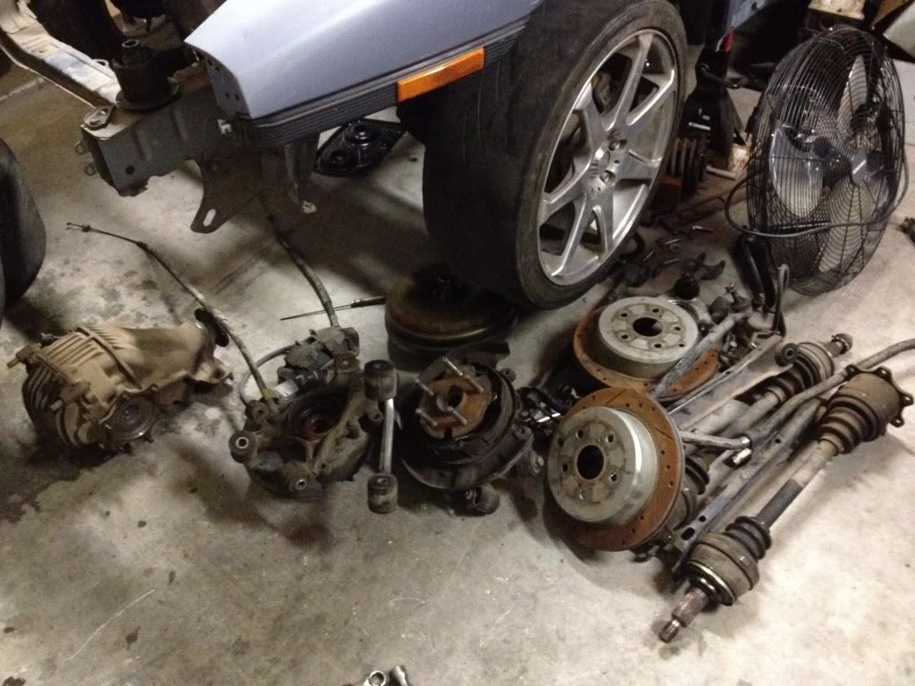

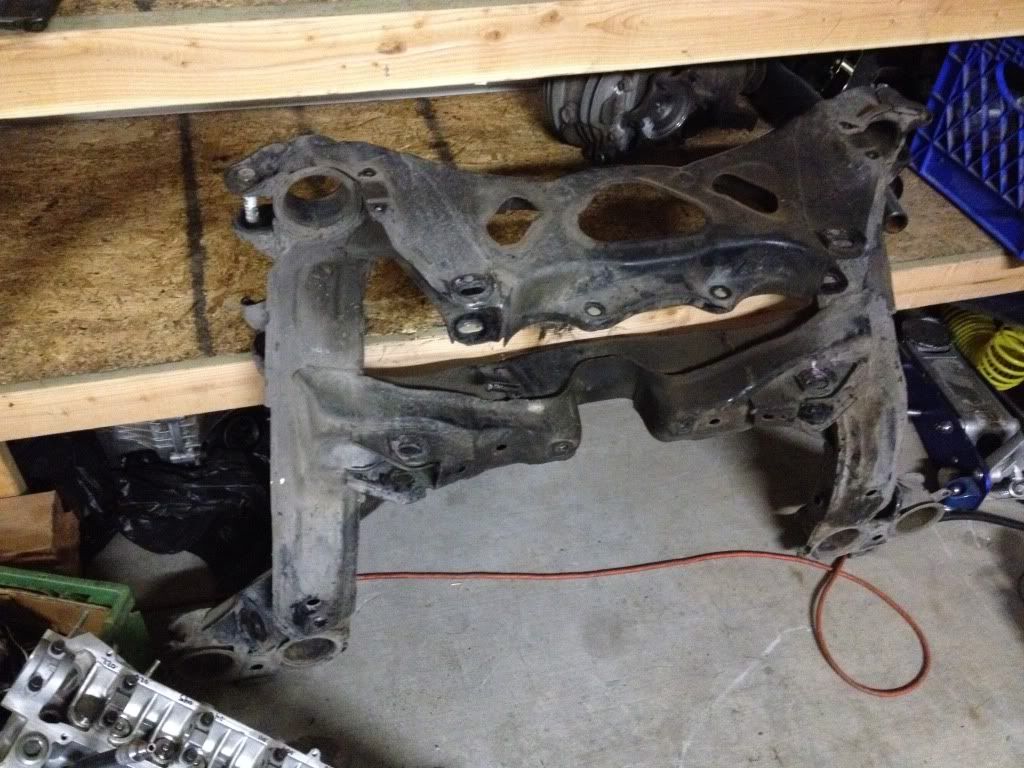

Tore down my rear subframe in prep for the new bushings. Cleaning, painting, new wheel bearing/seals, and spherical bearings, as well as possible rear bbk.
