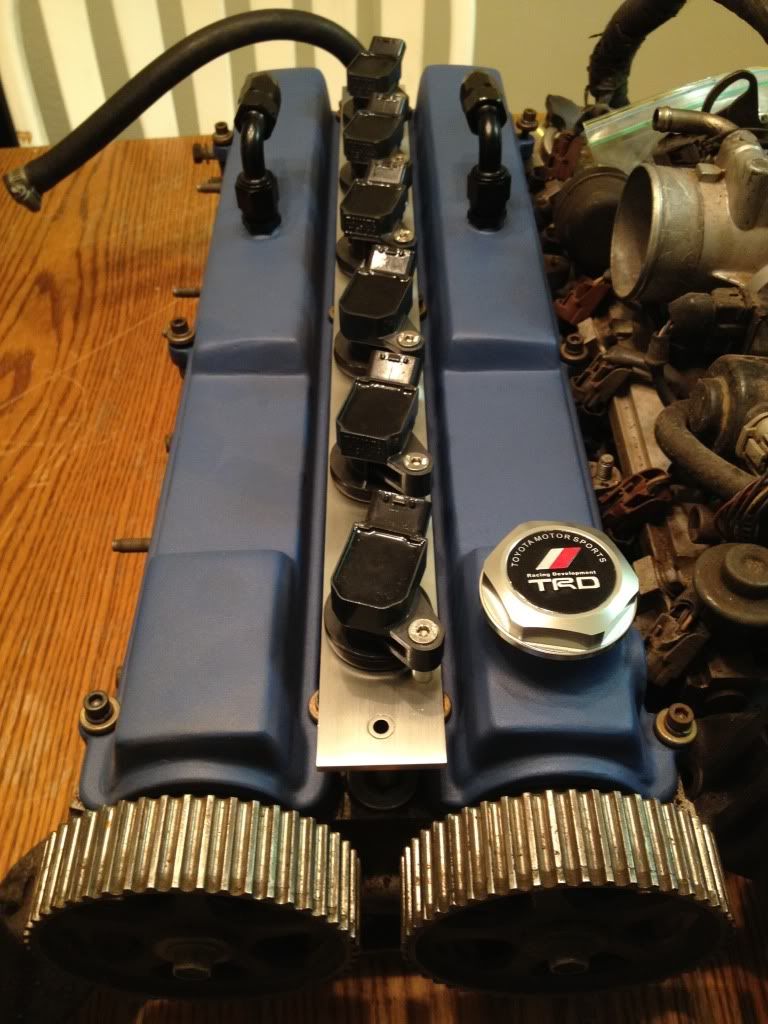

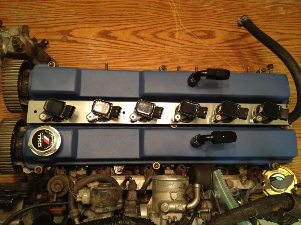

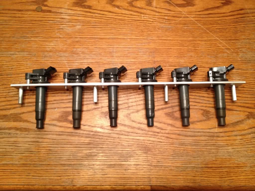

Got alittle done tonight on the spark plug gallery plate.
Tubing came in, got the right drill bit. Cut all the tubes, deburred, pressed in plate .005" fit and set all the lengths. Sanded everything back down now I just need to counter sink the holes once i get screws.

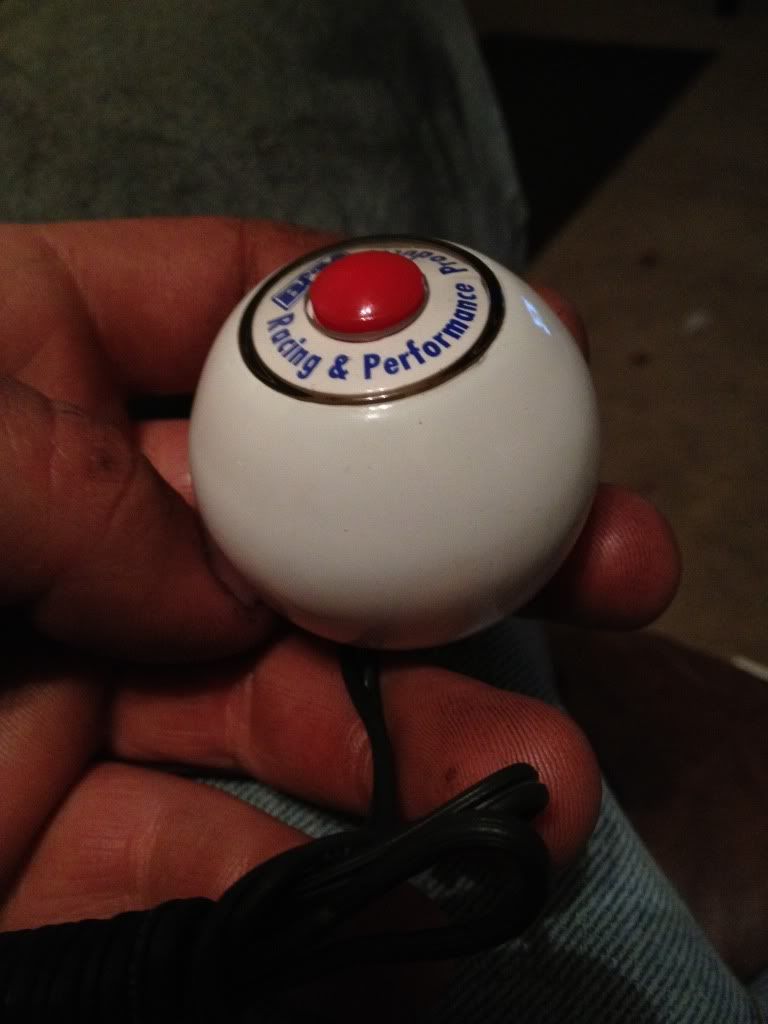

Got my button shift knob

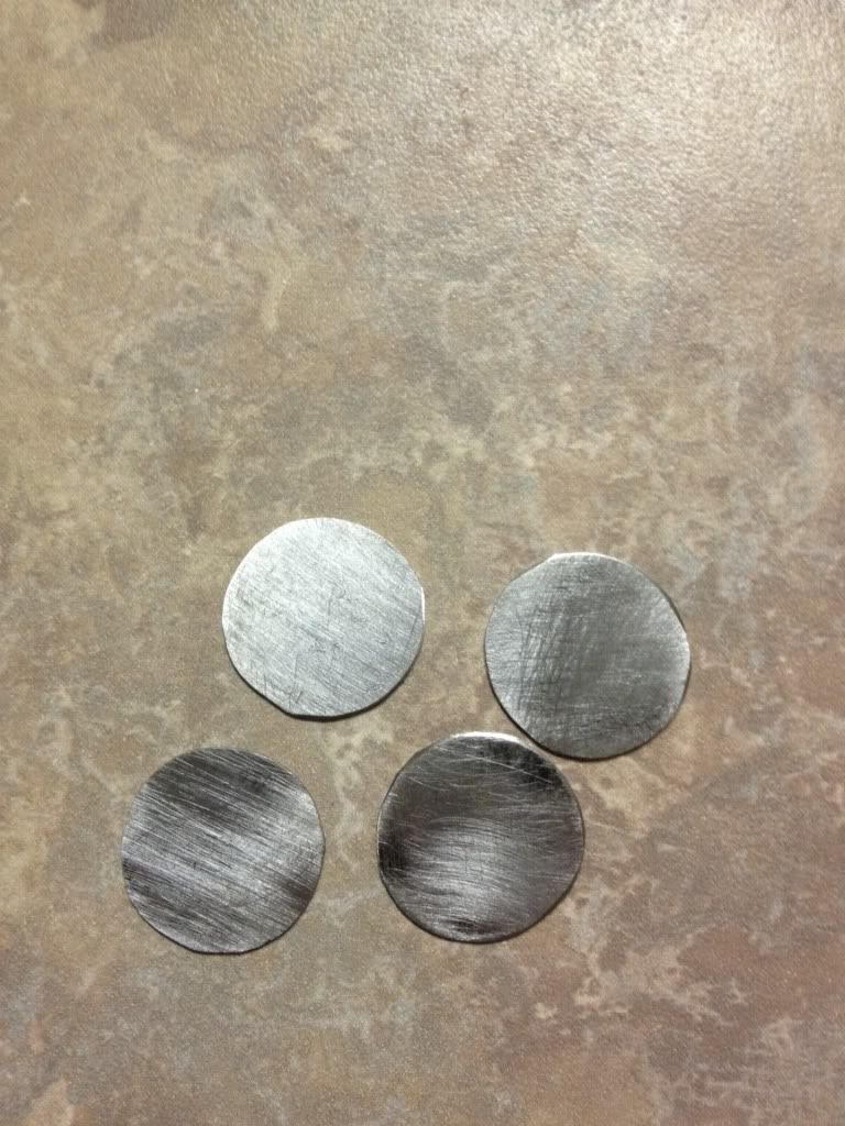

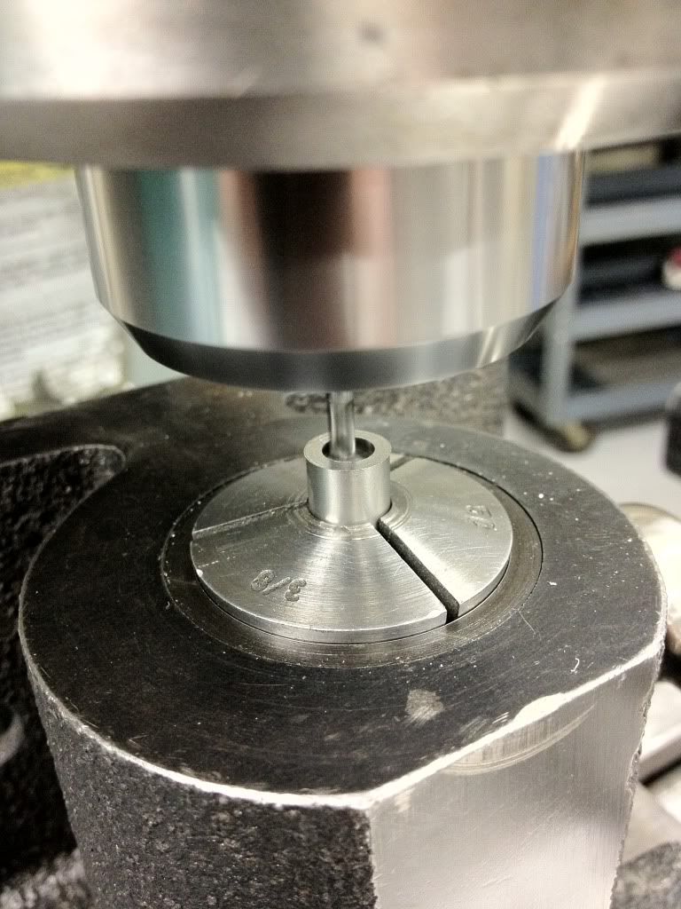

Also got my lash caps from Rich finally..... they are pretty sweet. Nothing like I thought they were going to be. None of them were the sizes they were suppose to be.

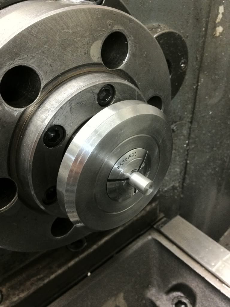

So Albert & I went down Saturday and machined these and lapped them to .025"
Now these are what there suppose to be
[/IMG]
Wtf are those even round?
