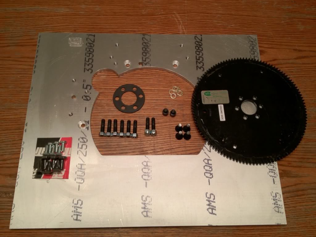

Got one thing in the mail

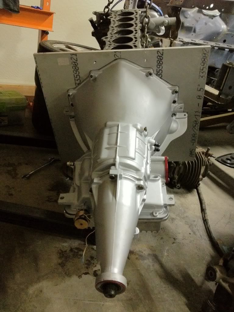

ATI 7m adapter plate/ fits so nicely. Now I need to mock up to get driveshaft and torque converter madeup.

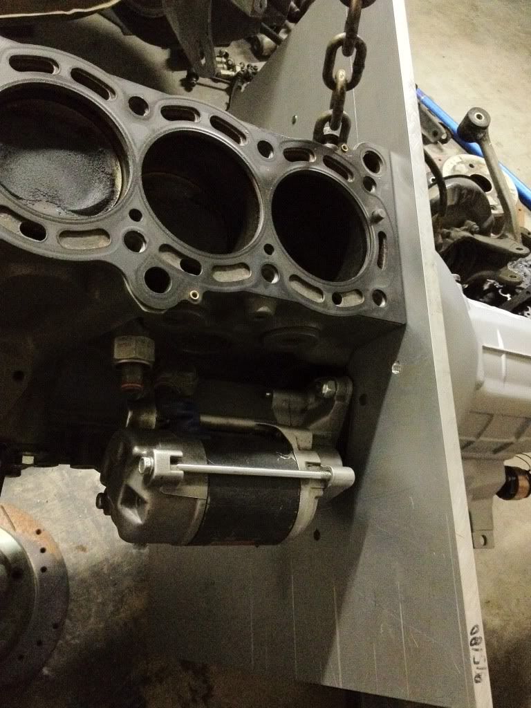

Portial mock up
Starter mock up

Its a 1/2, or at least thats what I measured when I put my dick next to it -_-
oh and BTW, making that plate would have taking 10min on my mill. Im thinking, I should make extras just in case you somehow destroy it =D
stevenr816
Feb 12, 2007
932
Phoenix,AZ
Probably would be way cheaper to buy a plate then would be to attempt to make one. Material alone is ~$100, then add specialty drill bits for correct dowel pin sizing, as well as all screw hardware, taps. Then you have to find a way to find center line of the crank and input shaft. Off by a couple thousands and there goes your $100 material

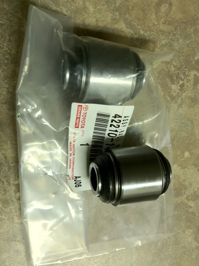

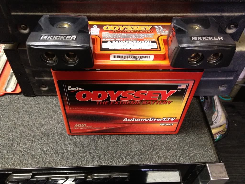

New spherical rear bearings, to get rid of my horrible squeak from making poly ones for them awhile back.

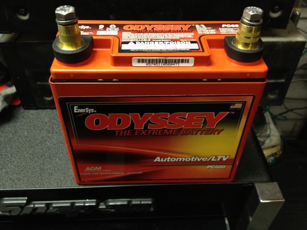

Odyssey battery came in, waiting for the rest of the stuff to follow.

Devin LeBlanc;1783090 said:
We've had so many of those Odyssey's fail. Some are bad straight out the package. We've been using Braille's with no issues since.
When I built road race cars in Utah this is all we used. I've already started multiple cars with it. Word of advice, don't blame the battery till you confirm your electrical system is good. Plus nothing like a 3 year free replacement if your smart and send the warranty card.
On the other hand

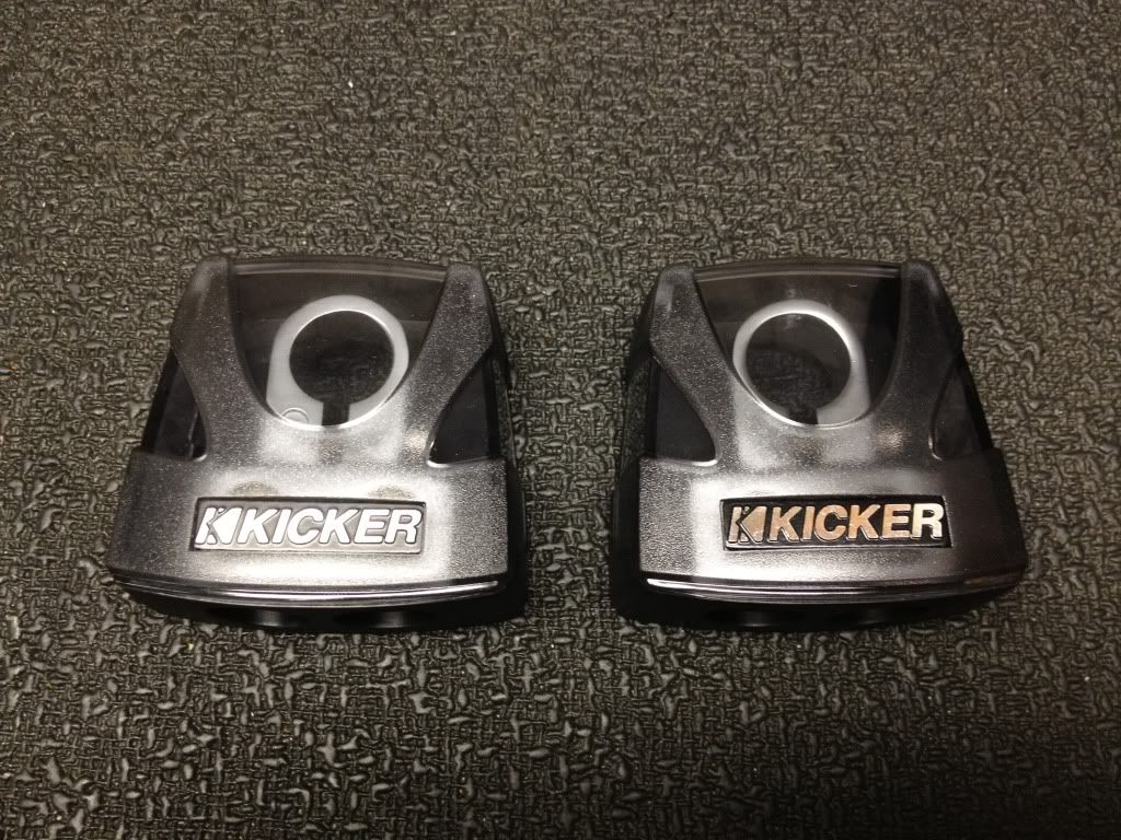

And a late package
x2 1/0 gauge terminals
