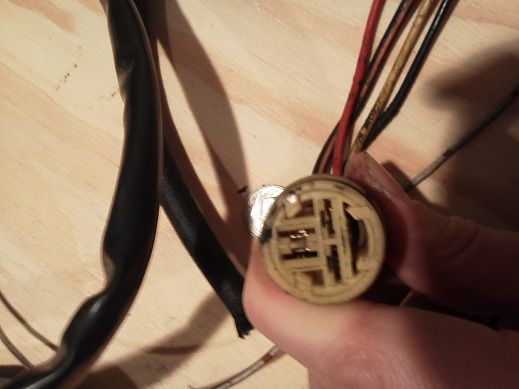

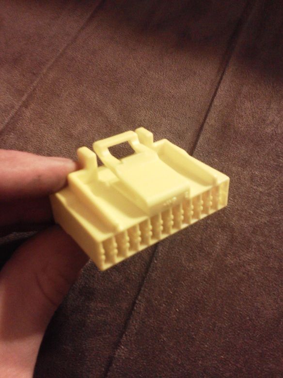

Heyy guys. I joined finally just because i have been trying to figure this terminal crap out on my build. Has anyone figured out the right terminals for the connectors on the inputs, and outputs for the 2jz harness?
i just received my trial order which i attempted to cross reference part numbers, and i think i have the right connector terminals. they slid right into my new cam sensor connector housing. Im excited so far, i can post pics and info tonight if you guys will find it of any value.
