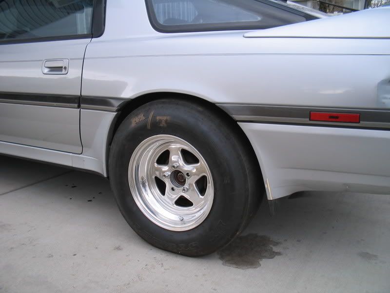

Tun_x said:
welds 15x10 with a 6.5" backspace and a 28x 12.50 slick.. mmmmm thats the good stuf..
This is th tire that you will need to go faster than Duane
Dood ..I am Lovin That look..Any rubbin on the rear fenders ?

Tun_x, are you lowered? It doesn't seem like it but I'm trying to gauge how a 27" tire would fit on a slightly lowered car.
Those tires look good though. Any videos of you at the drag strip?

27" will work w/ eibach springs. its real close tho, but still doable.
jag- 26x10.5x16. full on slick you will need one step lower on the width (slick is measured tread width, not section width)
I'm slightly lowered ... I'm on D2 coilovers so I have allot adjustment... No videos yet .
