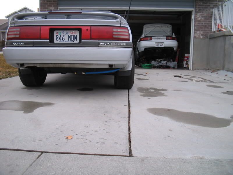

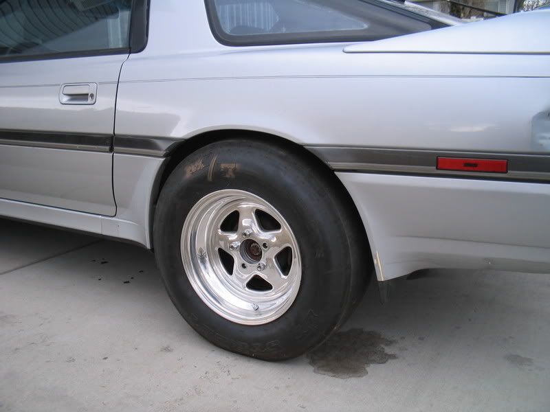

so what are the biggest wheels/ tires you can go with on the rears without having to tub out the back end. i was looking for something on the 15in rim, but what is the fattest and largest sidewalled tire & fattest rim you could do on the mk3?
Tun_x
Built to do the NASTY!!
878
Utah
welds 15x10 with a 6.5" backspace and a 28x 12.50 slick.. mmmmm thats the good stuf..
This is th tire that you will need to go faster than Duane
Dec 3, 2003
6,653
Canada
LOL nice comment Jason :biglaugh:
Hey! I would rather go a little slower and have my car sit level. Not like a 4x4 :icon_razz
How much the set run you? and I assume you can't lower that as they look like they stick out.
