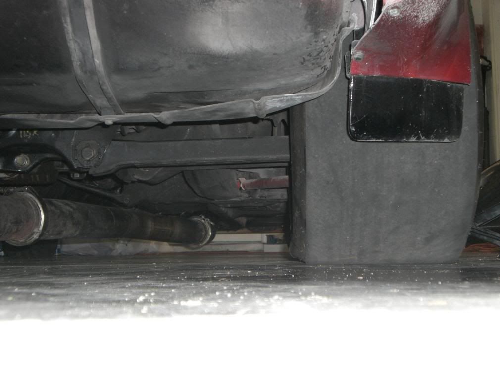

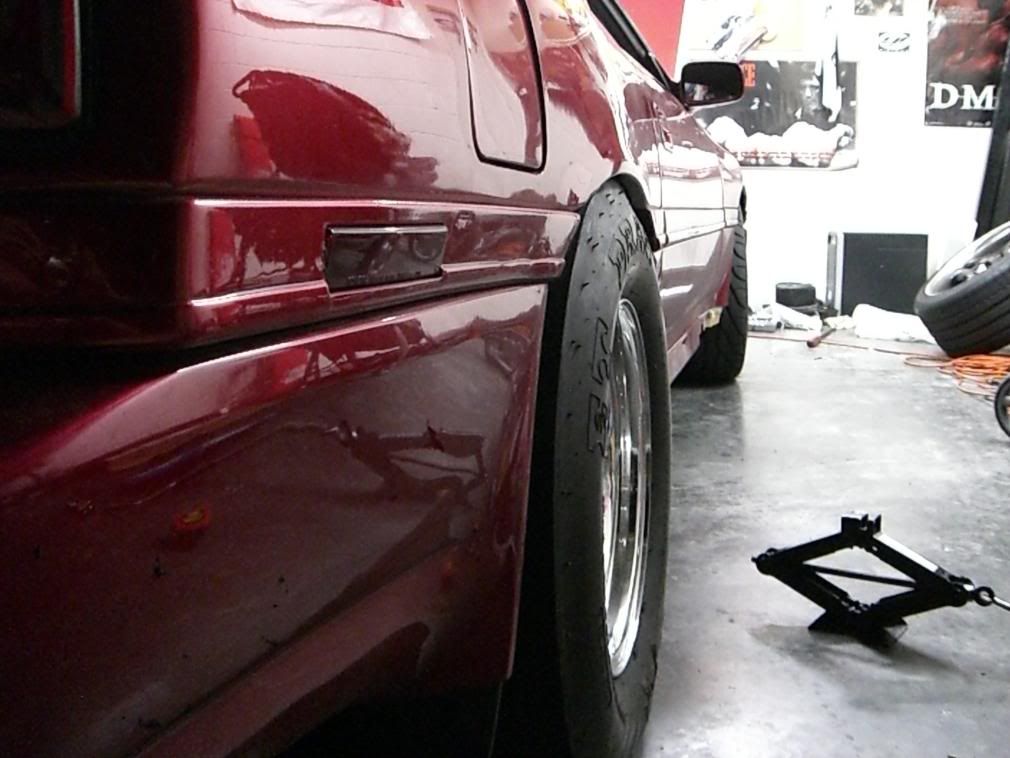

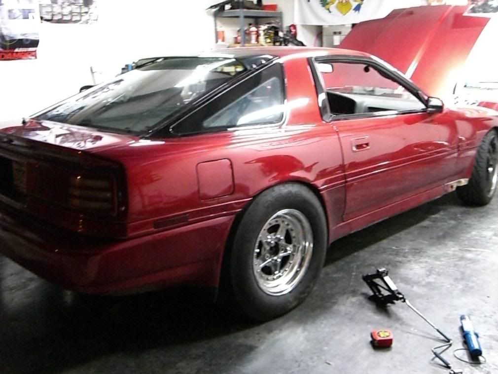

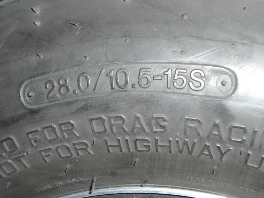

so i got wheels and tires to fit..
15x10
28x10.5x15
i love it when people say things wont work, or wont fit..... this is no body modification, i have to roll the fender some more so they wont rub, and lift it up a bit before i take it to the track...
