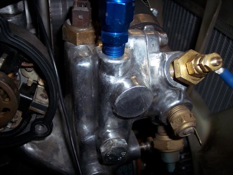

Is this the one you need?
92nsx
Sep 30, 2005
2,957
Clearwater, MN
Depends if you have the correct thread size / fitting or you just made the npt "work", but yes that would be the one.
BTW npt=27 threads per inch & BST= 28 TPI. the 7m uses BST

Yep IIRC that is also what suprasport uses, and is the wrong size. That is why Jake stripped out the fitting / his water neck. You have seen the destroyed fitting at my place. Also who long did you drive / run the engine that it didnt leak a drop?
