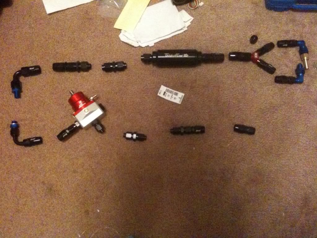

Those fittings are all connected to each other, this is what they look like apart. This is what 257.71 in fittings looks like. The braided sections were another 56.90, Plus 41.90 for aluminum tube ($356.51), Plus AFPR & Gauge, flare tool, Pump and shipping. Yay!

upgradedsupra;1439012 said:
why all the extra fittings, I have half of those.
Duane
Im running aluminum lines with a union in the middle for ease of installation and repair. Thats what its going to take.
You have an a1k right? Braided line to the rail? Thats alot less fittings, but more money overall for the line.
Pic of it aranged how its going to be set up, The "Extra fitting next to the y-block is a cap as im not going to be running a second walbro for a bit but i still needed to adapt from -6 to -8 so im running the y-block with one post capped for now. Also since im not running dual walbros now one of those bulkhead fittings i have set up for feed will be used for return. Also realized i ordered 2 extra nuts and sleeves for -8 and -6, When i ordered two i didnt realize it was pairs. :aigo: good thing there REALLY cheap haha.
A1K??
Why add the extra work if you can use one single pump and less fittings etc..To each is own though. :)

upgradedsupra;1439195 said:
A1K??
Duane
Aeromotive A1000? I would like to have run a single pump but couldnt find a single pump that i could easily use that will support 600hp.
Problem with the A1k is that it needs to be gravity fed and im not looking to go fuel cell or sump the tank. Also noise is of SLIGHT concern, and Aeromotive doesnt offer a single pump other then the A1k that can support 600hp. I needed an intank solution and either dual walbros, or a walbro and 040 fit the bill. Id rather have a little too much pump then have one pump about at the limit.
One pump will be activated with boost so i wont be needlessly pumping when im not in higher boost levels.
I don't run that pump anymore, I had to step it up. I now run a Weldon 2345 (supports 2000 HP) You didn't look hard for single pumps that support that number.
You do not need a sump, you can run a line at the bottom tank. (add A&N fitting to the tank) Ron, and Nate have it set-up like that, easy.
Aero makes the A1000 and an Eliminator pump. XS also makes a pump that would support that number. They are a tad noisy but EASY to find a single pump that supports 600 hp. ;)
You can have it so the pump doesn't pump full at all times, don't assume you can't ;)
IMO single makes more sense since you have less to worry about going wrong. :)
Duane
I know theres single pumps that support that number, but those werent for me. I had thought about running a line to the bottom of the tank into the stock pump location but i didnt like the idea of it possibly becoming un submerged while turning or something, i feel better having the pump actually submerged in the fuel where it can prime it self quickly. It also says it could shorten the pump life not having it sumped or fuel cell-ed.
I was actually going to put an a1k in the tank as it would be perfect but i don't think it would fit :icon_mad:
I was going to PWM the A1k (if i could use it) using and output from the 8860 and was going to use it to PWM the walbro but ive read the gear-rotor design of the walbro makes them not a good choice to PWM. Ive read it chews up the rotors from the on/off cycling :dunno:
By all means i would like to run a single pump but i want it to be and in-tank pump and one that i can more easily control.
Dual walbro or walbro/040 will work for me and be pretty easy to set up. Its also tried and true.
Im not dissagreeing with you at all Duane, but this is just the solution ive come up with as something easy and readily available. Also its nice because i have one walbro now, so to upgrade i just add another and plumb it in. :naughty:
