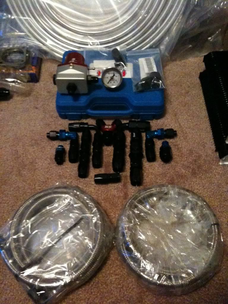

Im going aluminum -8 feed and -6 return lines as its MUCH cheaper then braided stainless. But even still i have about 200 dollars in hose ends and fittings to make it work along with 6 foot section of -8 and -6 braided to make flex sections to the motor and fuel tank.
Over all budget fuel system cost about 450-500. with a single walbro, and aeromotive AFPR, Havnt added the second yet as im still getting my car together.
