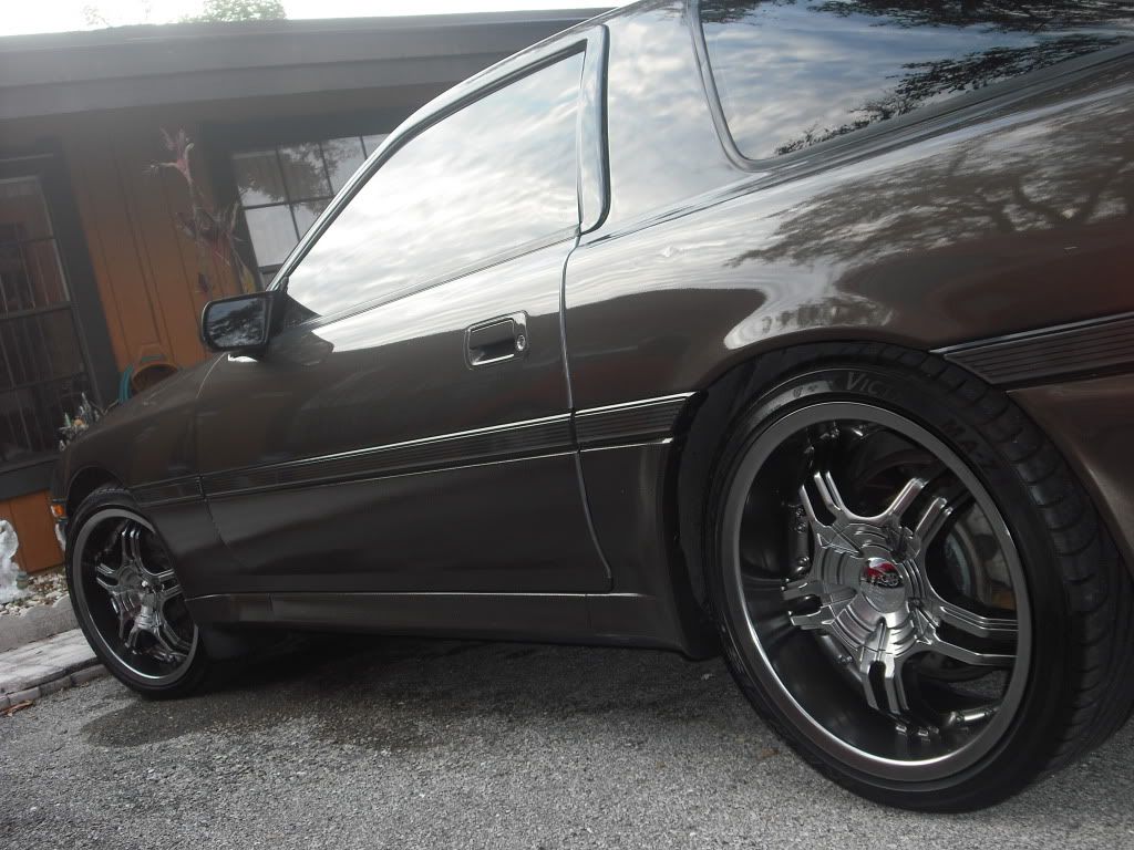

xzeror
Oct 18, 2009
1,356
Miramar, FL
Suspension Tech lowering springs, Tokico Illuminas
Ruff Racing R930's in Hyperblack
18X8.5 front, +38
18x9.5 Rear +45
These tires came on the car, dont really like the stretch looked 235/35/18 front, 255/40/18 rear.
Was wondering what size tires would fit the car properly?
