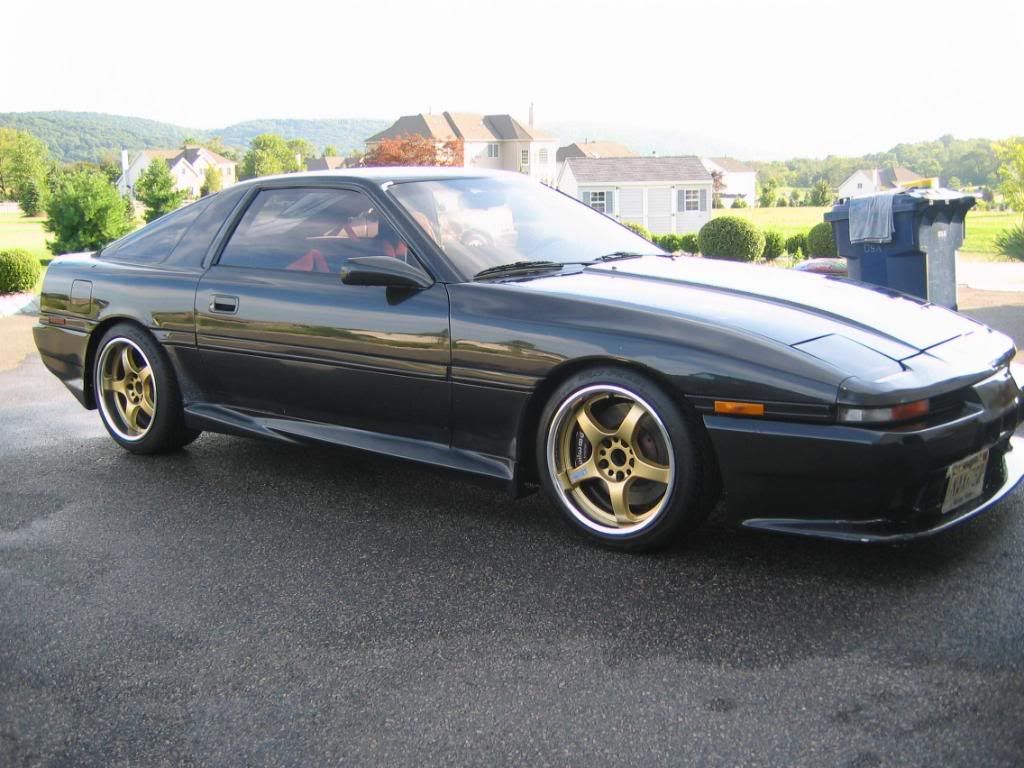

I have Kosei K3 wheels, 7.5j x 18", ET35. I have plan for 225/40/18 on all 4 rims, since it is daily driver, non turbo, bad roads, and don't want to roll fenders.
I have plan also to lower it with some aftermarket kit, more springs then coilovers, I suppose it will fit....?But does anyone tried this setup?
I expect to get this:
BorHor
2JZ-GZE
Jan 10, 2006
6,181
San Jose, CA
That combo will fit with out rolling your fenders. It would actually sit similarly to stock MK3 wheels.
