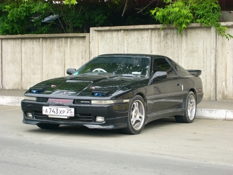

86andhalfWhiteGirl;910573 said:
Thanks for reading and posting if you do.... oh and post some pics if you wish also.
That is all. Good luck.
