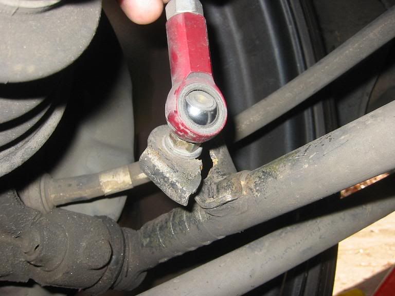

...For the rear swaybar endlink tabs?
Was just replacing my differential, and when I climbed under the car, I noticed that my left read endlink mounting tab was busted clean off. I know that some people just weld the originals to reinforce them, but have also read(don't remember where) that others use a new piece of steel of greater thickness. Do you guys just cut a thicker piece of metal stock, or did you use something pre-existing?
Thanks.

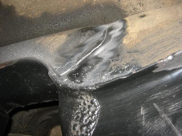

Here's my busted tab:
And another gem I found while under there:

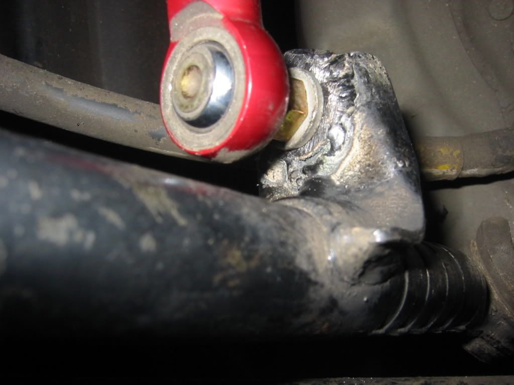

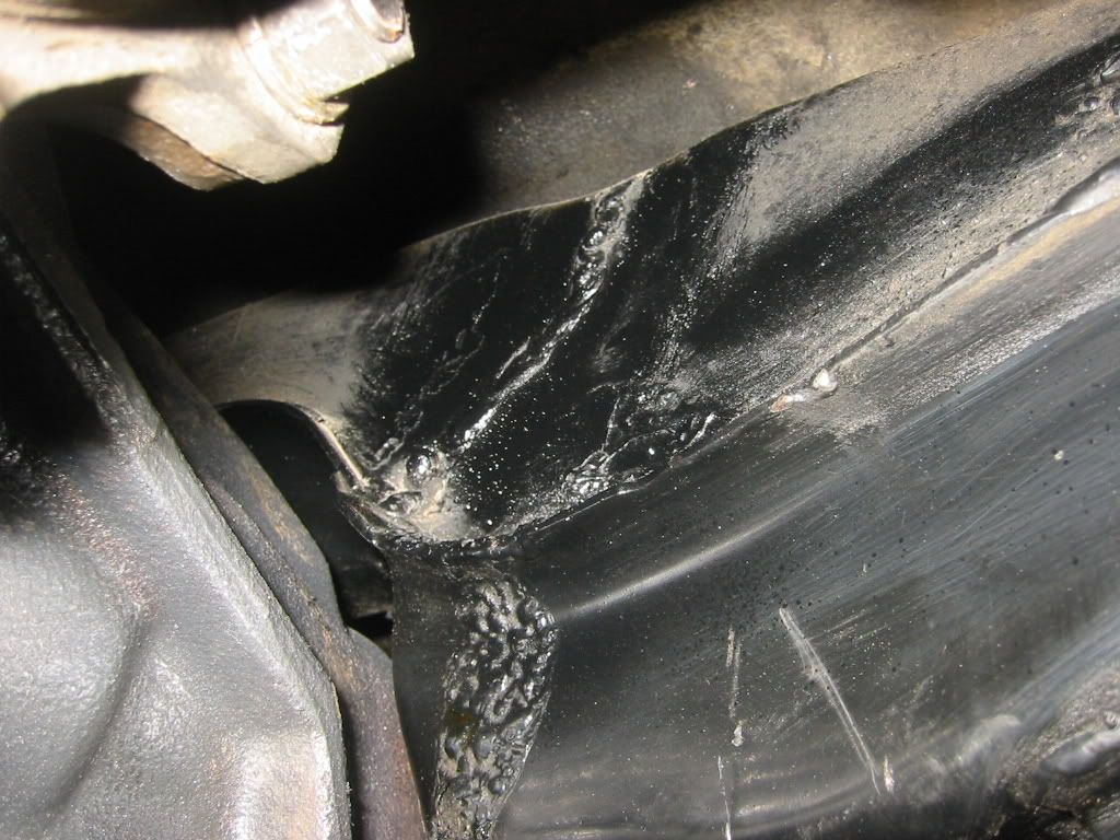

After cleanup:
New vs. old:
So now I HAVE to get a guy to come over to weld up this crack before I put the other diff in- Luckily, the crack did not continue to the other side of the subframe- it's only about 4 inches long.

So my buddy is driving across town(true friend) to weld this up for me.
I also removed the control arm, and am going to have him weld the tab back together, and reinforce it with a washer welded to each side of the tab. Hopefully, that'll give it the strength it needs.

Thanks Poodles- I'm going to try the double washer reinforcement, and see if it'll last. If not, I guess I'm headed to BIC. The diff is not rebuilt really, as I didn't mess with the clutchpack, or the bearings(they seemed to be in smooth, quiet shape). All I did was replace the three seal and check/adjust the pinion preload.
