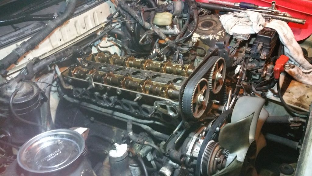

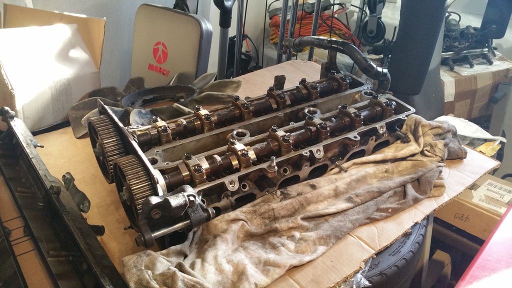

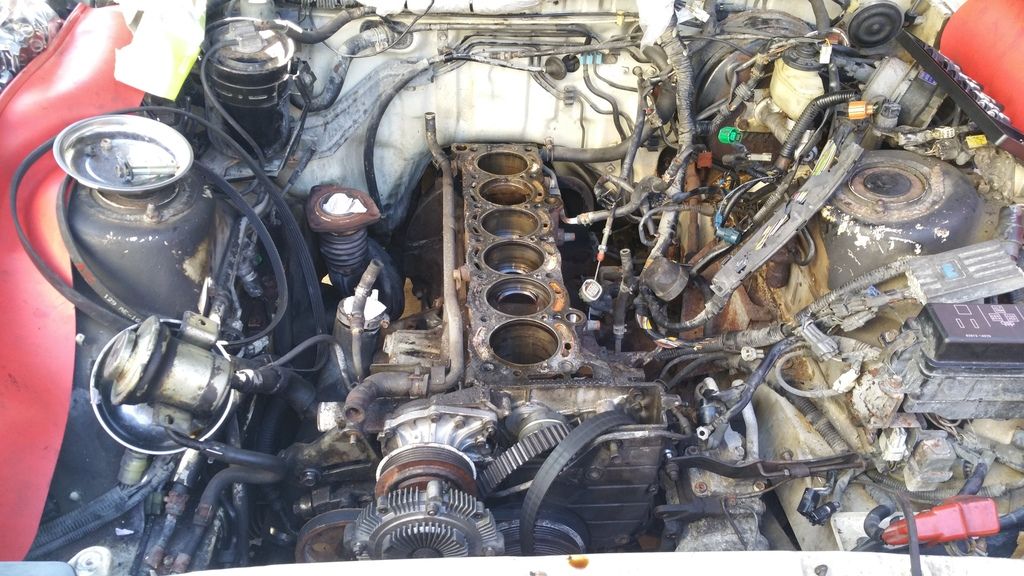

George_Bonilla;2046325 said:
Pulled out the ct26. Took me forever, never seen so many seized up and rusted bolts. Nuts getting ruined and bolts snapping everywhere.

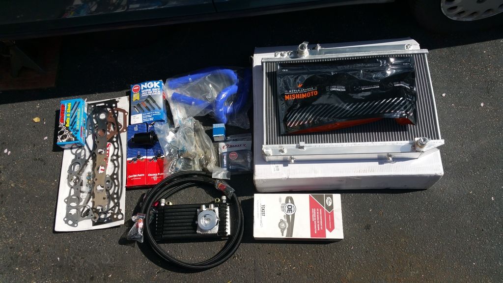

Doat;2046673 said:
be careful when breaking loose the head bolts I had one strip on me, so I had to get a slightly larger allen socket, dremel down the sides a bit and hammer it in to break the bolt loose.
Thanks for the advice. Mine have been there for 26years, just glad you were still able to get it out. The head will surely be happy with arp replacements properly torqued.
