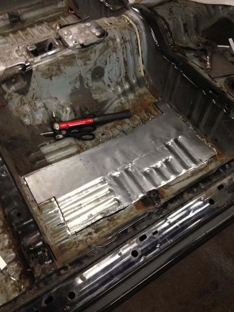

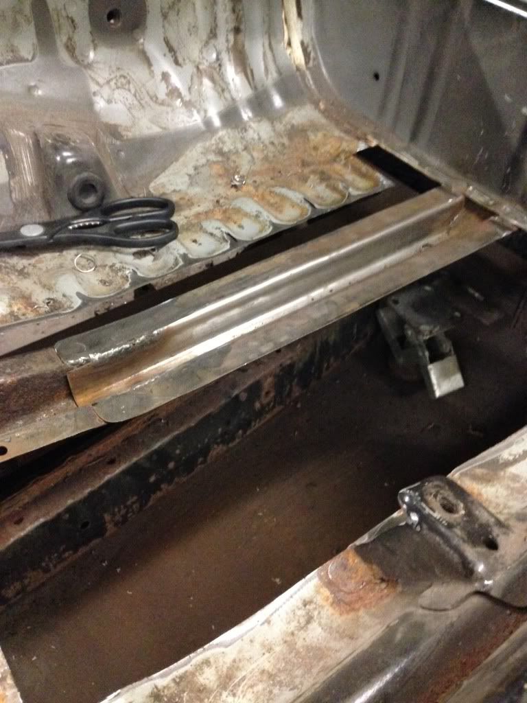

Fabricated and installed a new frame rail and made up a new piece for the floor. Tried to get as close as I could to original.

nice^.

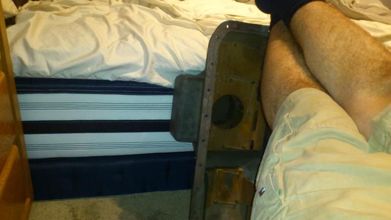

Found this cool foot rest, not sure what I will do with it but it's a nice foot stool
