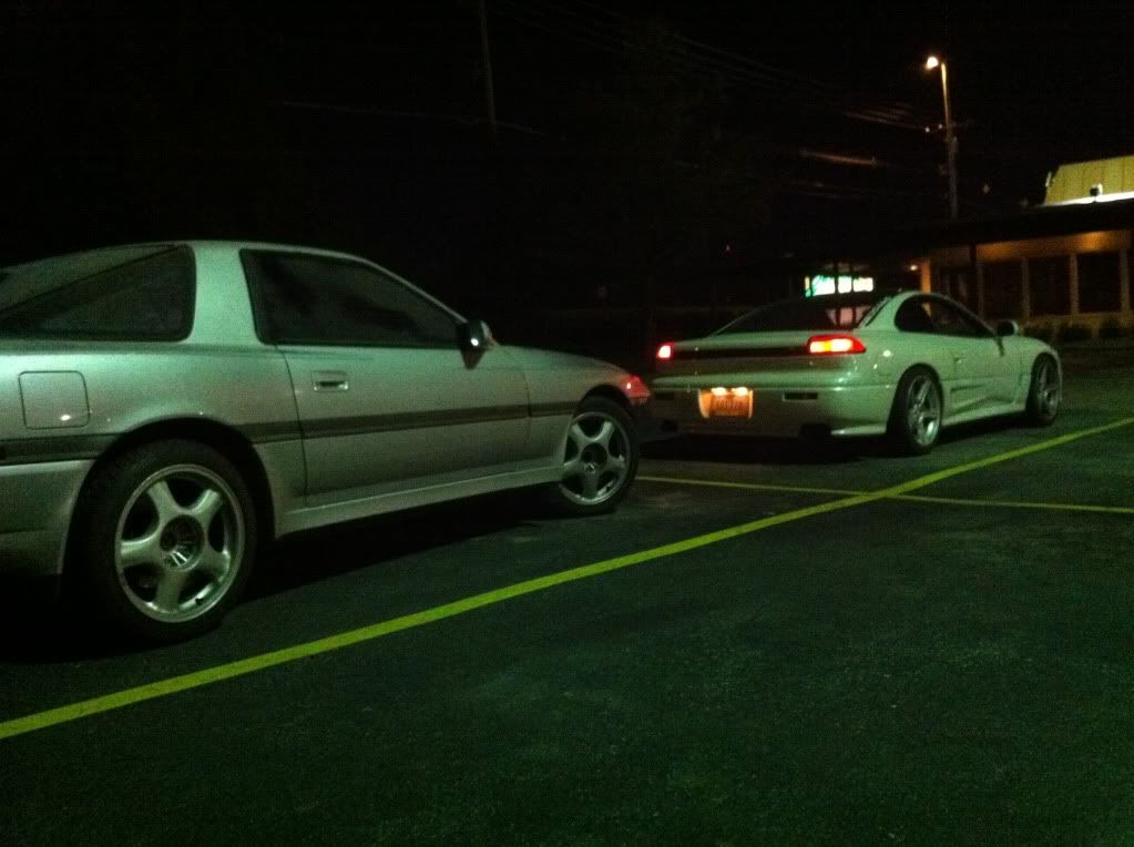

FWIW I'm on TT wheels with Eibachs and Tokico Blues, and I love the way it rides. Need to swap out a strut mount, but everything seems to sit pretty nicely. Wish it was moar low, but I'm not complaining with the terrible condition of the roads out here. The setup is quite aggressive even though I'm still on stock swaybars.

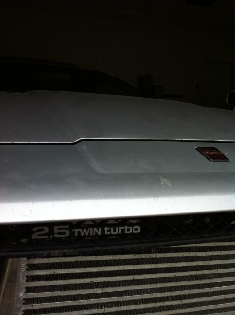

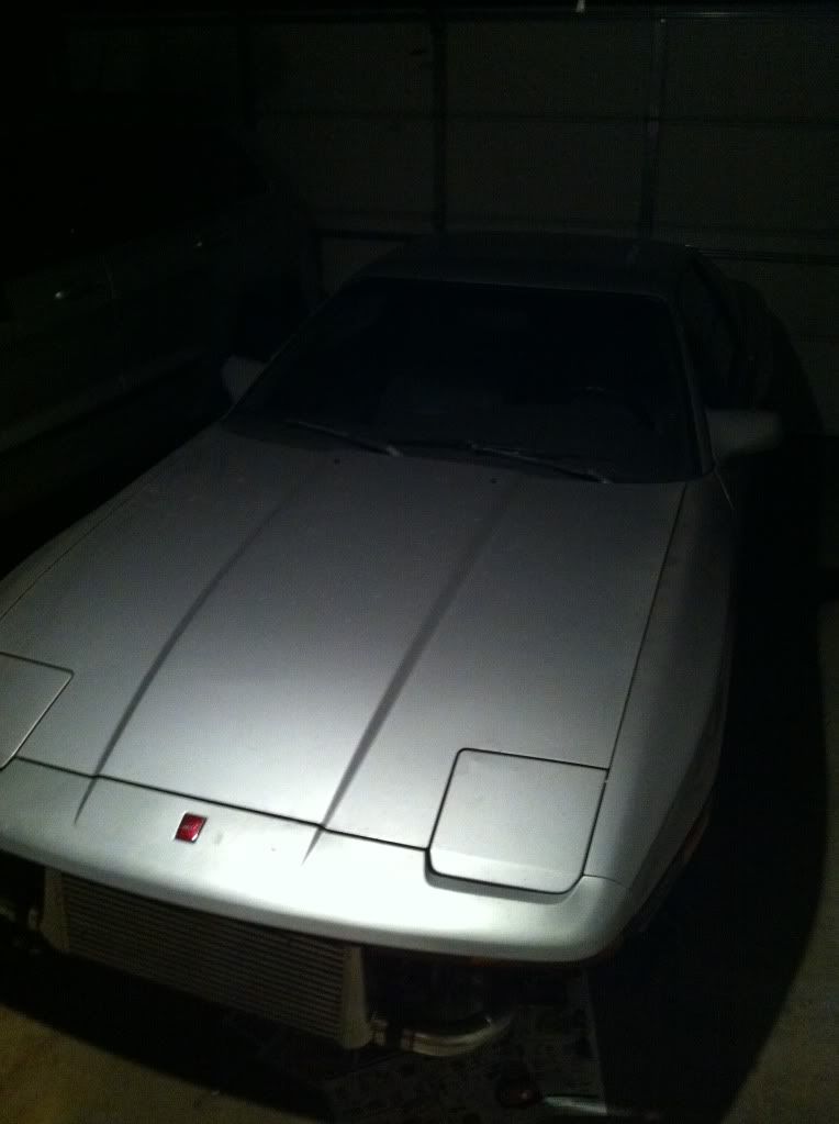

Phew sorry, that being said, my whip is currently under the knife for some PS issues and intercooler tucking / hopefully having a front bumper soon.

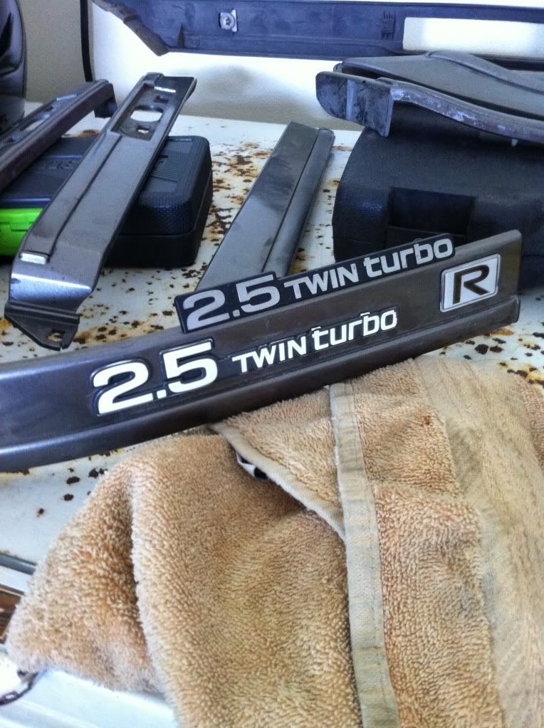

Huge shout out to NewGen for the hookups on this dope ass TT-R trim as well... Giddy as a school girl.
