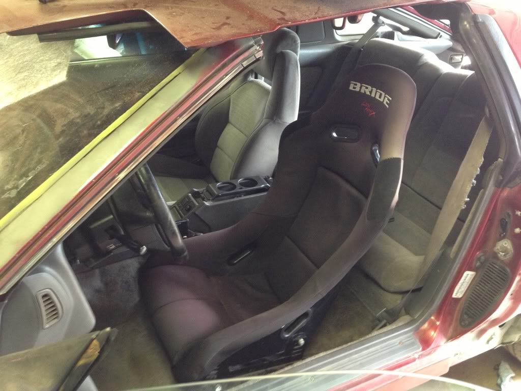

after spending 5 hours shampooing my interior i made my own brackets for my seat
These go in the back seat, its a lot safer for the baby...

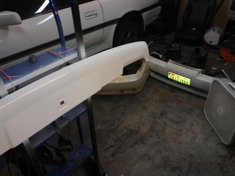

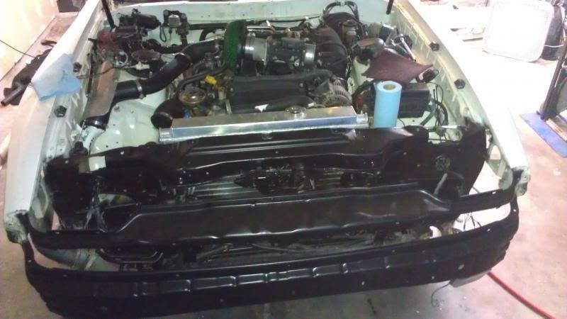

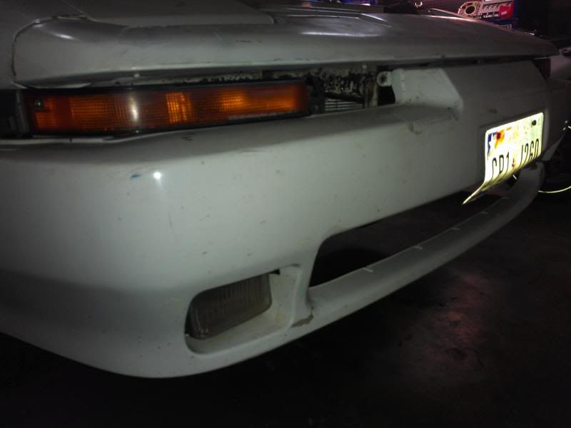

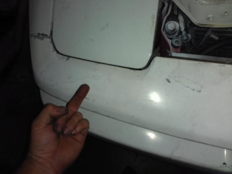

just about done prepping my lower front bumper tonight. i got it in primer last night and wet sanded down till all the old rock chips went flat. then i had about 5 tiny plastic scratches that needed some glaze repair and 2 scrapes i had to flatten and fill. overall no complaints, its going along smoothly.

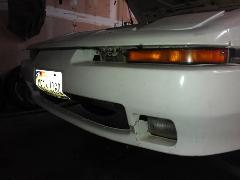

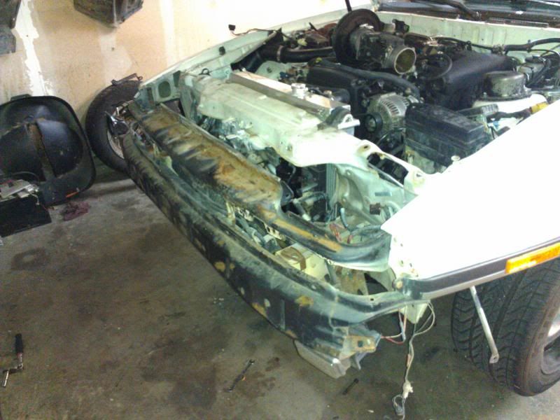

heres the pics of what it looked like and where im at as of now...more to come after assembly. looks like it had a stroke on the left fog/grill and the right front upper. this bumper has never been right since i got the car. i got these pearl white bumpers from the guy that sold me my built short block...he kinda shrugged em off as being garbage but theyre night and day compared to my old shit.
what i found under it all...

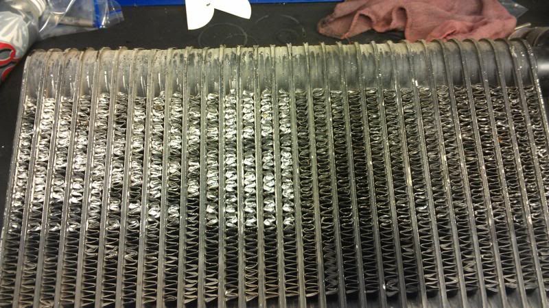

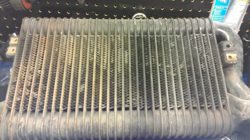

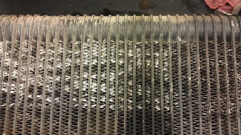

i also found about 70% of my intercooler fins had been folded over and omg if this wasnt a boost leak idk what is...it looks/feels like the bottom of a lawn mower
this is the back of it...not horrible but not good.

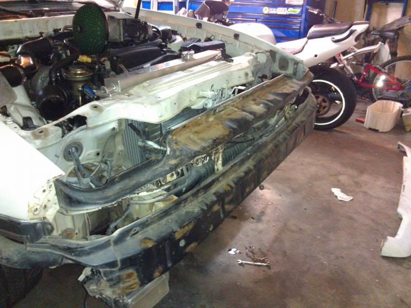

heres the worst of the front and how it started looking after some cramped up fingers

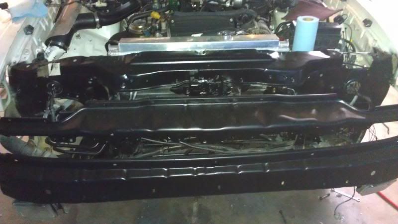

scuffed off all the rust and said fuck the core support being white. (btw, yes its been hacked up to fit my lazyeye style projector conversion)

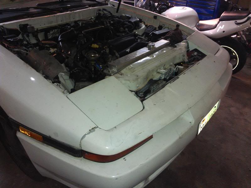

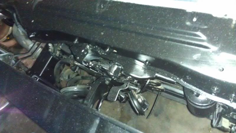

got in there and sprayed the horns, condenser+lines etc..

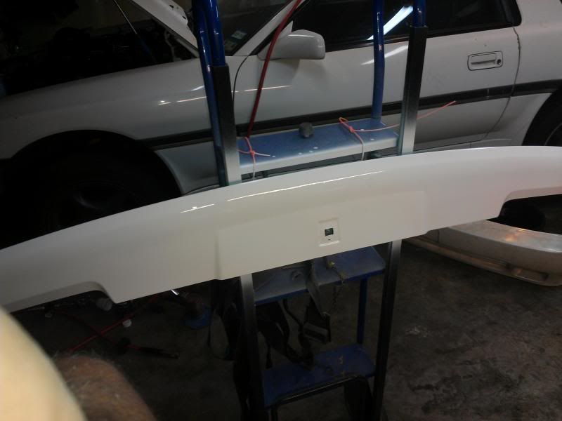

heres the finished upper bumper
and a shot of the rest of my fucking mess. you can see the pearl bumper vs the white and my r154 bits waiting to be cleaned up...also a pair of toyo solara leather seats i plan to swap in later on.

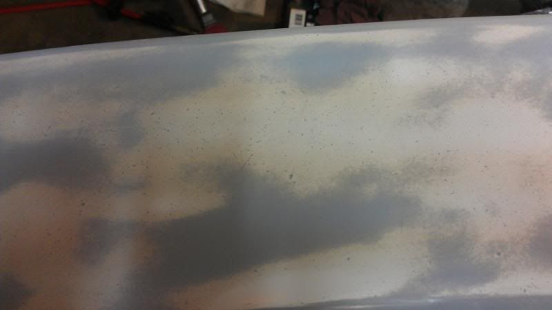

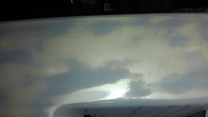

this is after priming and wetsanding the lower bumper. all the specks are where the rock chips used to be...i did scuff a little further after these pics to make it more uniform.
ill clean my bondo and shoot more primer tomorrow afternoon and hopefully i get it colored and cleared on thurs.
