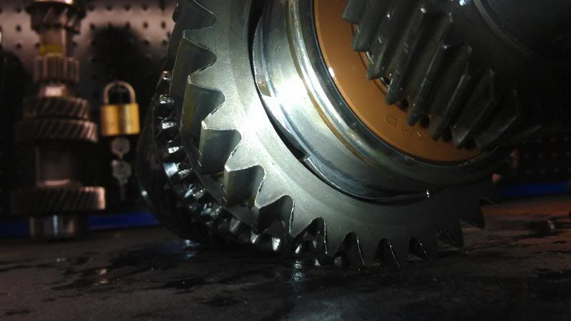

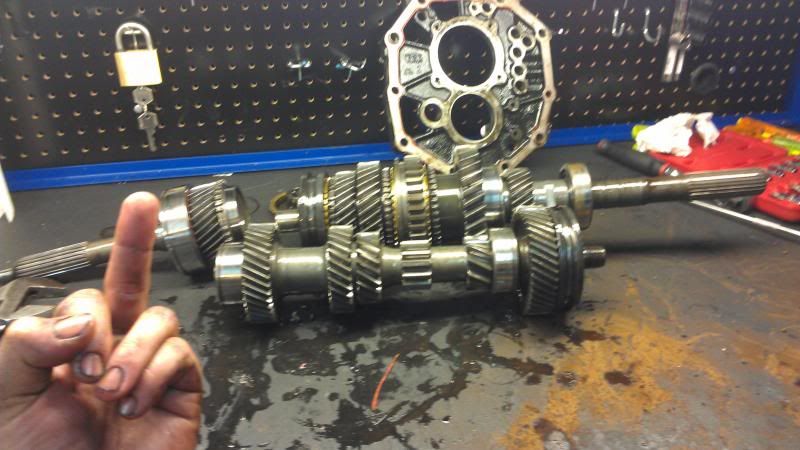

pics of my trans rebuild progress as promised...my phone didnt save some pics but none were important enough to post anyways.
with the trans on the ground and everything attached it took me 2hrs to get to this point.

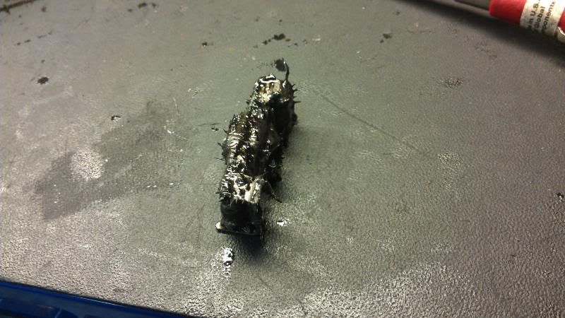

thank you to all that helped diagnose my first gear popping out! i had many co-workers guess (just for amusement on my end) and everyone said syncro or shifter. this is my exploded thrust washer, ill count the pieces tomorrow when i get shit pressed off.

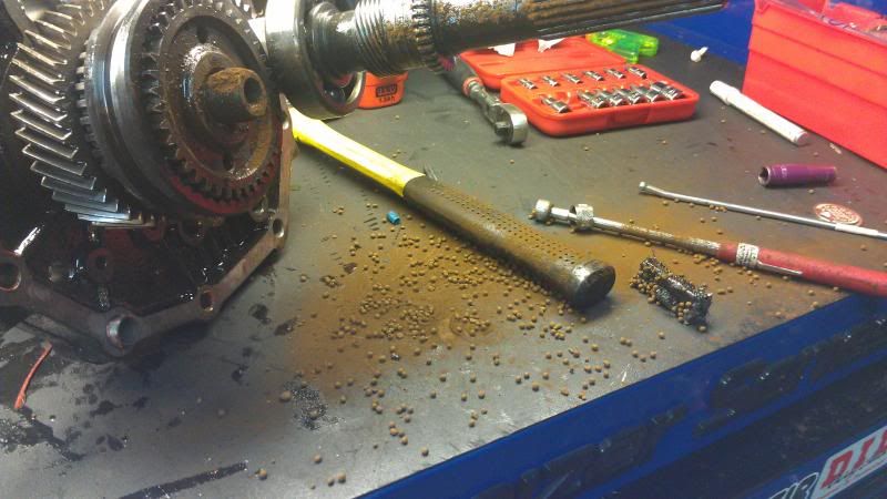

this is what happens when you own a harbor freight dead blow hammer for a few years and work on a supra with it...im really thankful it happened during disassembly and not later when i get everything spotless.
its odd, the trans started making a grinding noise right before i parked it (assumed something let go and went into the gear assembly) so far i havnt found any major chunks or damage to the gears. i figured itd all get caught in the magnet but nothing too crazy.
i got my dm 3-4 shift fork today but the mc parts got delayed till fri...not a big deal as i wouldnt have needed any parts tonight anyways.
since the mk3 is my only ride on 4wheels the ninja has been pulling full time duty, so ill pack up the shafts in the backpack and rebuild em at work where i have a press.

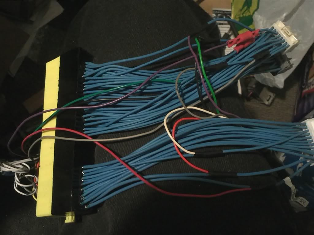

Finished wiring the Zeitronix datalogger and Apexi AVC-R into my field harness. The red bullet connectors are for the O2 sensor. The Zeitronix can fake the narrowband signal from the wideband, allowing me to trick the TCCS into running slightly rich or lean in closed loop operation. Once I have some baseline EGT and AFR data, I may try fiddling with this a bit... or not.
For the time being, I'm going to power these from the +B/+B1 ECU lines as suggested by the installation instructions provided with. I'm going to take the fuel pump off of the +B line when I install the AFPR.
Oh, the black tape splices each have 1/2 of a red butt splice connector inside them, which I opened up. Apexi supplies connectors like this, but I didn't get them with the Neo or the AVC-R, since I got both units used. I also didn't get the MAP sensor for the AVC-R, so I ordered one off of eBay. It's coming from Taiwan (I'm surprised, I was seriously expecting China.) The unit doesn't look exactly the same, but comes up in the search for Apexi part number 499-X002 (And 499-X001) both of which are listed as 3bar MAP sensors. Well, I figure that I can always turn off the boost control if it doesn't work as I want. I'm going to run this with the existing engine for a while before I drop in the new one.
