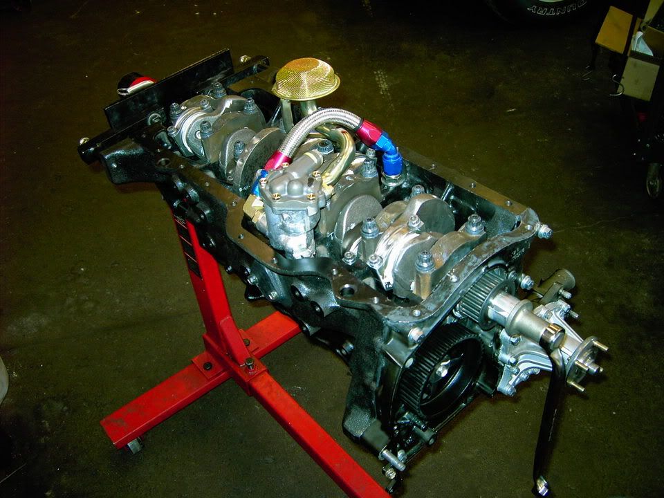

Same with the oil pump. I've modifed and ported my oil pump to accept AN10 fittings. (You can get BSP 18mm 90 fittings to AN10, but the ID of the fitting is not giving you full flow.) Same goes for the stock fitting on the filter side of the block. You have to drill and tap the block for a larger 20mm BSP to AN10 fitting, to get full ID maintained from the pump to the exit point on the block.
To keep the AN10 sized theme, we tapped and plugged the small drilled out passage that normally feeds the stock filter boss on the engine block. The stock main galley thread is 20mm, so a BSP to AN10 fitting works great there, no mods required.
I use a 1/2" NPT compression thread on the outlet where the NA cooler bypass would bolt up to the block. (The GTE has a simple block off plate there stock.) If I did it again, I'd go 20 BSP to AN10 as the straight threads of the bsp fitting don't stress the block like the 1/2" NPT ones do.
I broke a block using the 1/2NPT thread fitting on the rail port. (SUCKED FOR SURE< had to tear down the entire motor, and re-machine the block for a BSP20 to AN10.. Note how low mine is compared to stock which is at the oil pan rail height.)
Shimmed the pump with a 10mm nut, and two washers. Also ported the pump to smooth flow out of the pump. No sharp edges on the corners between the pump gears and the exit point into the 90 BSP fitting.

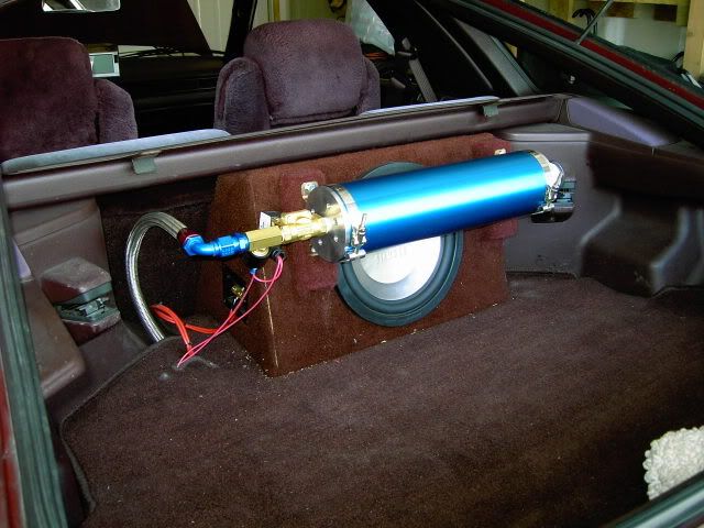

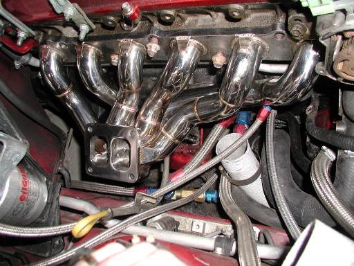

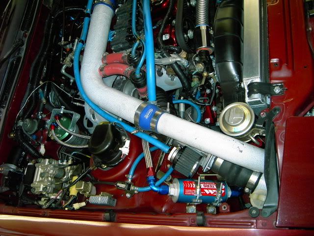

My system is AN10 from the pump to the return at the galley. I used Canton Mecca depth filter and 3 quart accusump. Also used a 1 quart Oil Guard bypass filter that takes oil out of the main galley, and filters it down to just one micron or better. (The Canton filters are claimed to be good down to 8 microns or better, and flow more dirty than a brand new paper pleated filter can.)
This gives you an idea of how convoluted the oil system can become if you let it take control of your engine build!
Small line is feed for turbo.
Two other small AN4 lines are oil supply from the main galley to the bypass filter, and the return line dumping oil back into the pan via the stock oil cooler dump port at the oil pan.
Then there is the AN10 line coming out of the engine, and the AN10 lines, one way valve, and T fitting allowing the accusump to fill/supply oil, and oil to go into the engine at the main galley. (Middle of the round filter boss on the engine is directly into the main galley that supplies oil to your entire engine, crank first.)

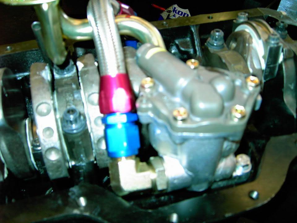

Dude, I knew you were crazy!!! But he's right too, check his out. Notice the lip on the inside of this compression fitting leading into the block up to the oil filter inlet.
If I understood you correct, "Adjuster" this is the hole in the block to the right of the fitting in my hand. The objective was to remove any restrictions between the oil pump and the filter (because there are more than one correct?!?!)
The banjo bolt and this neck down in the compression fitting and the diameter of the bore going into the oil filter location. Oh and the inside diameter of the compression line is probably the same diameter too huh?
you drilled the block out and cracked it here correct?!?!? (DOH that would suck. My condolences go out to you) The scarafices we make in the name of horsepower and speed!!!
Im not sure I understood what you did if anything to this hole going back into the block from the oil filter adapter location. In the second photo, it seems that this hole would need modification too.

After much brainstorming, and trying to think out side the box, I was actually thinking of running the oil pump exit side straight out of the engine via the oil pan and a welded on bulkhead fitting, or drilling a hole through the block, and using a bulkhead fitting there... but really this is a nasty setup as there is not much free space inside the motor....
And then it hit me! The block is setup perfectly like it's own dry sump. You have the pump, and then the crossover pipe taper fitting that directs the oil up to the oil filter boss cast into the block.
That hole and fitting that ARZ's photo is where the oil after being pumped, goes up to the oil filter location. (Via a drilled passage that I belive is a restriction as the ID appears to be smaller than what I wanted, and smaller than the main galley fitting in the middle of the oil filter location.)
So, to keep the AN10 ID size from pump to return at the motor, the pump was modified, block was modifed and RX7 cooler was modified. Everything else was AN10 or better anyway.
I would use BSP type fittings v/s tapered thread ones to keep stress on the block to a minimum. (There is just enough material on the block to drill it out and tap it for the 20mm thread needed to keep the AN10 ID intact. And since the BSP type fitting should not crack the block, you just compress the o-ring and your done.)
On reflection, there is more material down where mine ended up as the "web" for the main also runs across there. By cutting down the mount, you get into the thicker web area, and you also lower your fitting height, and make it less of a reach to tap the passage to the oil filter so you can plug it.
I like the modified oil pans I have seen lately, and if I was building my motor now, I'd for sure add a round baffle, and kick out the one side at least. (Most likely kick out both sides, add the baffle, and a crank scraper/girdle as that lowers your oil pan, and adds even more capacity to your system along with the strenght of the girdle and it's built in scraper.
