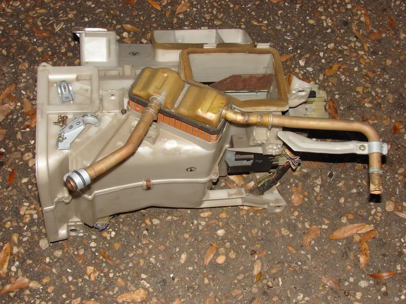

Good News!!! If you are talking about the piping at the firewall, it can be fixed rather cheaply.
Bad news!!! It's not the easiest repair to make. You'll have to pull the dash (not really hard) to get to it. If you look in the picture, both pipes have a clip midway. You pop the clip, and the end of the pipe comes off. This is a pretty old picture, I believe I still have everything. I decided to bypass the cabin by connecting the inbound hose to the outbound hose, and lost heat. Let me know if you need one of these pipes.

its a major leak coming from behind the engine, i pushed on the heater hose as far as i can go but it still leaks like hell.... it doesn't look easy at all to replace this thing.. :( is the banjo bolt a common problem>? it doenst look like its coming from there it looks like i have a hole rusted on the lower metal hose, super lame...

Do the quick fix like ForcedTorque suggested, and in the meantime get yourself a new core, and learn how to swap it out. Make sure you burp it after you re-route though. Don't wanna run it low on coolant!
