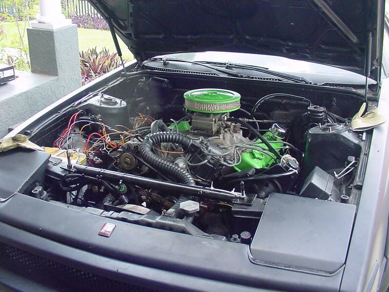

my old MKII supra but its a buick nailhead 350 with a TH350 trans. Solid motor and tranny mounts no ac no power steering. used as a drift car it made 602 hp with a 1600cc carb. forged pistons, rods, knife edge crank

eman2289;1239666 said:
I hope to god that u purposely riced that thing.
what is riced out on it? everything is stock except the hood scoop which had to be made to get air to the carb. The exhuast is boso not rice and thats how me roll down in south florida. We build outlandish shit
A piece of unchromed crush bent pipe is hardly either..... :nono:
