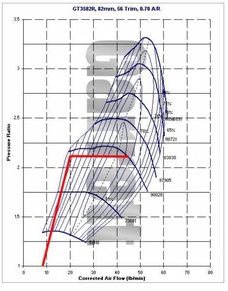

Here's the compressor map for a rebuilt, healthy 7M:
IMO, from the looks of it, the 35R is nothing short of ideal, especially for a street car--79% compressor efficiency is some serious shit, and only the biggest ass turbos see numbers that high. It'll theoretically start to run out of breath above the 7M's redline, though the 7M isnt exactly a high RPM breather anyways. The HTA gimmick should surely be able to provide some extra oomph up top though.
