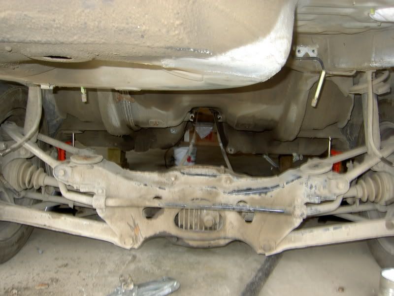

I recommend a good sandblasting for those rear knuckles - and be prepared to spend some time on them...it takes a long, long time to get them clean...
here is some inspiration: My rear end went from this:

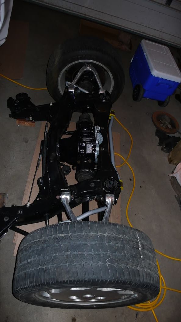

to this:
I finally rebuilt and installed my mk4 rear brakes on my car - size-wise they match up pretty well with the ARZ front kit.

Nicely done, Adam. :) I see you also polished the upper a-arms. :) Are they new, or just polished? Either way, they look great!
I also picked up all new hardware for the entire subframe. No old stuff will be used!
I need to settle on what swaybars I'm going with. Time to have another chat with Wiisass. ;)
Your pic reminded me, I also need to pick up new e-brake cables! Thanks for the inspiration! I'm almost there. Just waiting on powdercoating of the hubs. :)

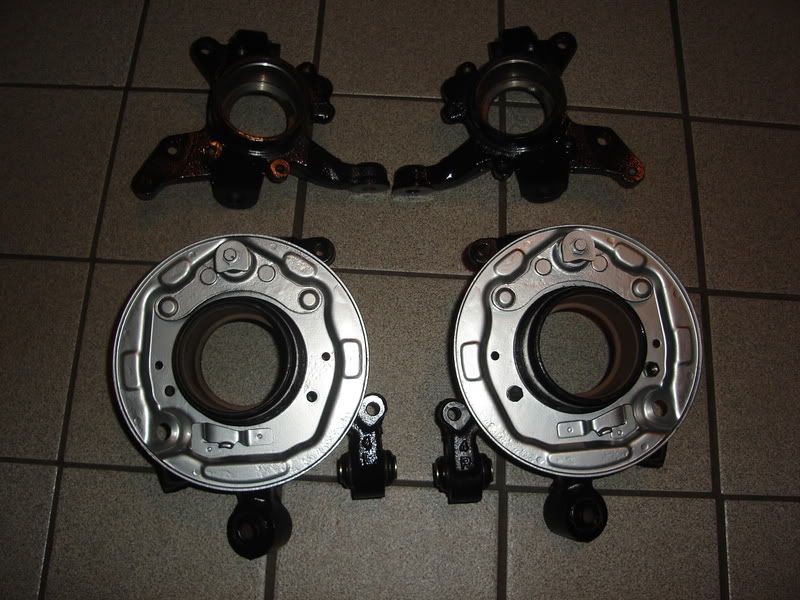

i ended up buying some rust remover stuff from home depot and poured it into a 5 gallon bucket.i submerged the hub's into the stuff and left them soak for a long time.they came out nice and clean like fresh cast piece's.this was alot easier then doing it with my sandblaster because the rust was real heavy.i did end up blasting them after because i think the powdercoat has a stronger bond.you can kinda see in the pic's that the backing plate's on the rear hub's had some heavy rust.the powder doesn't really fill in the heavy pitting,even though the piece's were primed,colored, and then cleared

Those look great. I'm going all black with mine. Less visible brake dust. ;) I can't wait. Thanks for posting the pics!

Just polished....and not the best job at that - I just wanted to smooth them out and clean them up.
Now that I think about it, one of the arms was next-to-new (came off my parts car with the toyota sticker still attached)
The new hardware makes a big difference when putting the subframe back together - heres a hint for you, get yourself a bottle of copper anti-seize and give the bolts a liberal coating, especially where they fit into the bushings. It will make future alignments much easier and should prevent the bolts from seizing into the bushings.
