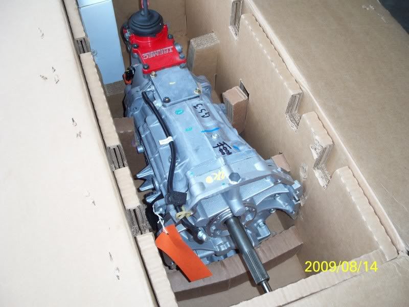

I hear you. My tranny arrived this evening. WOW. Nice. I talked with Ross today and he verified that the bell housing is still a go and looking at Oct. for delivery. He is still waiting for a cone for some final measurements. Says he really would feel better about it if he thought they would sell. I told him that once it gets out how easy the install will be with the right housing he will not be able to keep them in stock. My feeling is now the NA's will really be a viable alternative to big bucks for a TT. For less than the price of just a 6 spd Getrag, you can get a new T56 Magnum tranny, LSD and driveshaft and none of it will be easy to break. And still have $1000 +/- to spend making your sweetie smile real big or install custom Bilstein shocks/coilovers on all four corners. Now you can run the NA with the big dogs :icon_bigg That was the major reason not to turbo trick a NA as the block with the exception of the piston skirt squirters is exactly the same and the NA cams are better than the TT aftermarkets from the get go. Thats just IMHO. A new Tilton 3disc clutch goes for like $165 if you can stand the on/off. I'm just going to go with a good performance PP/clutch from PHR and use the hydraulic TOB. Now I will have LOTS of options. So - keep me posted on your progress on the mod and I will do the same. cd
