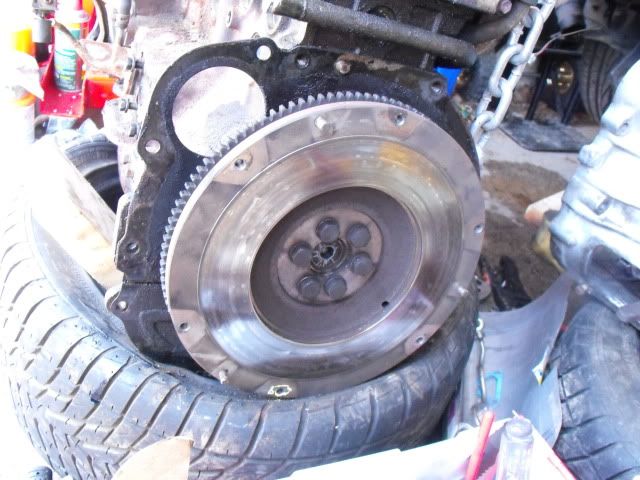

---------- Post added at 10:08 PM ---------- Previous post was at 10:06 PM ----------
I6Boost;1590591 said:
R154, && Dowels?
A dowel is what I call it. Not sure of the technical term. You can see it in this pic, above the flywheel, just below the coolant line.
