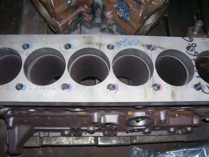

I need to make about 10 or 20 of these and sell them.
This is pics of my titanium torque plate.

I'm going to make mine out of steel. It will be cut on a CNC mill already have the CAD program made.It will also be machined ground true. I also have a Block and head lapping plate which is also ground true.

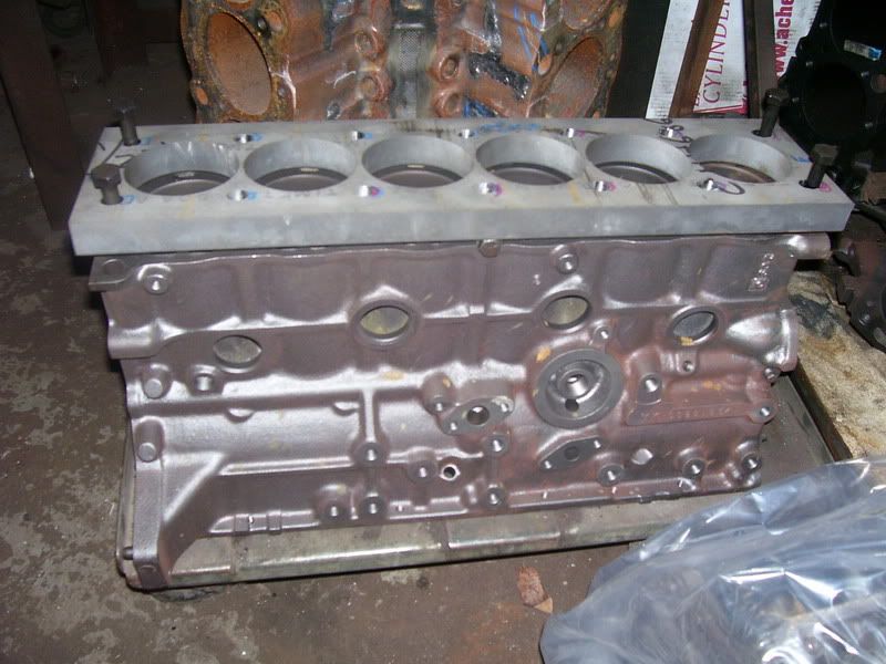

Ok, guys here are some teaser pictures of my Torque Plate. It goes to the machines tomorrow to get all the holes cut and drilled out. I'm making it for .60 over. Once I'm done with it I will be renting it out.

Why .60 over? Why not .40, since anything including and over that is making the block too weak, IMO.
Why not .080" over like they do in Japan?
I see a lot of old GTEs over there that there were no weakness issues with.....
HKS, JUN, and others make 85mm pistons + oversizes to do this.
I have a set of 85mm pistons made in Germany (probably for Blitz),
that I got out of Japan.
They refer to them as 3.1 liter pistons.
I like the Titanium idea,
shipping it back and forth would be a Lot Less !
Let me know when your going to start renting it,
I have a block to do.
