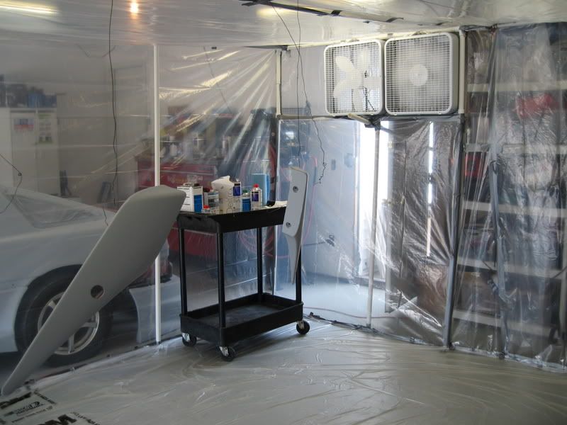

All I can give you right now is an inside view of my super ghetto paint booth:)

Thats a great homemade paint booth Ken, be proud of all your hard work. Looks like you got some supplies??? Cant wait to see the color on it!!!

Thanks Ryan...I feel better about it with the booth, I have it set up with the 2 fans with filters mounted at top on one side for air in, and 1 fan + 2 filters on the bottom on opposite side for exhaust, keeps a bit of positive pressure so nothing gets sucked in, and should keep me alive;) everything is setup and ready to go. Im using the same DBC base with DC4000 clear. It was mid 50's out when I got home today, but it should be sunny and 70's tomorrow:):):)
