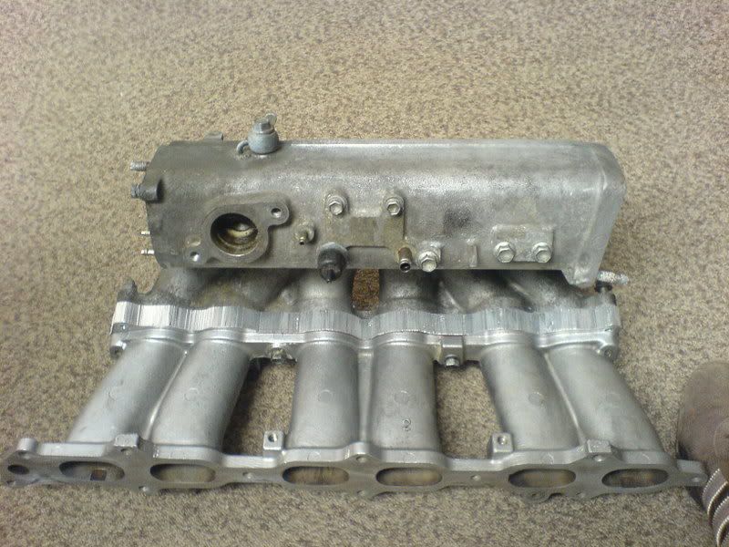

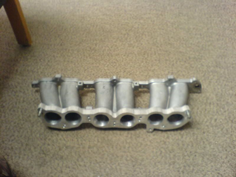

Nick M;1811886 said:You would have a leg to stand on if you knew what you were talking about. There is one benefit, the shorter intercooler pipes. And that was done because the JZ is a gutless wonder down low. If the plenum is bigger and the runners bigger in diameter and shorter in length, then you would have a case. But that isn't the case. You are making the case for front facing, not an improved manifold. By the way, the fastest drag car in the US uses the stock manifold. Ported I would guess.
I'm not arguing that the stock intake manifold is garbage, I'm stating I think that overall, the engine can be improved on. I would assume that when switching to FFIM you would optimize the design to suit your goals, ie plenum volume, runner diameter/length, throttle body size, etc. Who is the fastest drag car in the US right now? I looked at the 1/4 mile time sticky, but I don't know if that's up to date.
