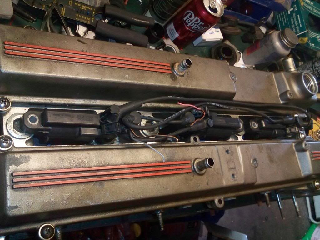

This might shed some light for you...

I think he's dealing with the spark plug valley cover bolts. They are a 14mm inverted hex- and yes, you can pull them without touching the HG. Just be sure to put sealer on the threads before you torque it back down or they can leak oil.
Edit: just for clarification, this pic has one of the plugs visible on the very far left, right under the bolt hole in the coil. OP: Is that what you're talking about?

I replaced the "#3 Cylinder Head Cover" (that strip in the middle) AND the sealing bolts (I ordered NEW from Toyota, and I THINK they already had "patch" or "seal" on them, possibly 3-bond MEC (Micro EnCapsulation) which is like Lock-tite... but better.)
More likely than not, that oil down in the galley and spark plug pits is from spilling when adding oil and having it trickle down past the plug boot. You will likely find most in the first and second pit... that will be a good indication that's what happened or not. It may also be pretty "clear" or "clean" looking oil.
G/L!
PS: It's a BIG-ASS HEX (ALLEN) WRENCH or SOCKET!
-crisp

Ah yeah...Those are the bolts I'm referring too.
