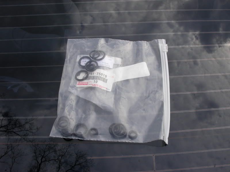

Buckshot, this last one is just for you.................:biglaugh:
I didn't know which O rings did it for you, so I got you a variety pack. You know we aim to please here at 1-900-sexy-oring..................:naughty:
That's my favorite kind.:evil2:
They look so new and unmolested. I'm going to frame that pic, and hang it next to my original Nate drawing. The composition is amazing, I especially love the tree at the bottom...
