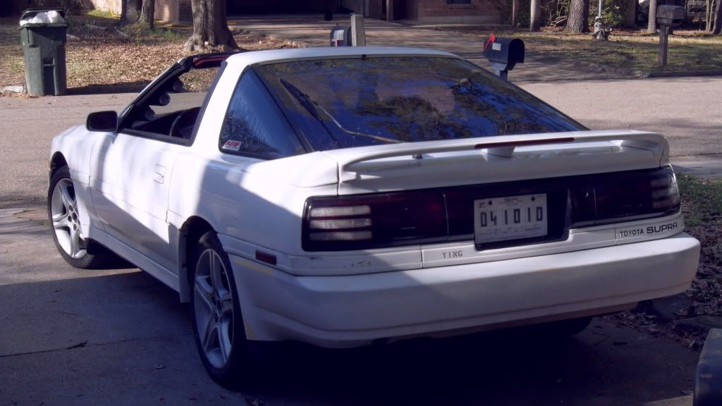

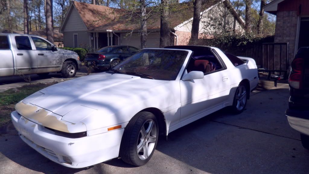

Here is my 1991 supra turbo. I have already built it. But I was asked to post some pics so here they are.
I will post more pics when I find my camera. And when I decide to do more stuff.

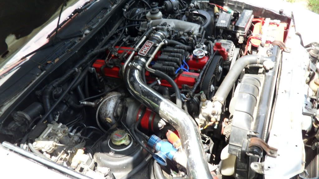

INFO: 1991 supra turbo. 1.2mm hks stopper mhg. .020 nippon pistons. 12 miles on the motor after rebuild. That tells you how much I drive it now. rebuilt R154 WITH also only 12 miles on it. T70 turbo. HKS EVCII. HKS f-con.
HKS FCD type-k. 3" mandrel bent exhaust with a flowmaster super44. greddy turbo timer. big fmic. 3" IC piping. Honda civic top IC pipe with a fake blitz BOV welded to it. Solid custom motor mounts and Much more.

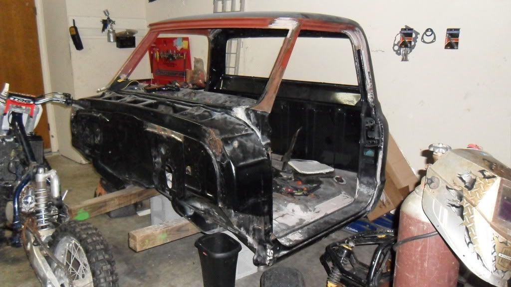

And my new DD I just put a new fender, grill, bumper, core support, and hood. And fixed the frame. 1994 chevrolet 1/2 ton with a 5.7l 350
And the once trans cooler is gonna be my new oil cooler for the supra. The tiles are 12x12 BTW.

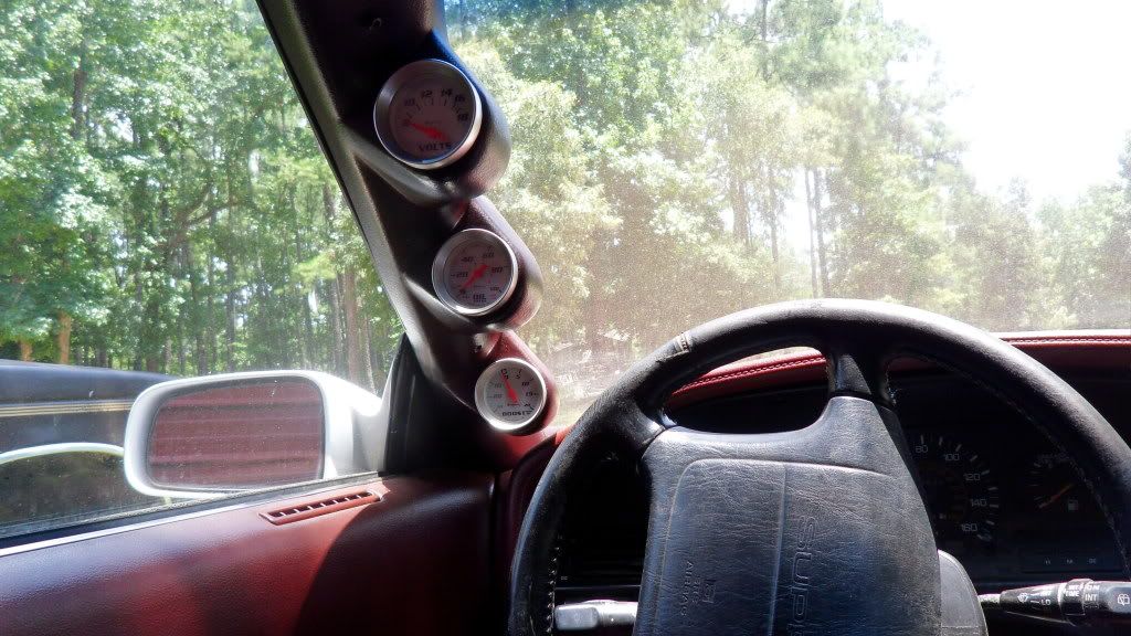

I noticed the pillar pods. Whats your mod list? (FYI I turned off seeing others' sigs)
Yeah it looks good on camera. there is alot of blemishes but no rust thank god. I just listed the mods. The pillar pods are made of plastic and tend to warp in the texas sun.

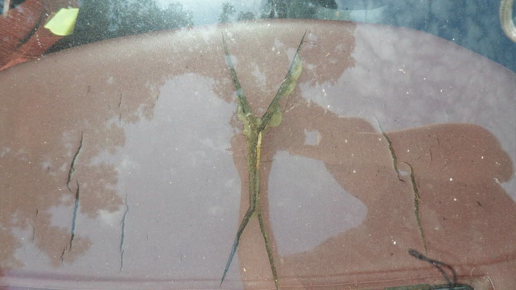

Thats all i've ever had. silver and maroon. and white and maroon. The only thing wrong with the interior is the cracked dash and the sun baked head rests.

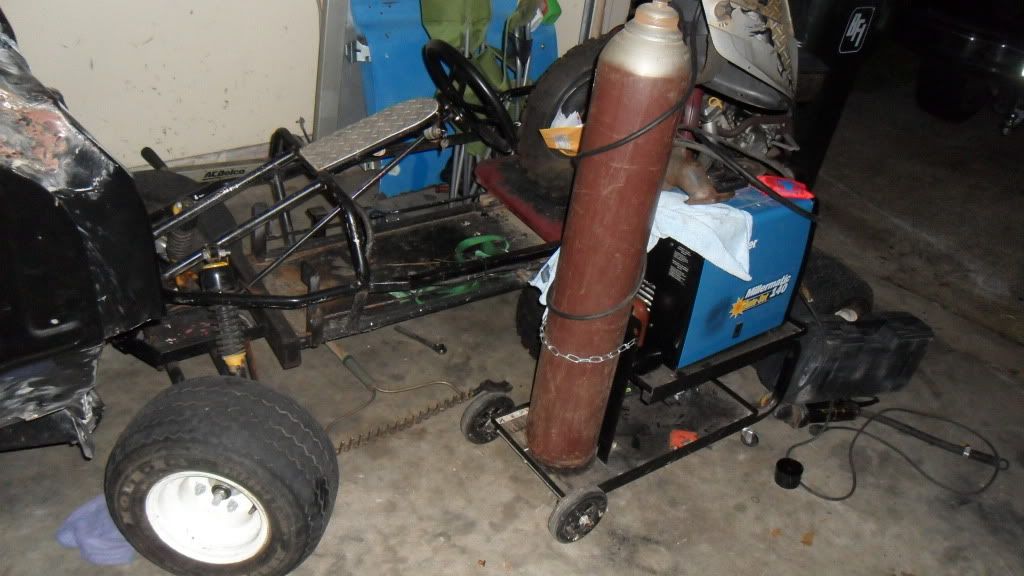

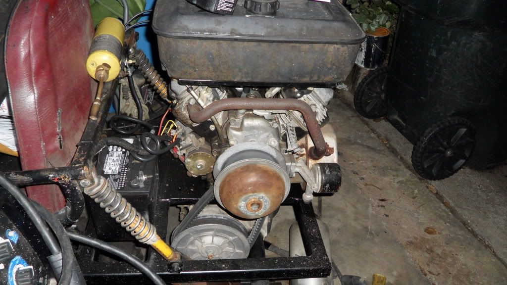

I've had the gokart for about 4 years now. It was once a yerf dog then I custom made the rear frame for a golf kart diff. With forward, neutral, and reverse. And the motor is a briggs&stratton 16hp vanguard from a generator. elec and pull start. I widened the front frame and stretched it so my dad can fit in it. GT grant steering wheel and custom from a-arms and tie rods. I hit a few trees. And a reinforced front nose. And 4 lug golf kart tires. It is slow as hell but it can pull anything. Oh and a honda odyssey clutch.

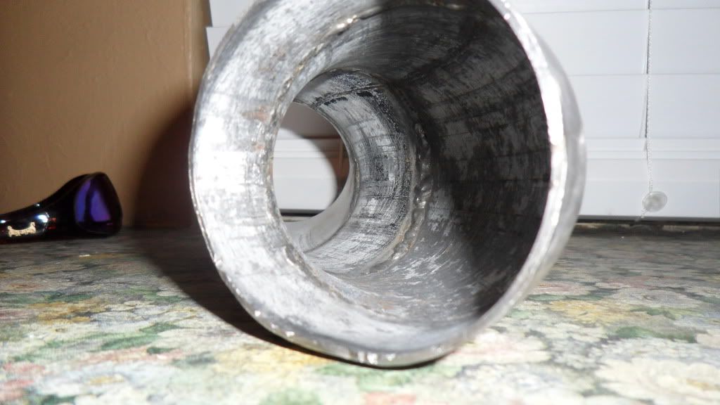

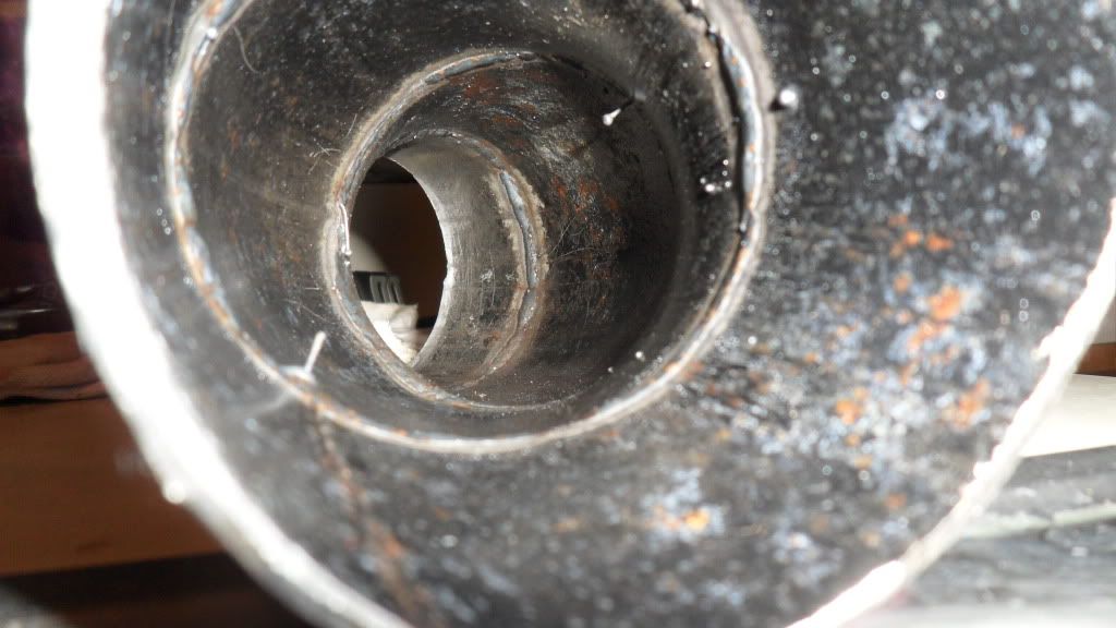

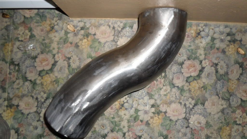

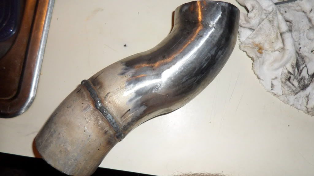

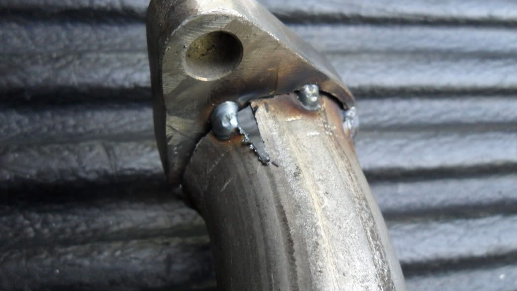

What I did this afternoon after work. A front turbo pipe for Spawntaker aka: Abrahim.
Not finished but almost there. I'm only going off of pics since he is out of town. But here it is.
I still need to clean it and smooth it up.
And I also need to drill and weld nipples.
I have a feeling that I might have not made a sharp enough bend. What do you think?

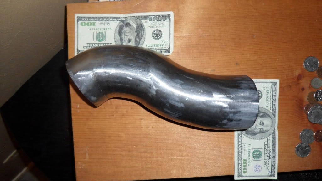

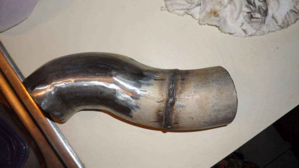

Progress for you Abrahim.
All welded except for the nipples

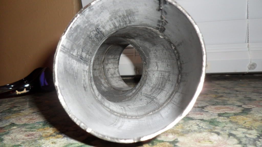

I got my penetration on the welds and grinded so I could make the pipe look seamless on the outside.
And I cleaned out the inside as much as I could.

yep its mild steel. 3". I put the nipples on it today and installed it on Spawntaker's car also. It looks really good on the car. Almost better than the cooleeze pipe.

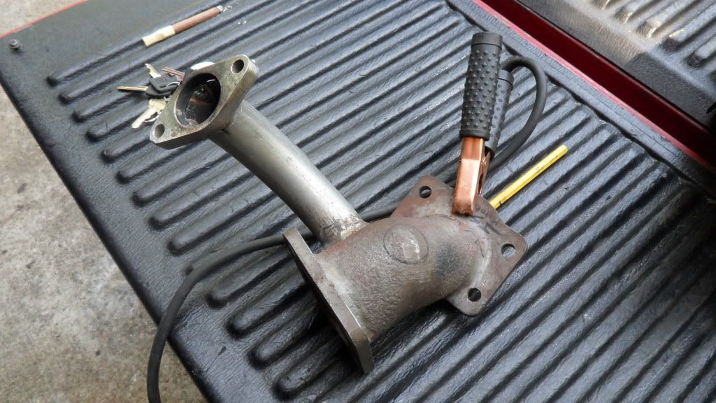

What I did today

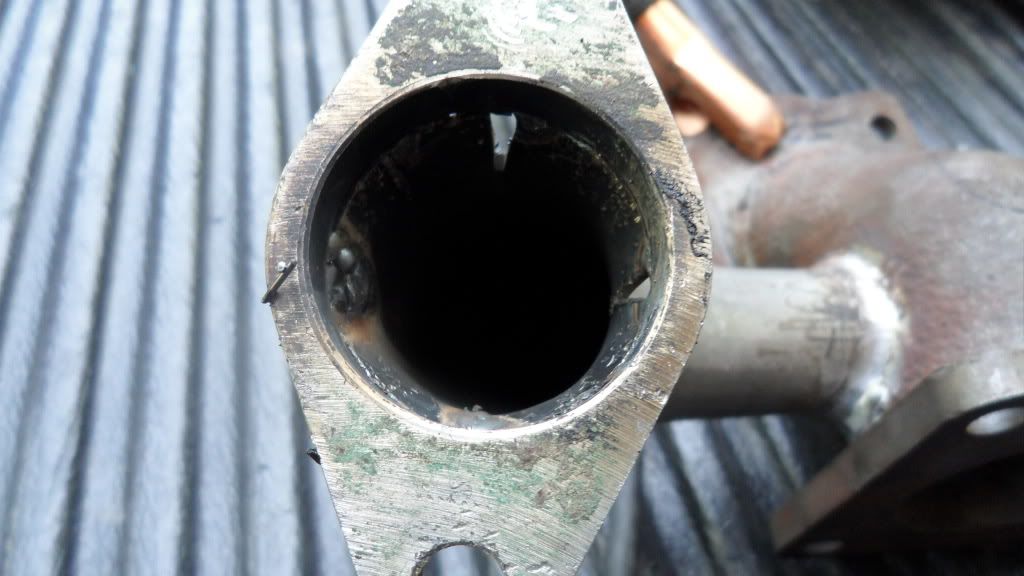

I welded the 38mm wastegate flange onto the adapter finally. I decided to give the adapter to Spawntaker. I couldn't sell it and I didn't need it. But if anybody would want me to make them one I can.
64
You want to shoot for about 70% penetration on your welds as a smooth surface inside is much more important than strength in this case.
(no load on an intake or ic pipe so 70% is easily strong enough)

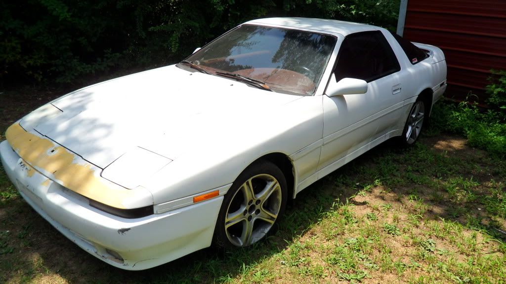

And I did a little traveling today and got some pics of my car
And as she sits till next weekend.

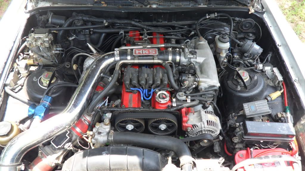

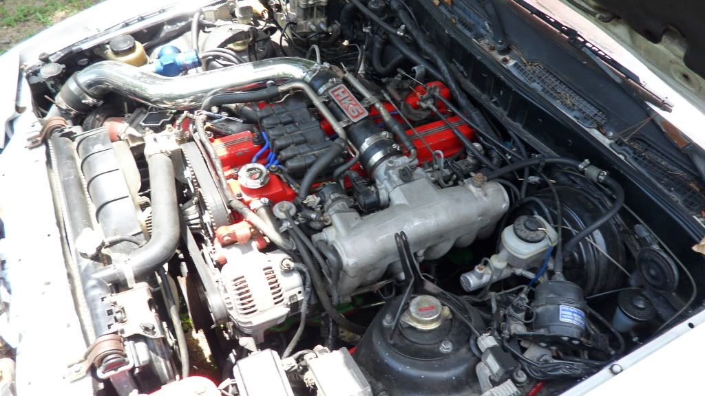

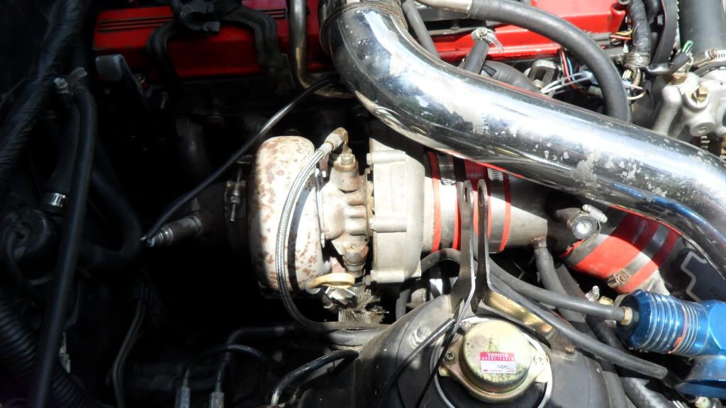

This is a totally different motor. Notice the green under the alt. Yes my block is kawasaki green. Only 12 miles on the motor after rebuild so far.
Turbo side view
Intake side view

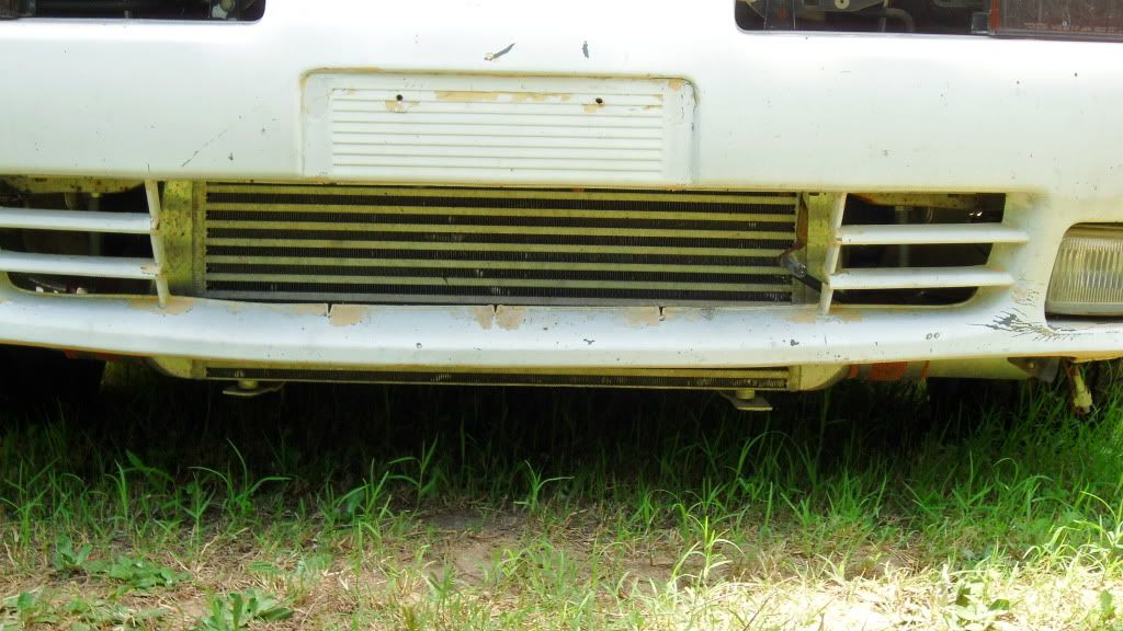

FMIC I need a lip bad

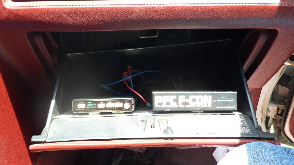

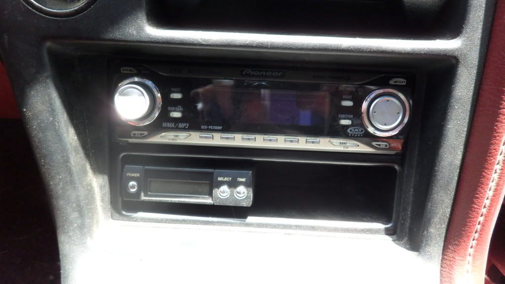

Pioneer deh6700mp and a greddy full auto timer.
HKS PFC F-CON and HKS EVCII
Your right on the money. I would have done it tig. But I sold that machine. But its good enough for this pipe. Any other pipe I would have. Like IC pipe I would have done what you said
64
We picked up power on the dyno in the past changing from a spiral pipe between the aircleaner and turbo to a smooth bore one, you can still do it with a Mig just takes a little practice fiddling with settings.

will do. I'm going to make another one anyways. Abe's car is a non-turbo shell so it came with the n/a PS res. I didn't know that until after I made the pipe. So I was kinda bummed that I spent all the time for no real reason at all. Next time I'll pay closer attention to the details. Damn I need to go refill the bottle too. Thanks for the advice. What kind of difference did you see HP wise. Throttle response?
