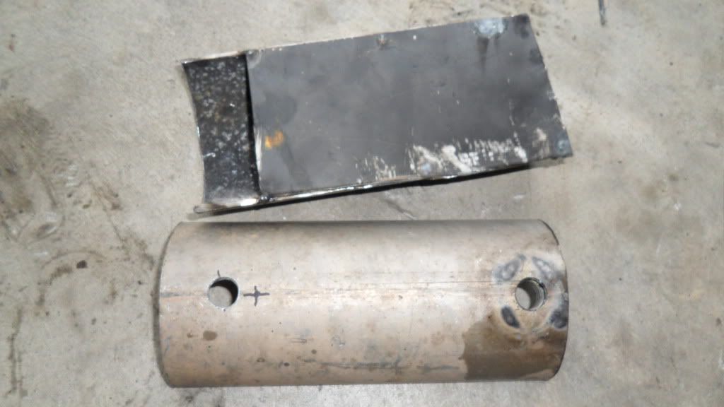

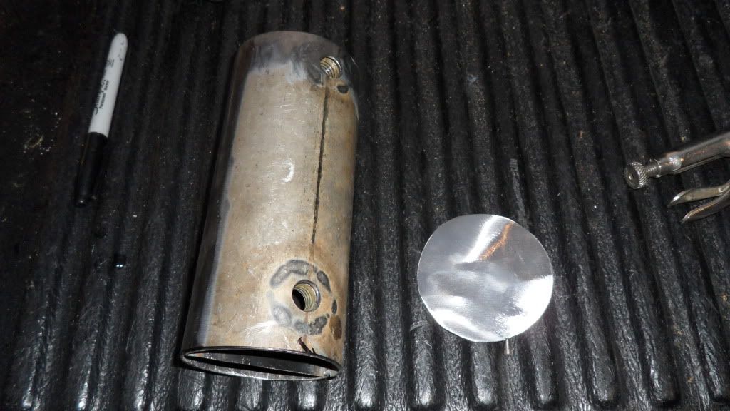

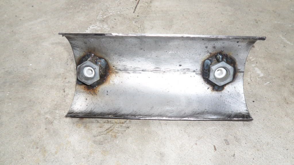

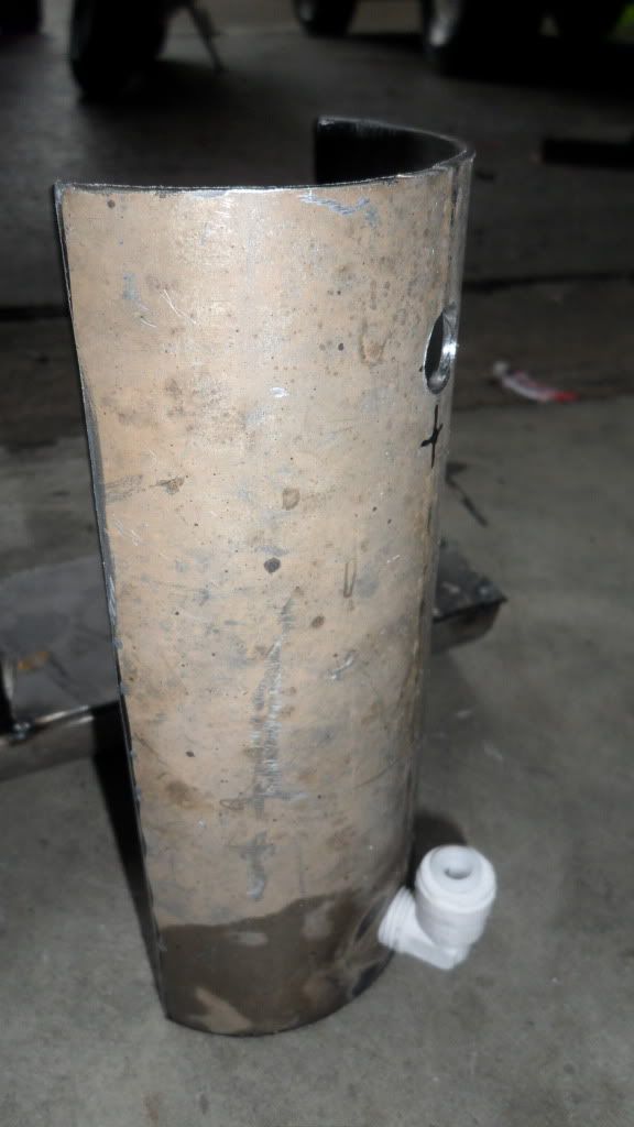

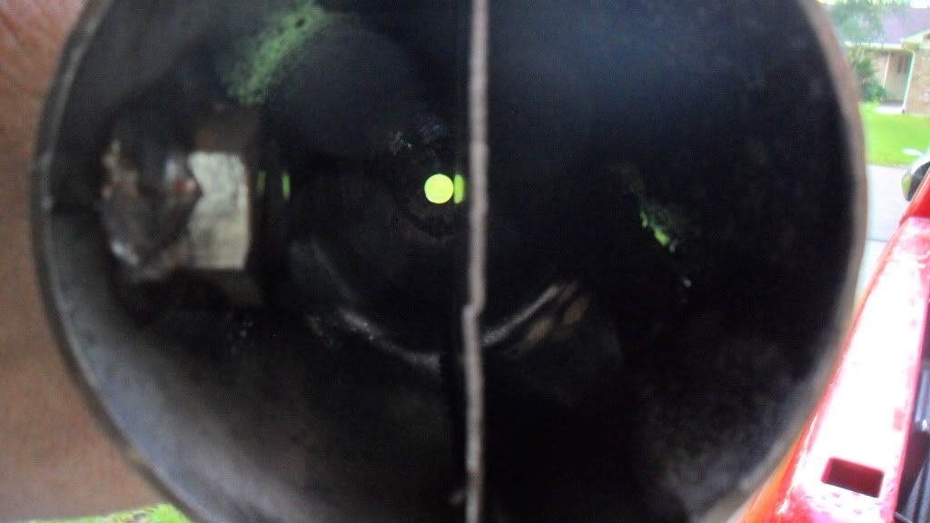

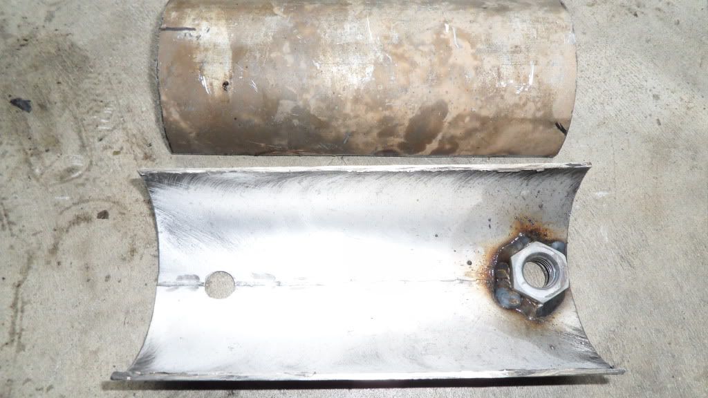

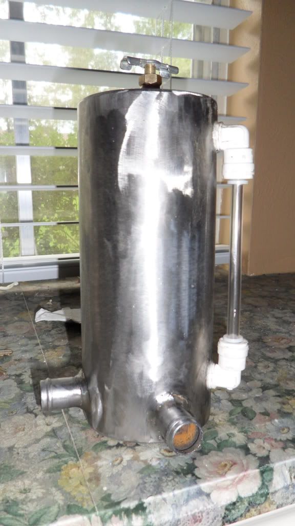

What I did in the past 30 minutes.
First I cut the pipe, then marked my holes, drilled, and cut the pipe in half.
Then i welded nuts on the inside, and welded a separator plate in the middle.
And there you have your level indicator.

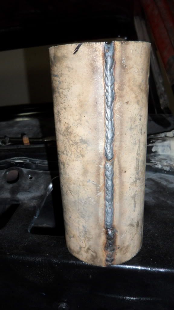

Then I took the two halves and welded them back together
The welds aren't the greatest but It is sealed.

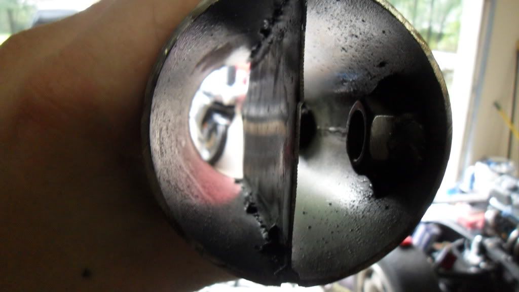

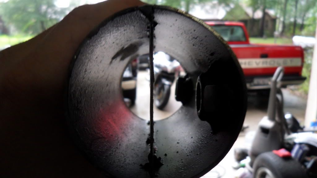

And here are some inside views.

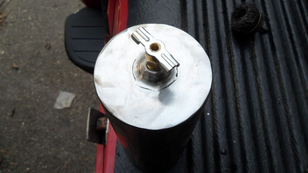

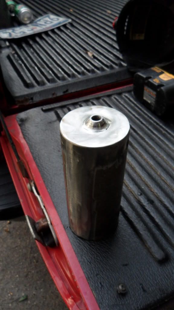

So this is my version of an Oil Catch Can
And for the people that ask: Its a 2006 Kawasaki ZZR600.
:) Spawntaker this will be yours

that looks sweet. i had to pull my supra in the garage today. some of the seals where leaking. arrggghhhh. and with the rain we had i didnt want the supra to be flooded. cya soon buddy.

nicely done. i know you probably still remember but i just fell i have to say it because i cant keep my big mouth shut. dont forget the steel wool that you told me about. it would be a pain in the ass if you did forget. lol. got cut and weld again. if you need i could always run and get you some. cya later buddy.

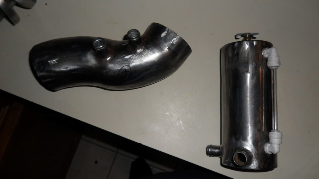

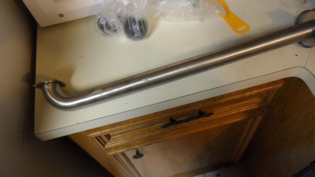

And now on to the next project: a stainless steel upper radiator pipe.

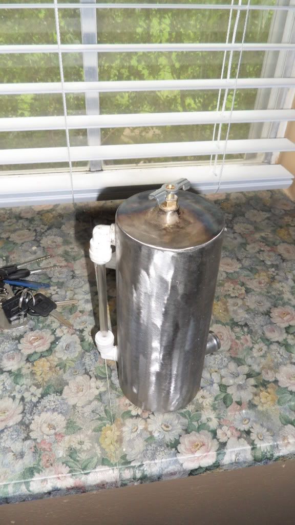

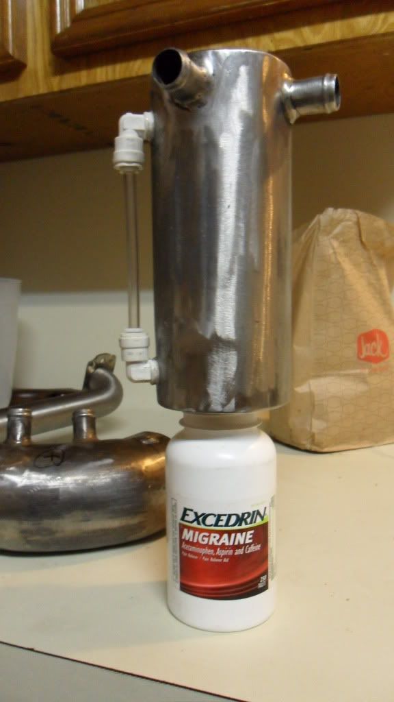

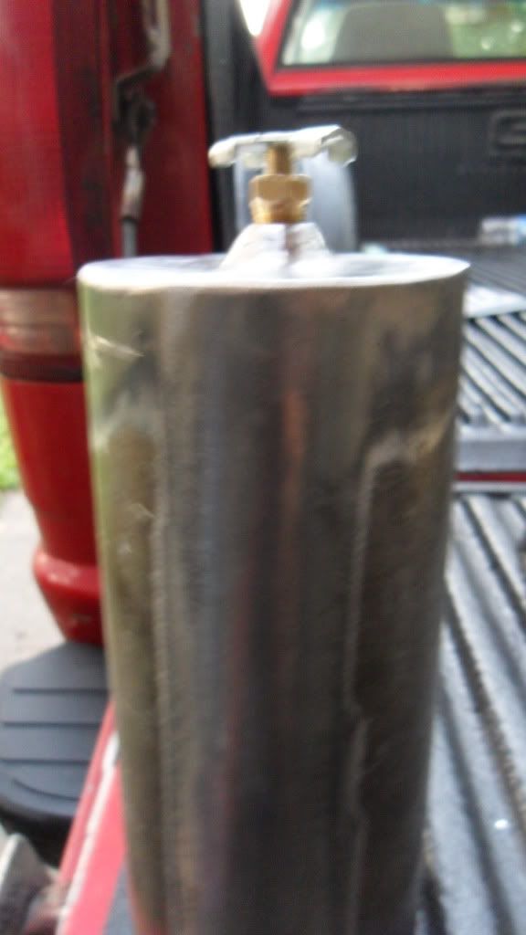

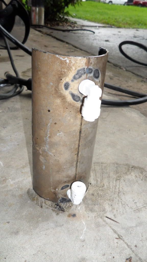

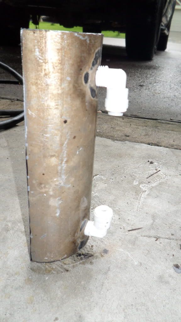

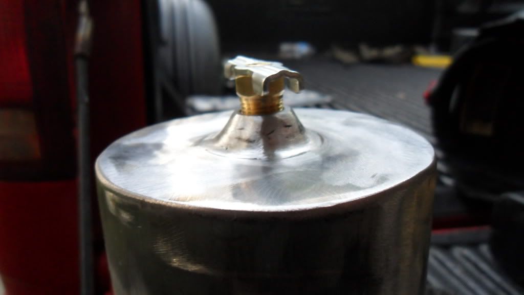

And pics of the finished (but needs to be painted) catch can:
I usually get a headache after welding so I need the big bottle.
And the next hole in the hardpipe that I need to make for a nipple for the catch can. Ha I said nipple
Well thats it for now. More progress tomorrow. Unless something comes up. Enjoy.

lol nipple. if you dont have the paint then i can get some and do it. but yeah i would have painted the catch can black. radiator pipe i dont think we will have to paint might need to be polished to bring the stainless steel out. and the accordian hose i might polish it to have a chrome finish to it. thanks buddy(with a slight indian accent)lol...

well bad news. I wont get a upper radiator hard pipe out of that pipe. I did a bobo this afternoon. I cut the pipe to size and tacked it together. All went well until I realized I didn't turn on the gas. I can still use the pipe but I just dont want to grind all the porosity out. So I'm just gonna make another.

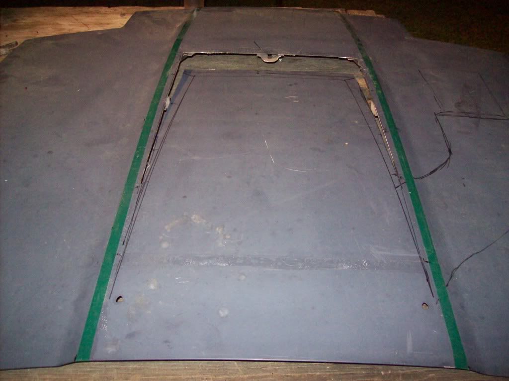

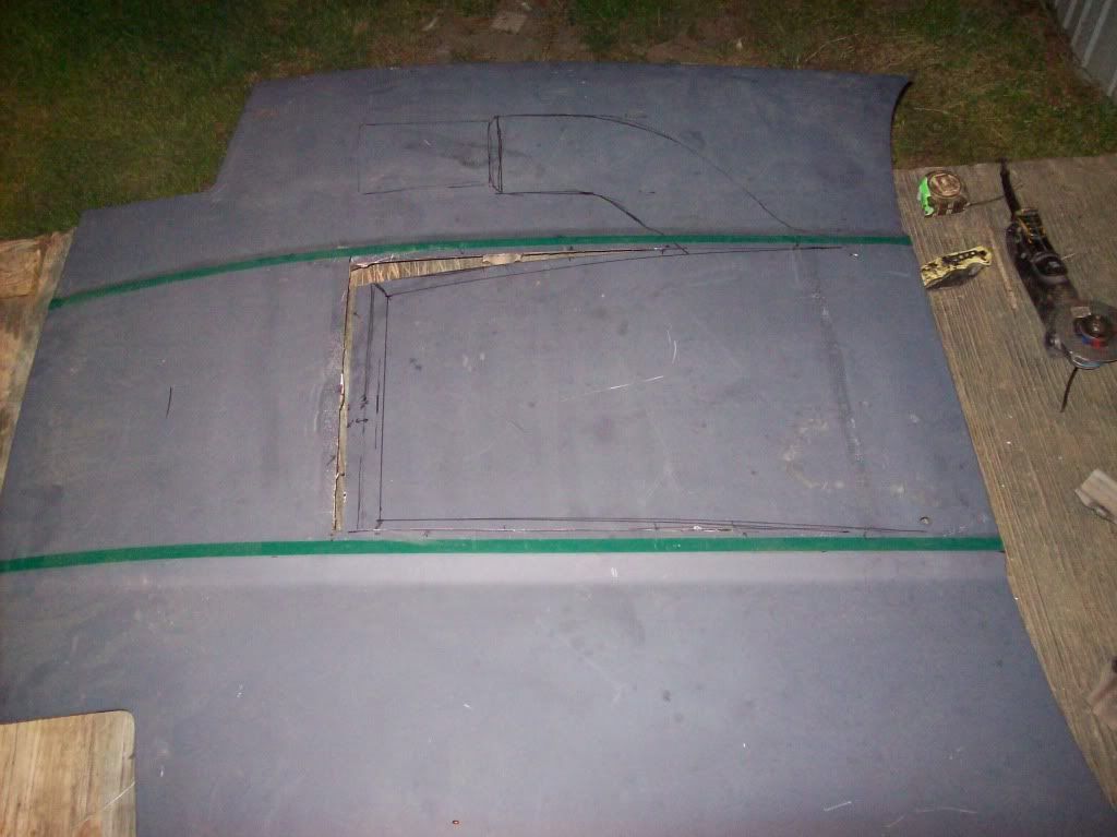

Okay some more pics of my shit that I tried to do. But never finished Like my custom hood
Please mind the drawings

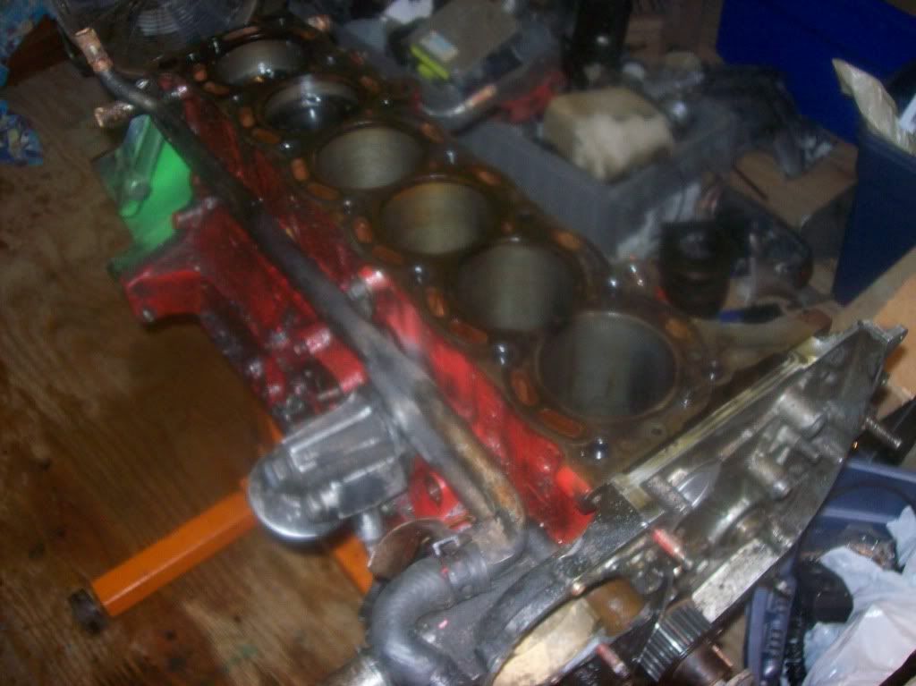

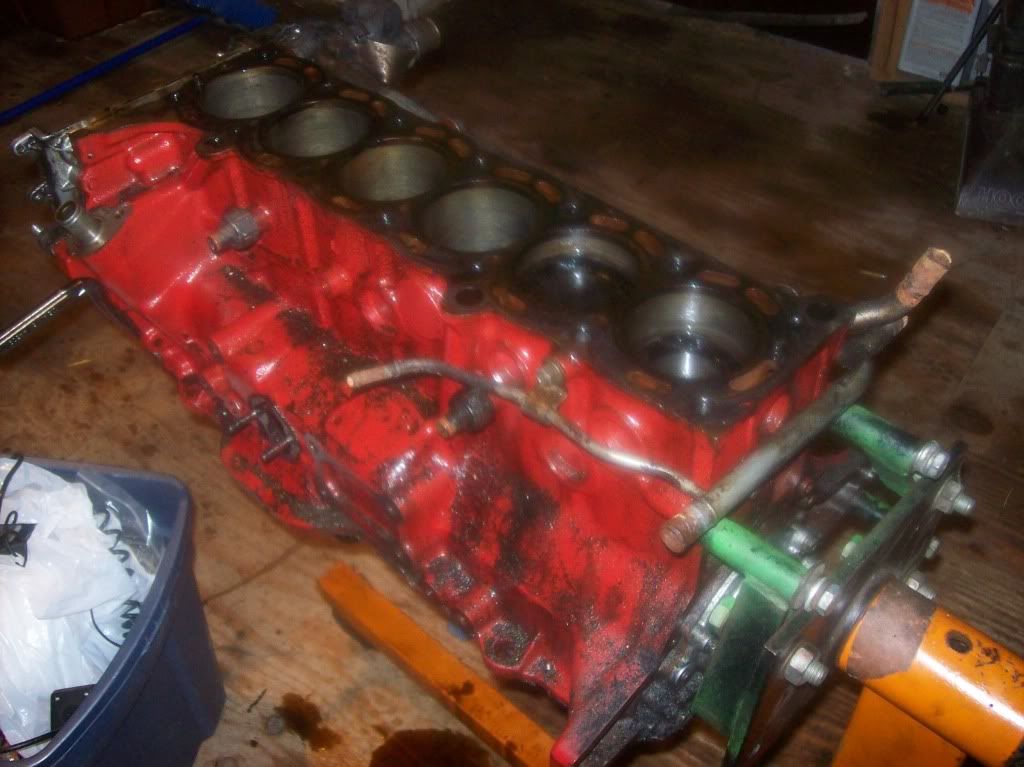

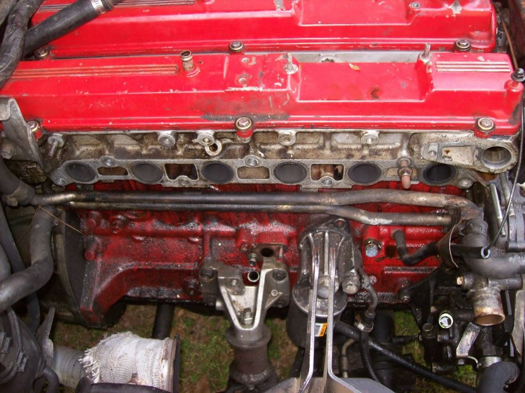

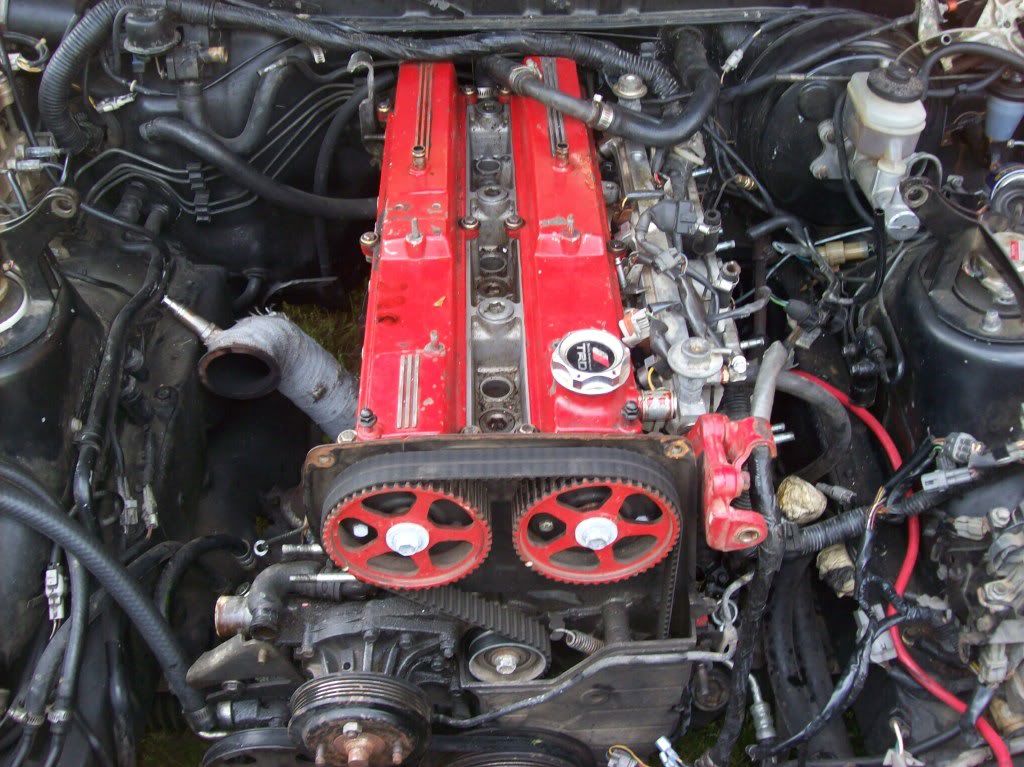

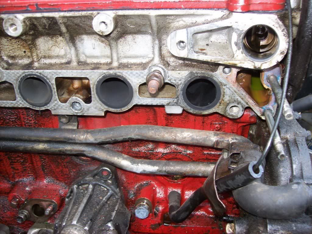

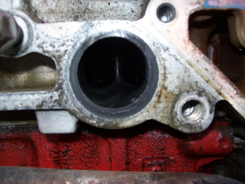

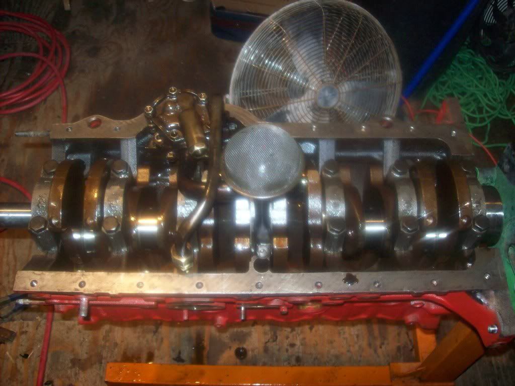

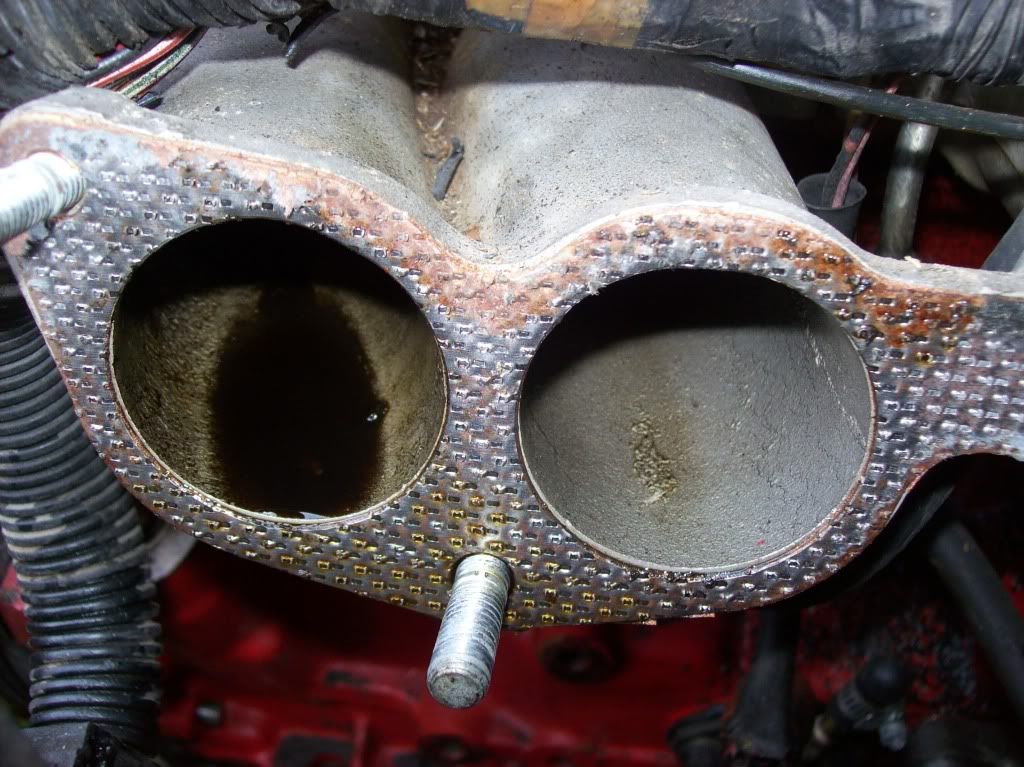

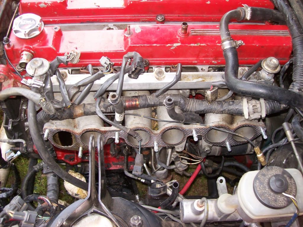

The motor that had the BHG.
#1 cylinder (oil)
I blew the gasket between #1 and 2
Oil in #1 intake
and more

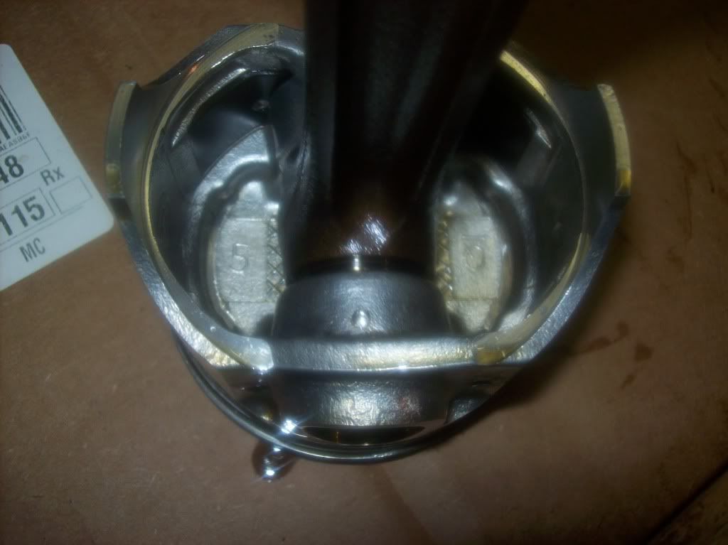

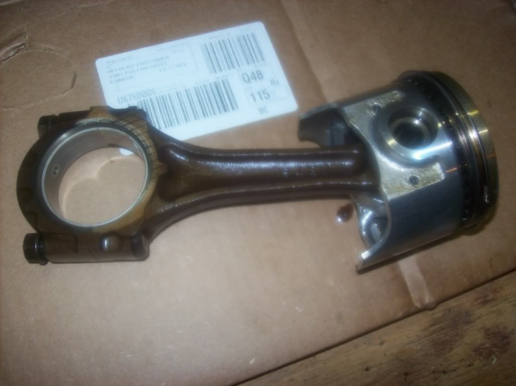

The motor after I took it out and removed the head and #1and 2 pistons.
again
#1 piston
and the inside after I took all the pistons out
And my last drive with that motor. My little bro and I.

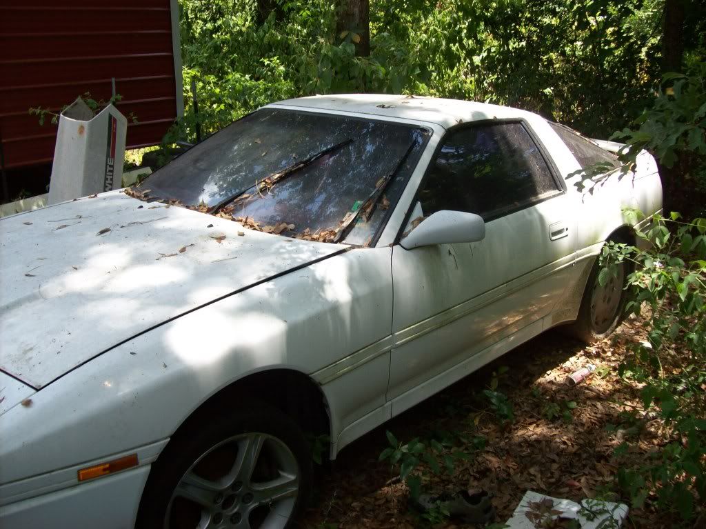

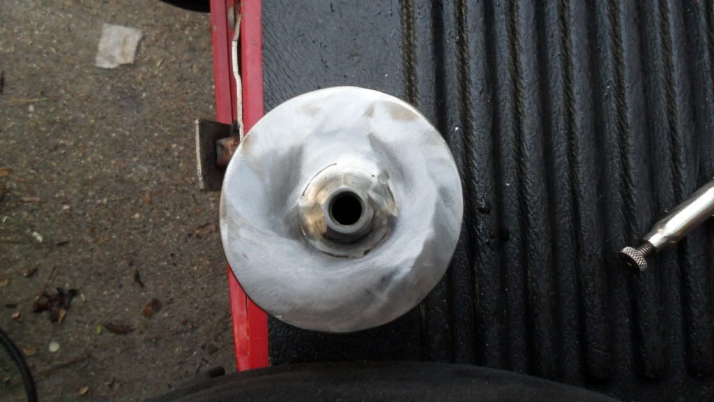

Just a few pics.
This is what a holset hx35w turbo looks like with my custom adapter.

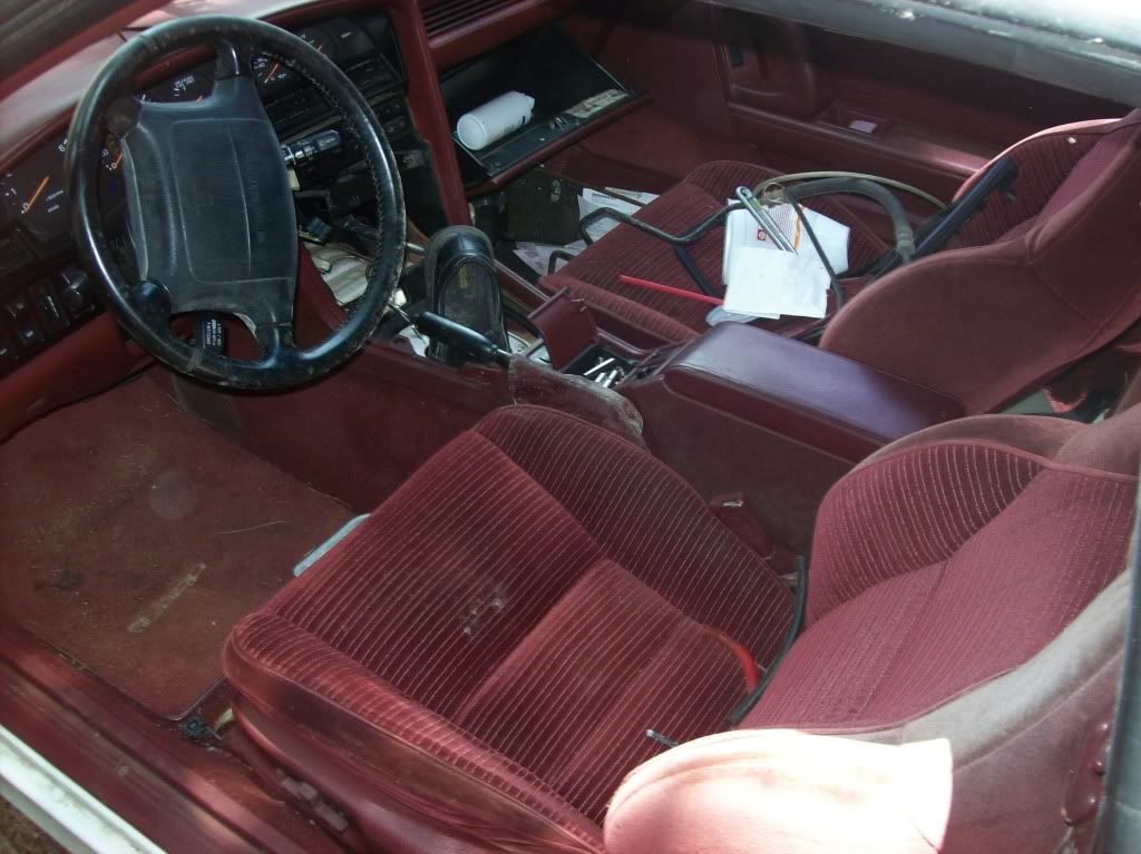

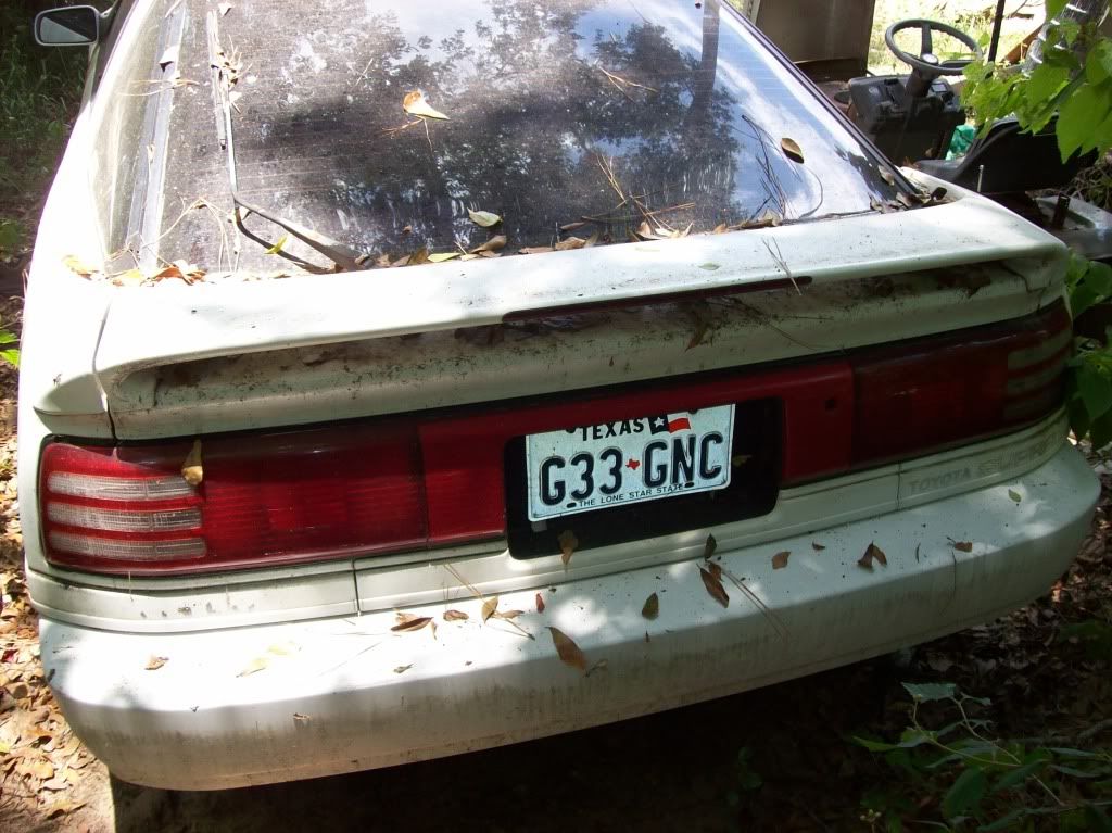

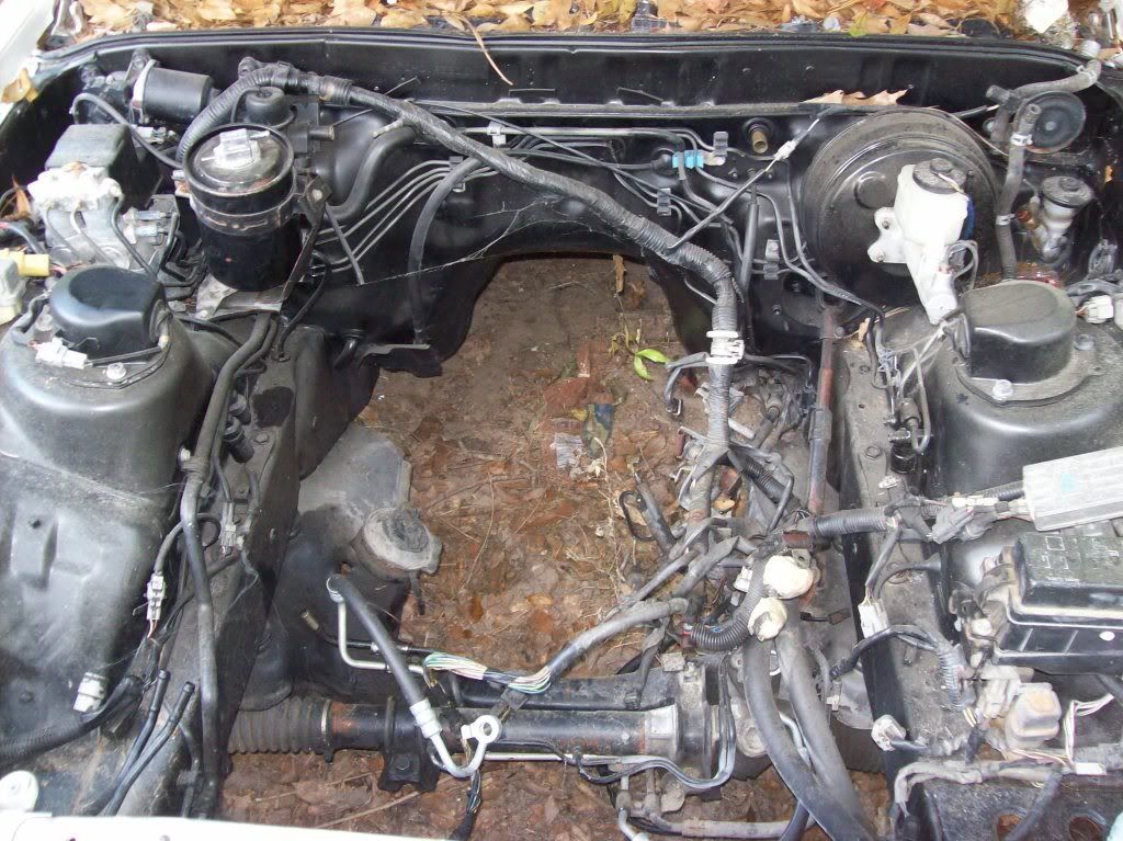

And the only pics of my car that I can find of before I started.
Just sitting in the back yard waiting.
The interior before.
The tail end before.
And the bay before
