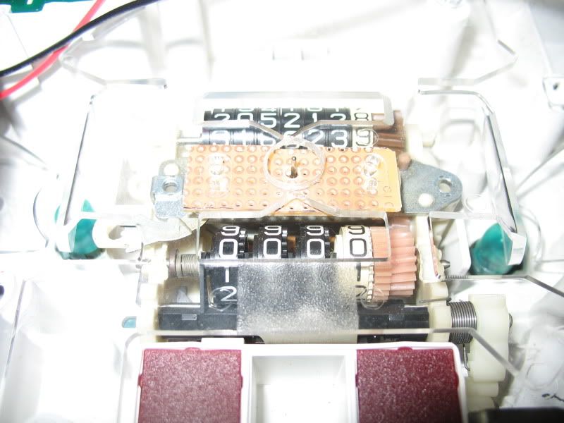

You put this into NA car right? I remember having to swap mine over to a GTE tach.
Ya, you can either do that or swap out resistors, but my iron is terrible and my soldering skills aren't amazing to begin with. I'll try to troubleshoot tonight. I must just have a weak connection somewhere.
EDIT: just got the tach working. resoldered two resistors and it works fine. I must have had an ugly joint, but all works now!! :)

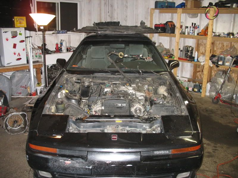

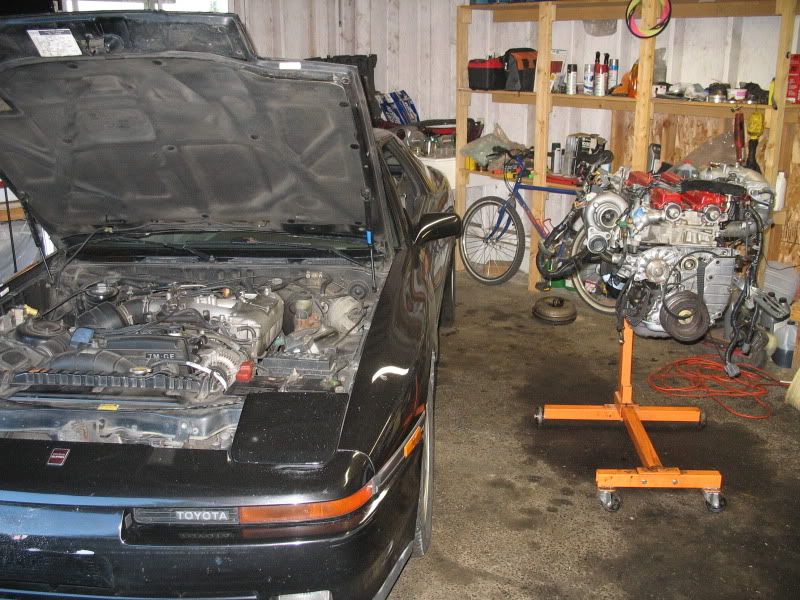

Here are some pics of the pre-install:

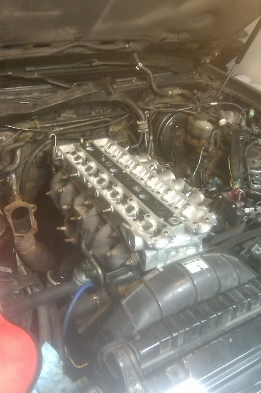

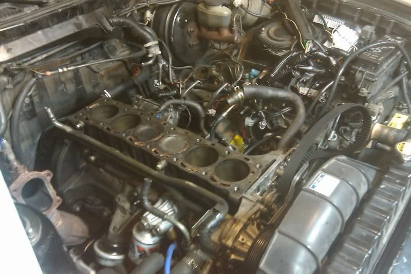

Towed it very painfully to it's new home (Townhome garage).
I'm going to do a head swap with a spare head I have. 3 angle valve job, OEM composite HG
Changes in part plans:
Die Hard Platinum Battery
[strike]Greddy Headgasket[/strike]Genuine Toyota Head Gasket
ARP Studs <-- Still debating this one. The motor already has ARP bolts. The $125 bucks for studs might be better spent elsewhere...

Update:
Car has been running with a fully refreshed head for a few weeks now. Went with ARP studs and OEM Headgasket. I figure since the transmission and clutch are going to hold ~350 rwhp max, I can get by with a composite HG. If it blows down the road I'll do it right and pull everything and do a MHG. For now, ~10 psi should be ok on the stocker.
I have a strange dead spot from ~1-10% throttle, then it kicks to life. Almost as if the TPS doesn't know i'm off idle until 10%. I can see the vacuum change so I know the throttle is opening. I'll have to investigate the tps soon.

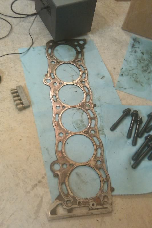

Shitty cell phone pics:
Perfectly good, unblown Greddy headgasket. I guess I'll use it as a wall ornament after I clean it up? :dunno:

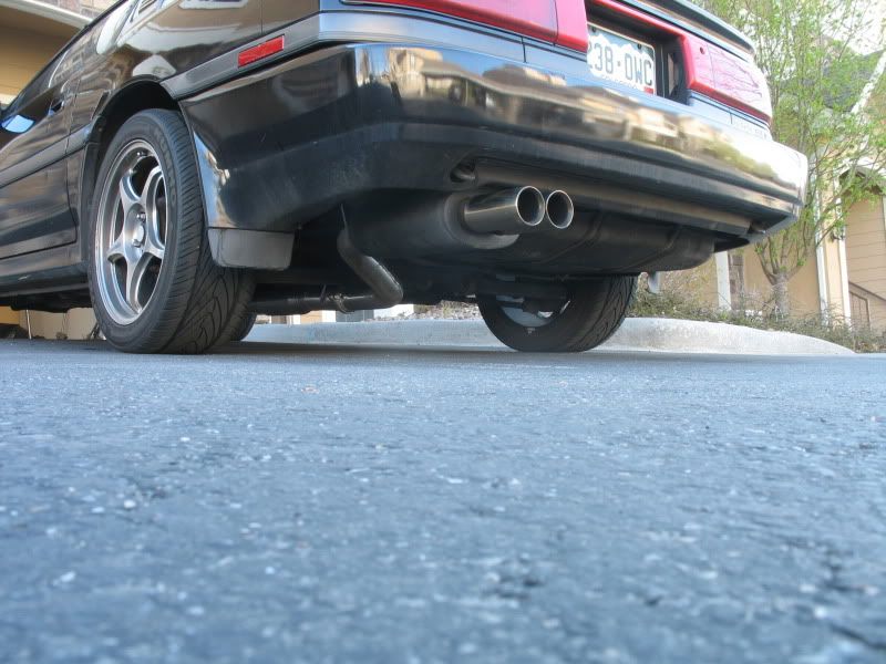

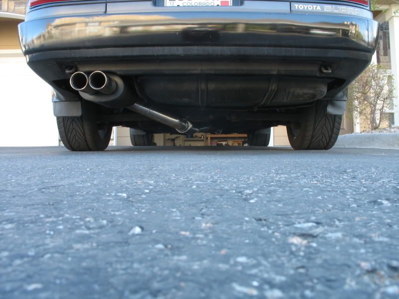

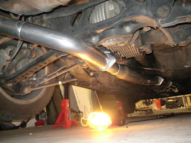

Got all the BEST Raptor Racing has to offer for the mk3.
-DDP Ceramic Coated, wideband bung, flex section, the works
-3" Hi Flow Metallic Cat
-3" Raptor Racing SS Ceramic Coated cat back piping with Powder Coated Muffler

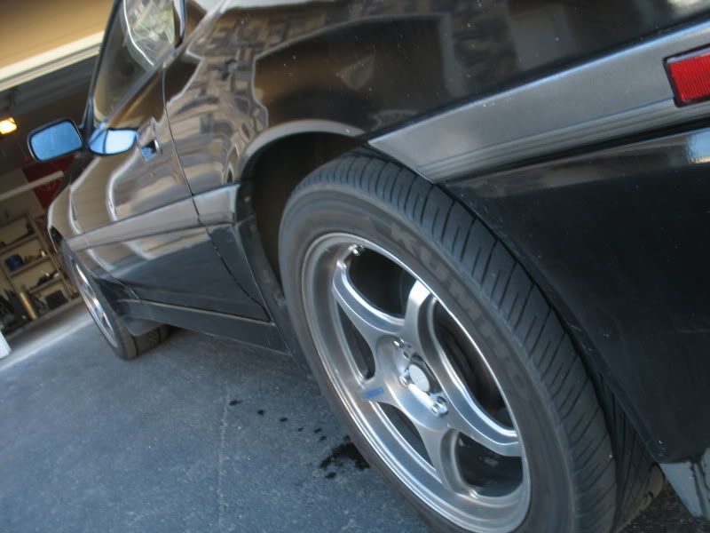

Also picked up some 5Zigen FN01R-C wheels in gun metal <-- This wasn't planned but these are some of my favorite wheels and I scored the wheels with good tires for $600 so I couldn't resist.
PLUG FOR GEORGE AT RAPTOR RACING:
Amazing communication for a one man shop. I was in the loop the whole time and George even asked that I NOT pay him until it was very close to ready. That's right, I offered to pay, he wanted me to wait. Stand up guy before, during and after the sale and I felt very confident sending him my payment for such a big purchase. As most of you better know, the quality is also top notch. Buy from him, give him your money. ;)

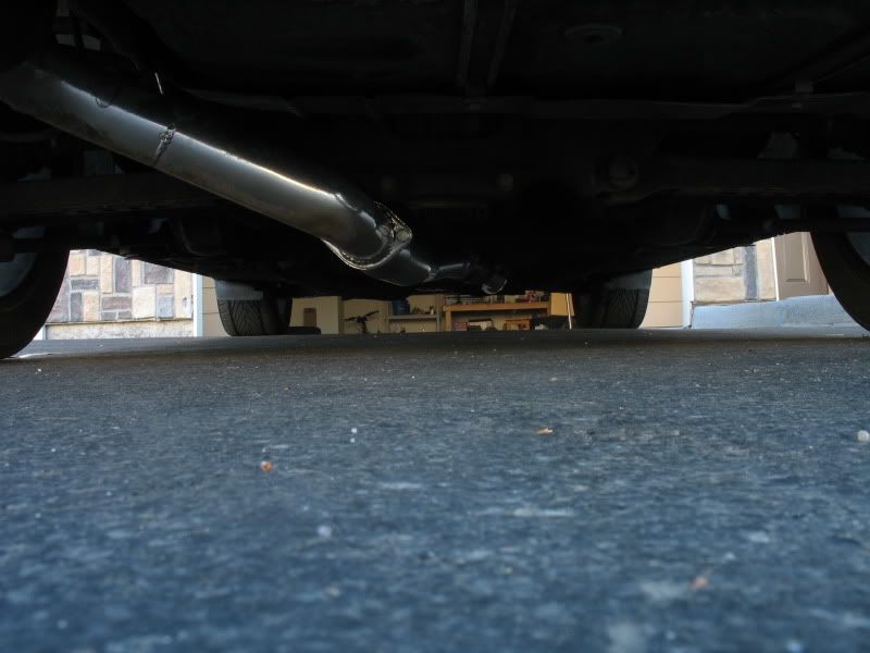

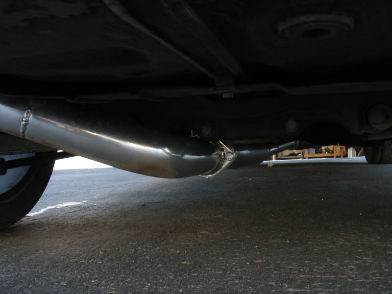

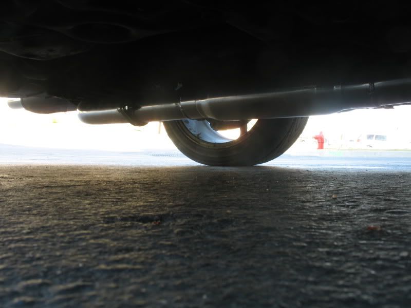

Pics:

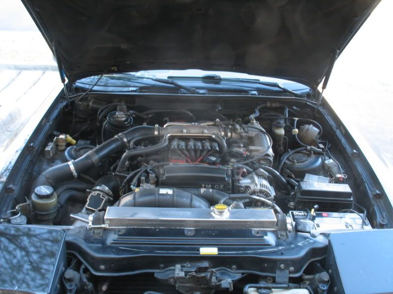

Setting up the exhaust. Man was it beautiful, haha. Since my car is a bit of a bsatard child (mk4 motor mounts, 90 NA chassis, W58, unknown year block) the cat back needed some minor adjustment.

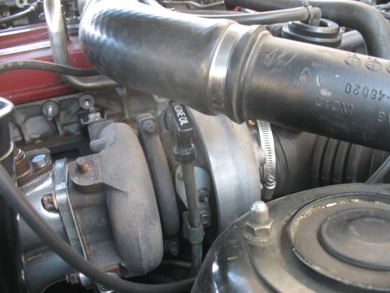

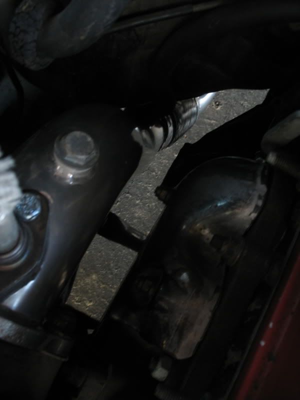

Quick glimpse of the downpipe and the very convenient location of my dip stick. :(
Looking down the DDP:

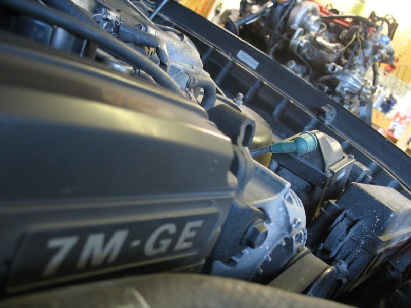

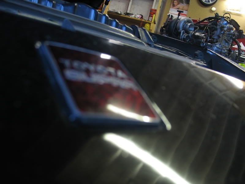

Dirty engine bay:

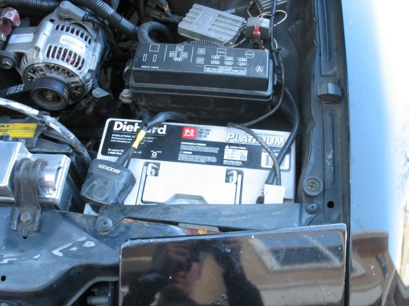

Bad ass, highly over capable, largest size Die Hard Platinum Sears had:
Messy interior:
Lotek Pillar pods look great..... if you squint:

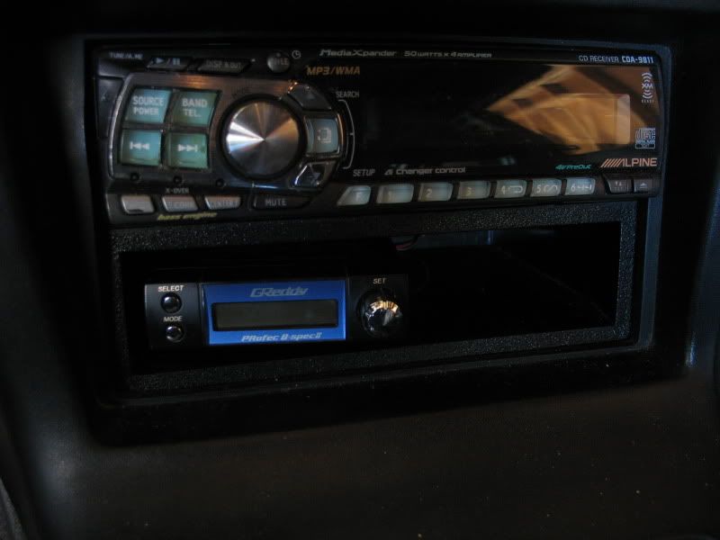

Boost controller install:
