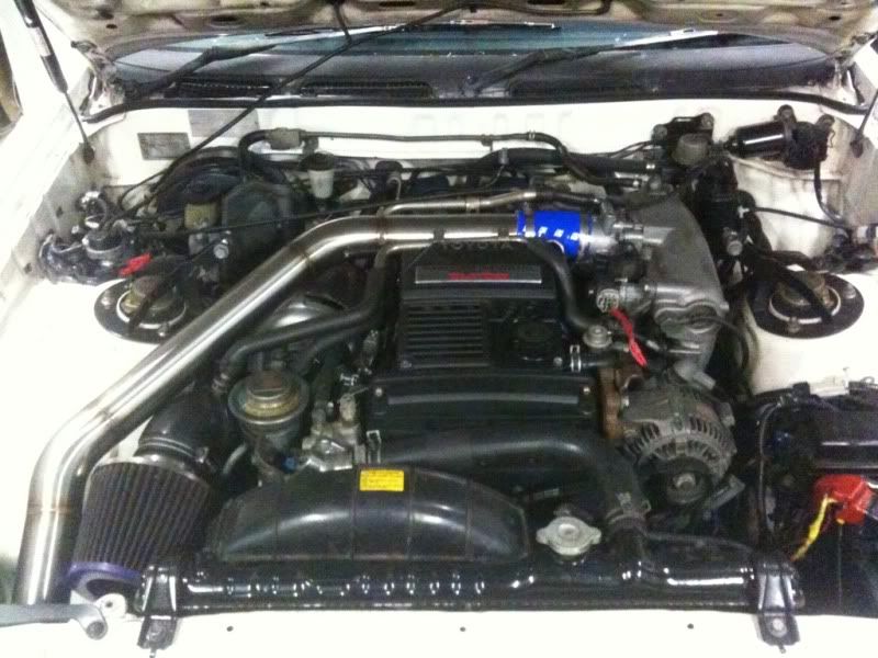

my current setup

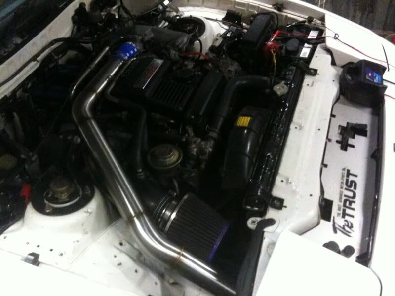

X2324654, If he would have read any of these posts in this thread, there would be no questions asked... Btw im Going to be back up and running with the comp housing sealed new charge pipes, and running map ecu by early may. Going to be shooting for 15-20 psi..:)

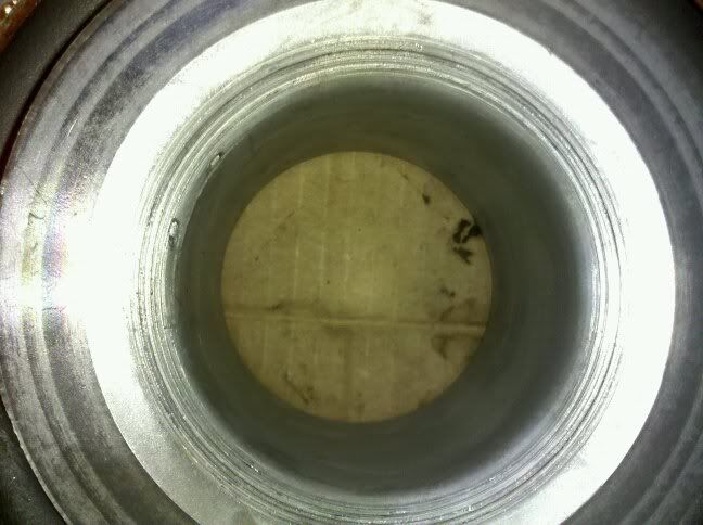

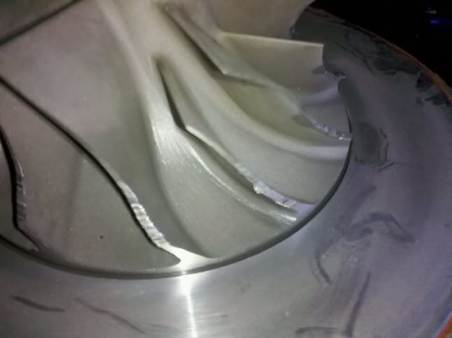

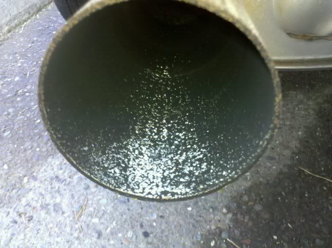

i made the huge mistake of buying this turbo and it seized up by grinding it self into the compressor housing after 800 miles... 500 miles of 4 psi break in, 285 miles of 12 psi, and 15 miles of seeing 16psi MAX on the night it died on a BRAND new engine of the same mileage. (i got it because i needed a turbo that could pass smog and look stock) ill put up pics if anyone wants. the funny thing is it looks like the wheel ground down more than the aluminum! haha what does that say about what the wheel is made of...
be careful every one...
if i didnt have to pass smog id be kicking my self in the ass for not just going with an holset hx35 if i wanna be cheap...

definitely not user error. how much boost is everyone here running with these turbos? from what iv read in this thread like 5-10psi... try running 24psi for a few pulls like they say its rated for and tell me how it goes.

well like i said. good luck and be careful... i must have been in the 25-50% of unlucky ones that got a piece of shit. you know not every one that gets this turbo reports back to this thread or any forum for that matter when theirs fails... (i would suggest running an in-line after-turbo air filter if your running these turbos lol)

Well Got the engine/trans back in last night, comp housing is sealed, all pipes sealed. another week or two and I'll See what this turbo can really do. And really people, Read the whole thread before you post useless nonsense. Kthxbye
