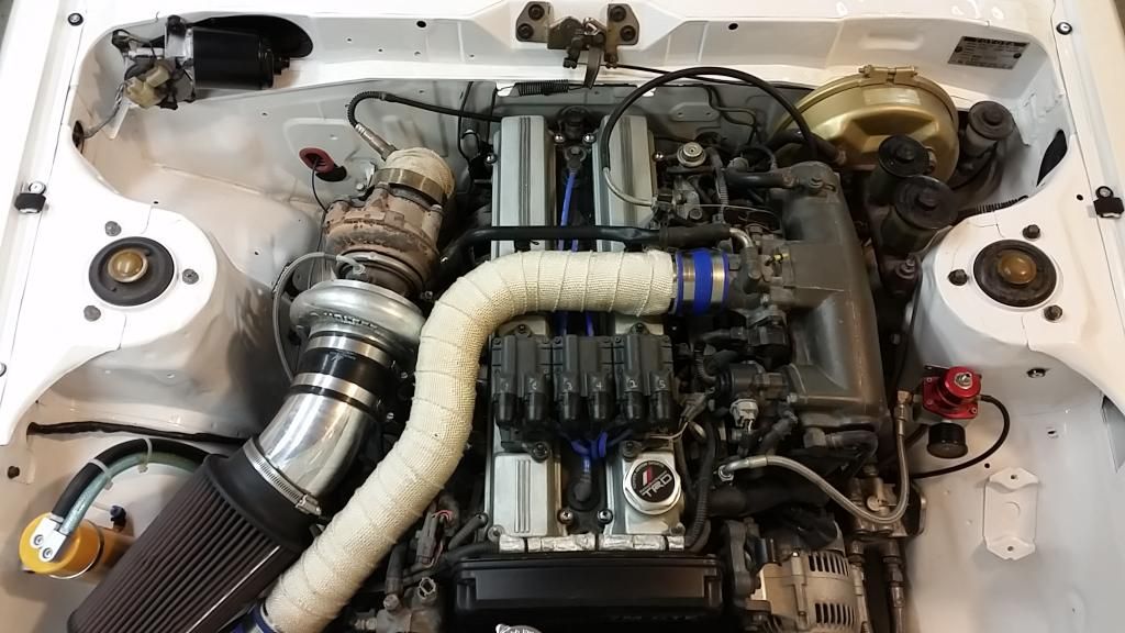

Wouldn't consider it "elite", but I think it's somewhat clean. This is just my temporary setup, will do a FFIM and aftermarket intercooler + piping down the road, along with a catch can. It made 440whp @ 15psi with a conservative tune.
For those interested in my setup, it's pretty basic:
- Stock 7M bottom end with 150k miles
- Rebuilt head: Comp BBC Valve Springs, Stock Cams, 3 angle valve job
- HKS Bead 1.2mm Head Gasket
- ARP Head Studs w/custom washers
- SP Bolt-On Precision 6262 CEA Turbo
- ECUMaster EMU Tuned by Larry @ SP
- Stock Coils, w/no igniter. Coils are driven directly by the EMU
- Stock Intake + Exhaust Manifolds
- Stock Intercooler + Piping(big restriction!)
- 4" Turbo-Back exhaust
- 1200cc Precision Injectors wired sequentially
- Walbro 400 Fuel Pump w/-6 lines + Magnafuel E85 filter
- Stock R154 w/Clutchmasters FX400 Street Clutch
Let me know what you guys think!

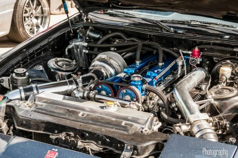

1jzgte Compleet rebuild!
Upgraded 1JZ twins(from Albert)
Inconel shaft & Genuine GT2860RS 62trim compressor wheels
Standard 39mm in / out NOW Garrett 47.2mm in 58mm / 60 from
Steel OE replacement turbine shaft ( Higher durablility / reliabliltiy )
Fully Rebuilt and Balanced ( New Bearings , New Thrust, New front / rear seals. Gaskets , O- rings)
Bored 34mm wastegate open to 20% more
New 304l High temp alloy flapper created and re -install
Polished housings and black ceramic coating
ported manifolds
New type turbo inlet pipes
New type valve
CUSTOM CNC dreaded polished valve covers
Clear timing belt cover
Marlin Crowler race nokkenassen.264
Marlin Crowler adjustable camshaft pulley 's
Marlin Crowel hardened high flow intake
Upgraded 200 amp alternator
Light weight pulley
JUNE lightweight flywheel
XTD flywheel / clutch plate clutch
Bigger intercooler
Mocal oil cooler 13 row
Mocal power steering oil cooler 19 row
Koyo radiator
TRD oil cap
TRD olifilter
TRD thermostat
Blitz acces ECU
Sard 550CC injectors
NGK Platinum Spark Plug 7092 ( BKR6EGP )
FOX stainless steel 3 inch y -pipe / down pipe / dual exhaust
K & N Air Filter
Magnetic oil drain plug

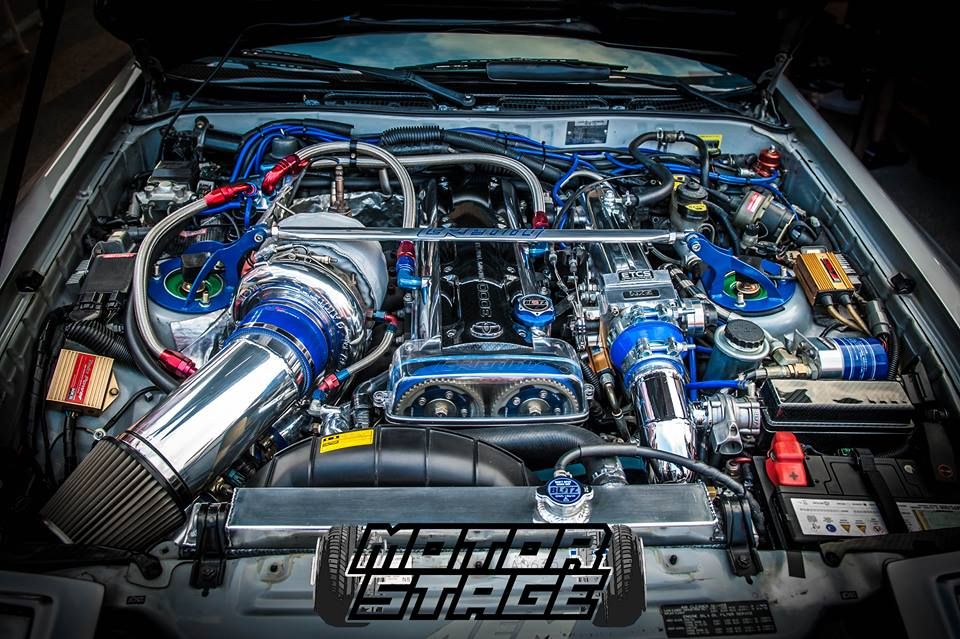

As it is right now... picture is from an auto net mag called "Motor Stage" and attends JAP style meetings. This is my engine bay!
