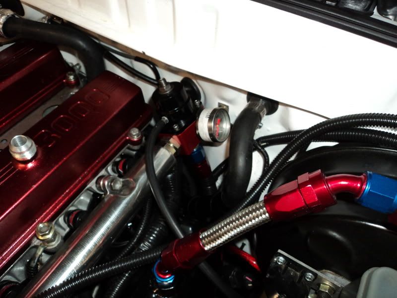

LMAO. Bug me? HAHAHA not at all. I am simply saying it isn't needed. You can use the excuse about the regulator but the stocker would suffice for that. Does it bother me? No it's your car. I just want to make sure others don't think it's needed.
Cleaner look? Not at all. The rail extends so much that the line off the valve cover has to go over it. It is your car, so have fun with it.

as for the reg that is the main reason i have it because over time the stock one would crack form weight the lipp rail is about the same legth as the stock one just fatter
reason for the line going over is my intake manifold is not just set of lower runner glued on a plenton
so the way i have my runner's there no room there MR dunae

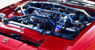

hey, sorry. I only have this one that I can think of. I need to get the car out and take some more. Just got a new lens for my camera too. And Nash, I love this manifold - even though it flows a bit more than stock, I love how i can keep the battery and everyhting. It's really a nice piece with great welds.

Is your PCV vavle just runnning into a oil catch can?

the main reson why i have a lipp fuel rail is my fuel reg threads into my fuel rail with bulk head fitting. If i was to do this with stock one i have good chance of it cracking the cast rail over time and if i was to run -8 fitting to match the fuel rail it simply would not fitand look goofy
i just really never liked the branched out fule regs that see on most cars

It's great that you want to choose the rail for your regulator since the reg screws within it, BUT, the stock will not crack due to weight Ryan.
As far as the -8 line, it does fit, as it's what I have and is more than enough for 99 percent of the people on this board. A simply drill and tap and it's done.

Not to mention that the regulator weighs pretty much nothing.
Back when I still had the shop, we sold the 7M rail as a "cosmetic" upgrade. The stock rail flows over 650rwhp easily. Not too may 7M's making over that.
I had one, it looks good. ;)
